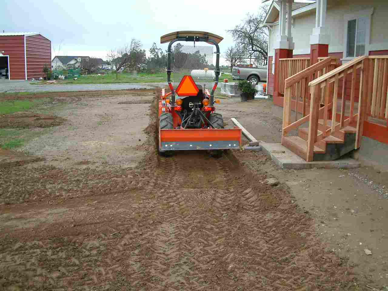

I bought a B7510HST/LA302 FEL last May for $12,600 plus tax. Came with ag tires, 3-year warranty, 10% down/0% financing for 36 months. Added a King Kutter 4'ft box blade later ($375 at Tractor Supply Co.).
It's a solid little tractor. I've used the heck out of the FEL toting gravel, sand, drain rock, building materials, etc. Got a $175 toothbar for the FEL from Markham Welding to help when digging.
Used the box blade and FEL to dig trenches for paver block walkways in the front and back of my new house (4' wide x 70 ft long, each). See attachment.
Also bought a 4-ft King Kutter rotary mower (aka bush hog, brush hog, shredder) for $675 at TSC. I have 10 acres total of which about 7 acres are weeds that get mowed with the hog.
The other 3 acres include landscaped areas, a small almond orchards, the house, garage/shop and several small sheds. Use a cheapie 42"/18hp Huskee riding mower from TSC ($1000 + $180 for 3-year service contract) to handle the lawn mowing chores.
Also have a KK middle buster plow/sub soiler ($135 at TSC) for cutting trenches for landscape irrigation pipe and drains.
I assume you'll be getting a set of similar attachments real quick. Tractor's not much good without implements.
