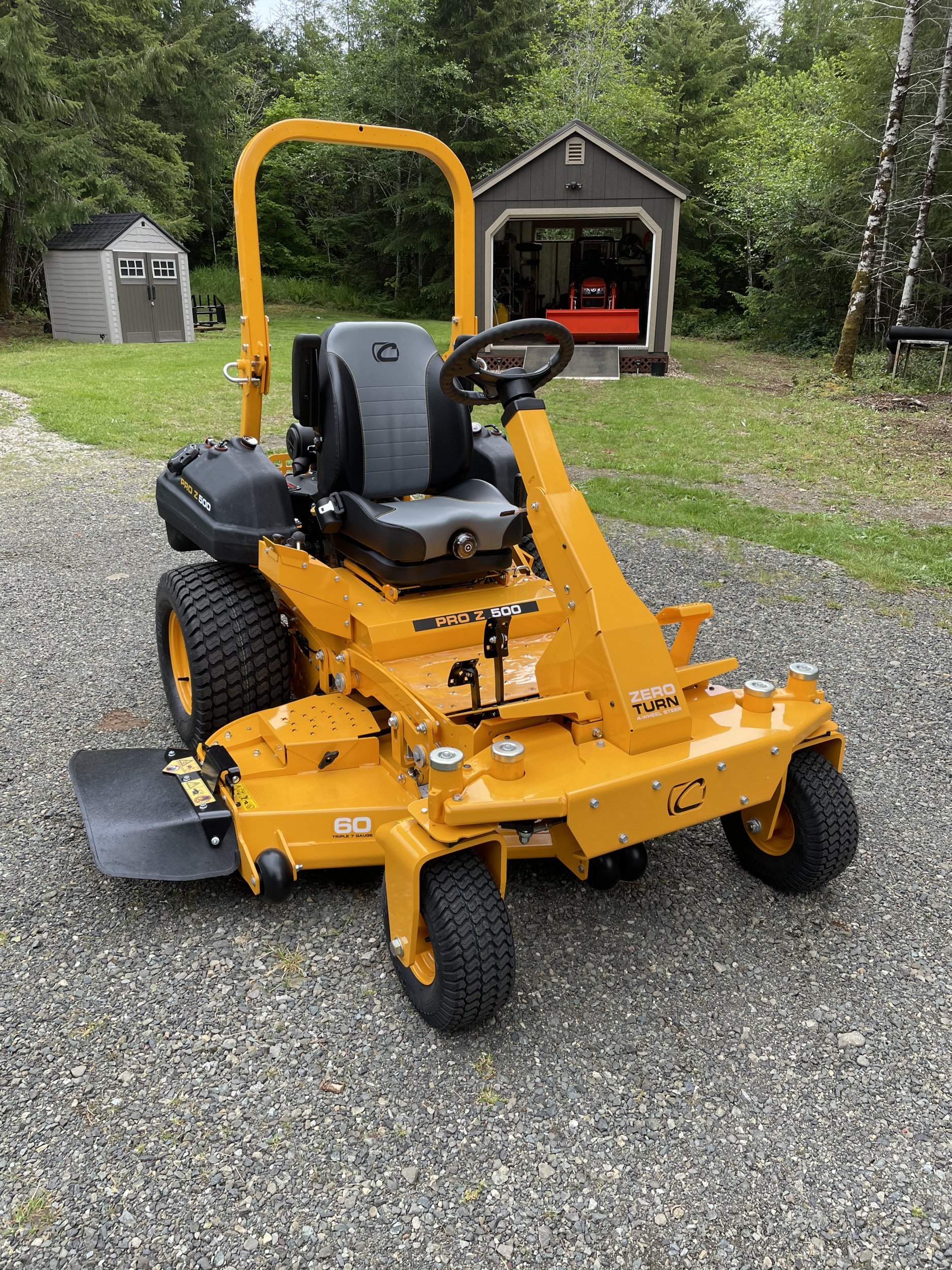

It’s a budget killer but, here’s a ZTR for hills;
It’s a Cub Cadet Pro Z 560 s KW and runs around $12K. It’s built like a tank and mows hills quickly and safely.
Mike
Your post got me looking into slope mowers. By no means exhaustive or definitive, but it looks to me like the options are Steiners, Powertracs, Ventracs, Kut-Kwicks, Harper Turf, and maybe a few others, Price wise, the Cub Cadet offerings look to me to be about 1/2 of the cost of the other options if all someone is doing is cutting lawn height grass on a slope up to 20 degrees.
I wish I could figure out a way to convert one of the Cub Cadet steering zero turn models into a rough cut mower to cut some hillside briar patches.
edit: local dealer had a demo pro 900 in stock for under $13k. He said it wouldn't be good for briar patches, and given the ground clearance for the mowing deck, I agree. I didn't see an easy, effective way of modifying it, either.
He said the larger model that handles up to 40 degree slopes sells as fast as they can get them in, but they can't get enough of them to meet demand.
