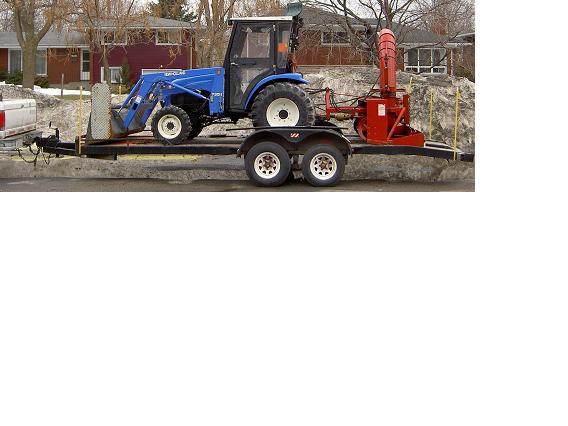

I've got aTC33D with a loader and either a rotadairon or inverse snowblower on the back. Both are long implements. I've also got a 20' dovetail trailer and the tractor easily fills it with only a few inches left over. It has 4' ramps. Originally the dovetail was too low to the ground and it bottomed out everywhere. I flipped the axles to the bottom of the springs and the problem was solved. I should have it loaded up in the next day or two so I'll take a pic. Go big.

Congrats. That should be big enough.
Here's mine.
