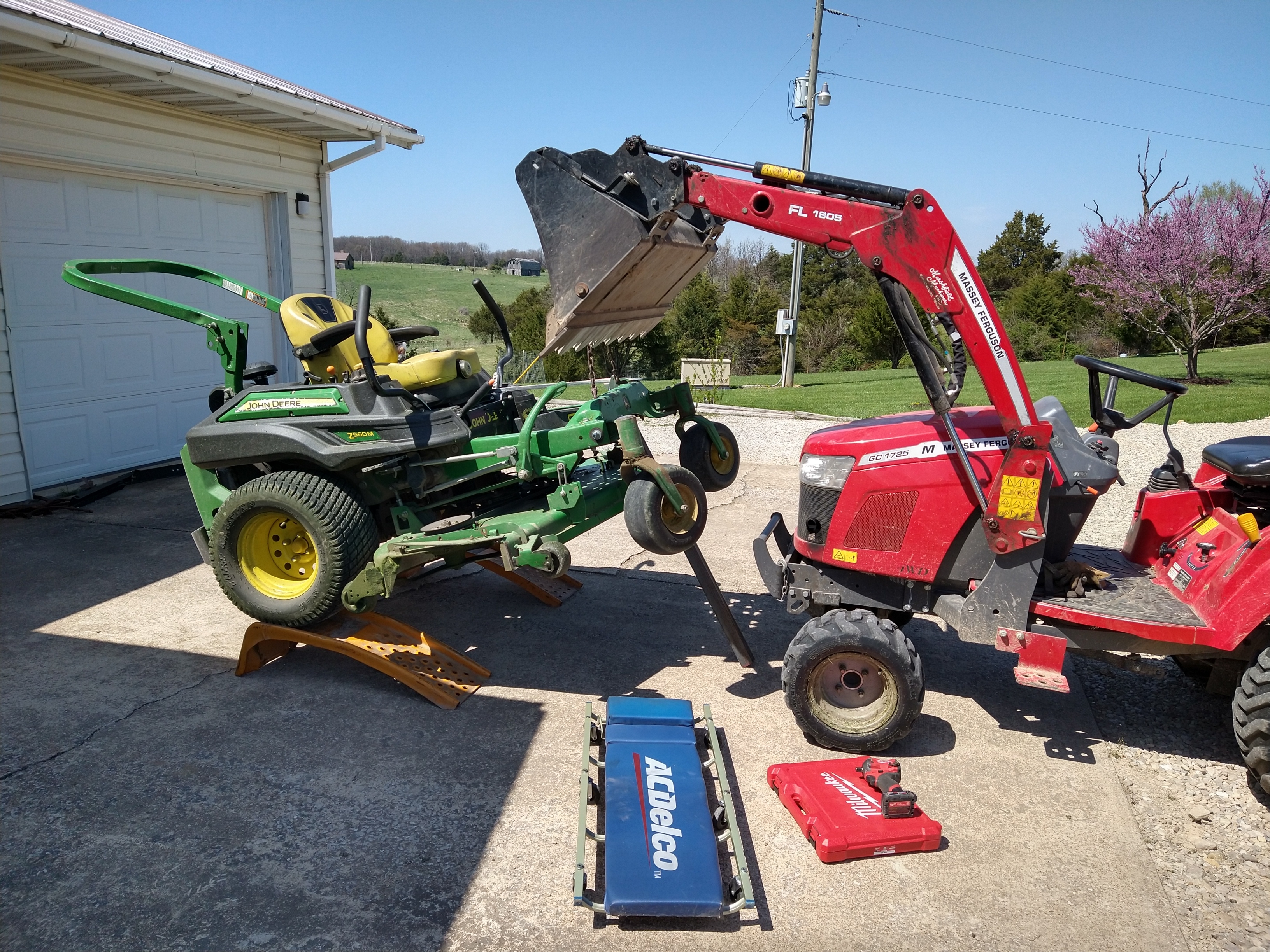

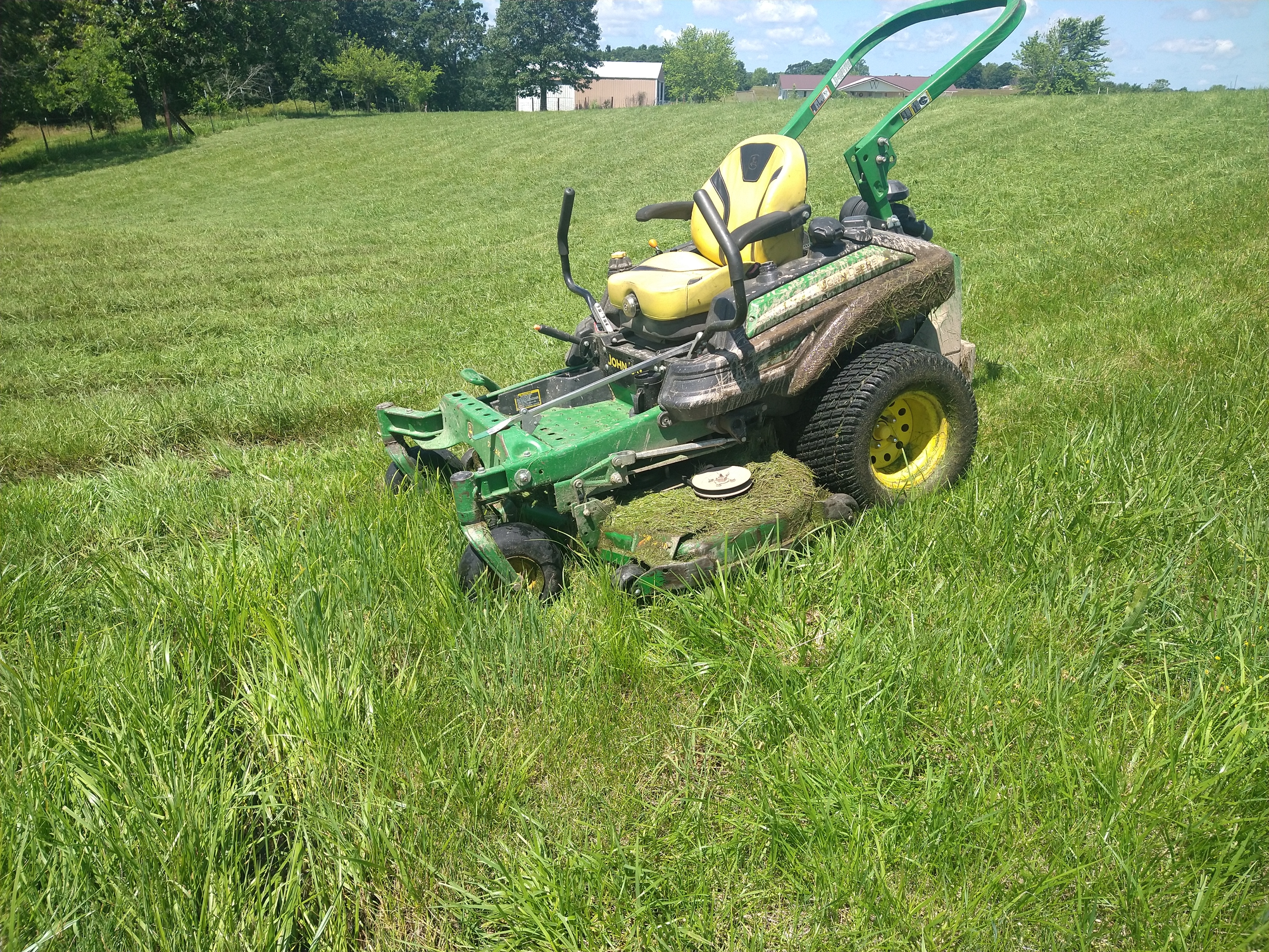

Like the two posts following yours ... Apparently you are not familiar with the 7 Iron decks that John Deere puts on there commercial Z-turns ... Yes, there are more expensive Z-turns than my Z960M, 1,400 Lb - $17,000 one, but calling it a "lighter, lesser machines" is quite a stretch!
As far as I know John Deere is the only one who invested stamping equipment to press the one piece decks ...
I've accidentally snagged and BENT T-Posts with my "wimpy" deck! ;)
