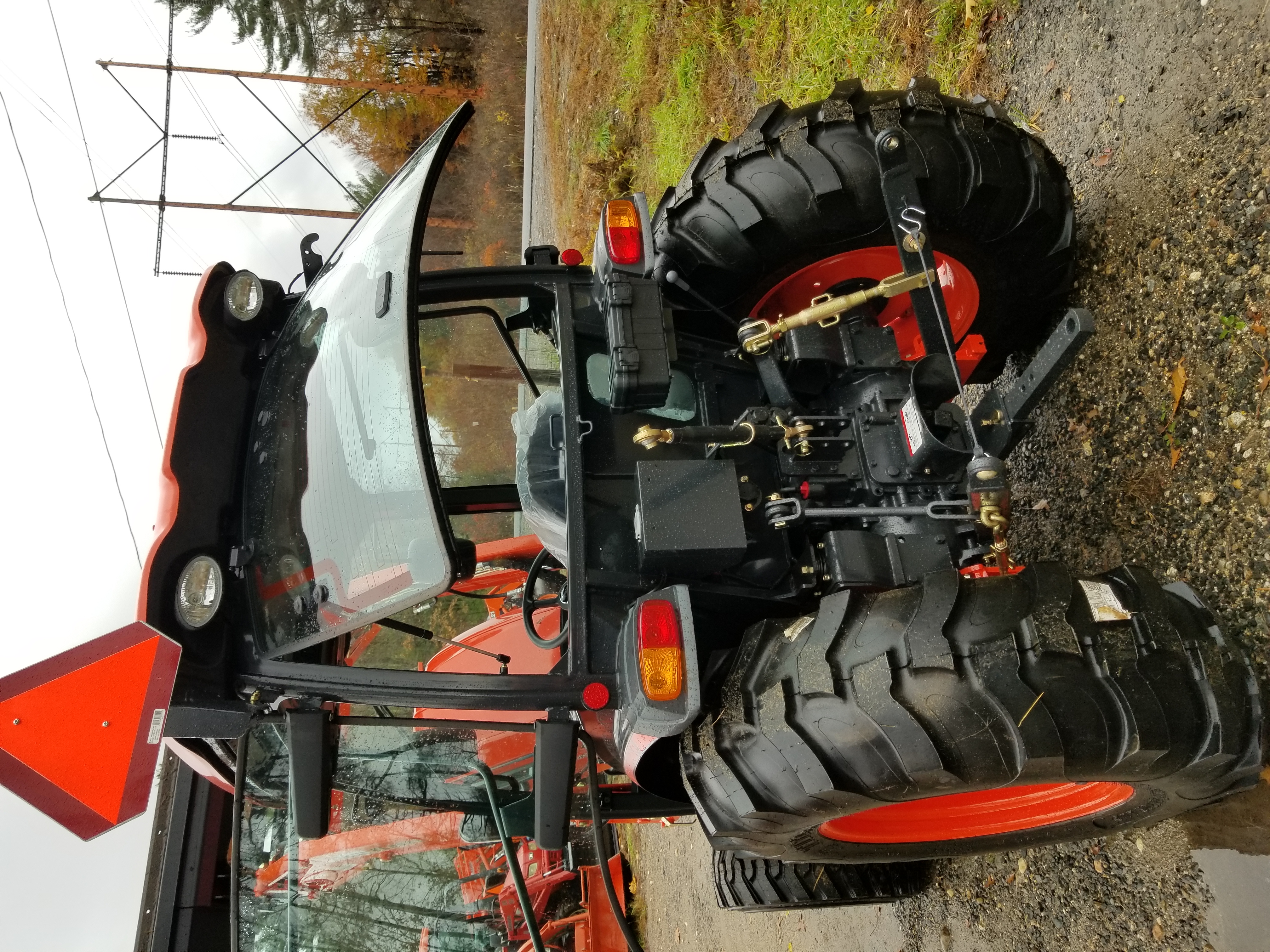

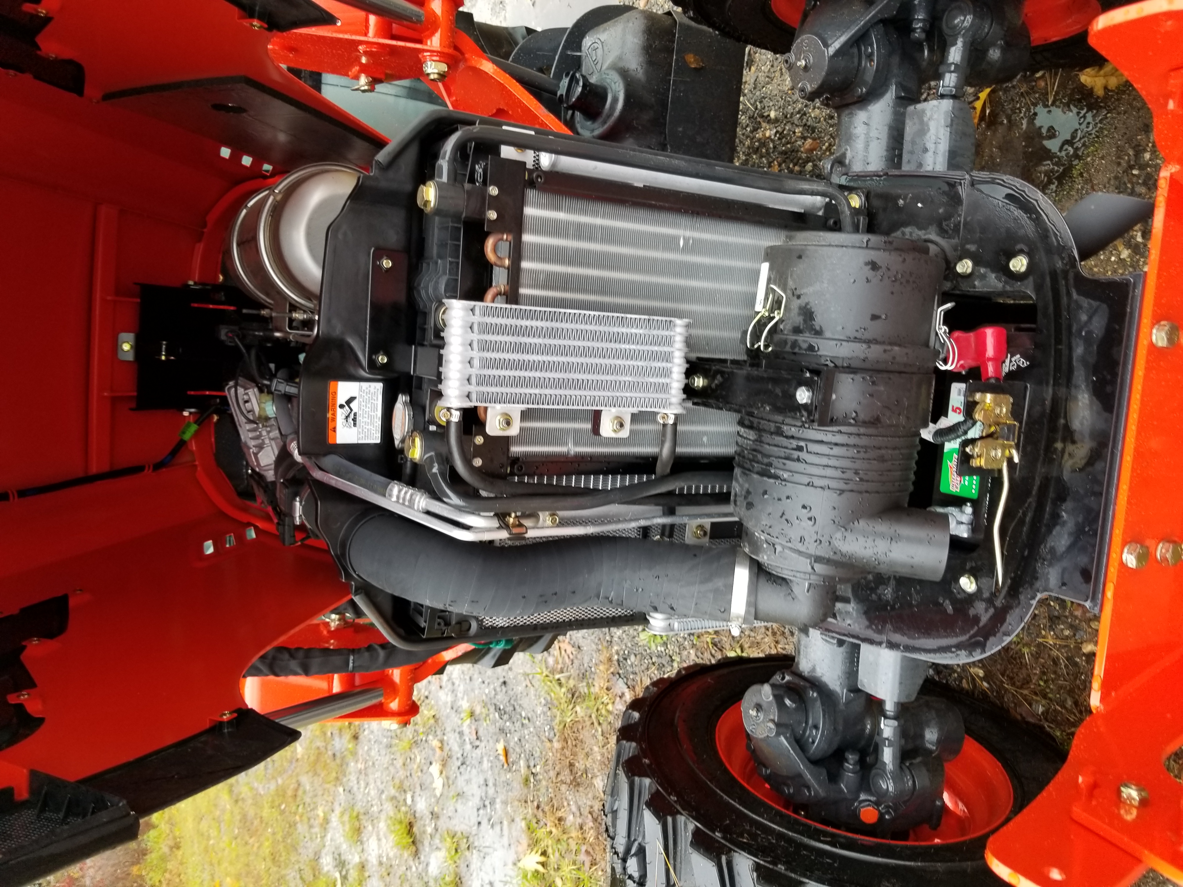

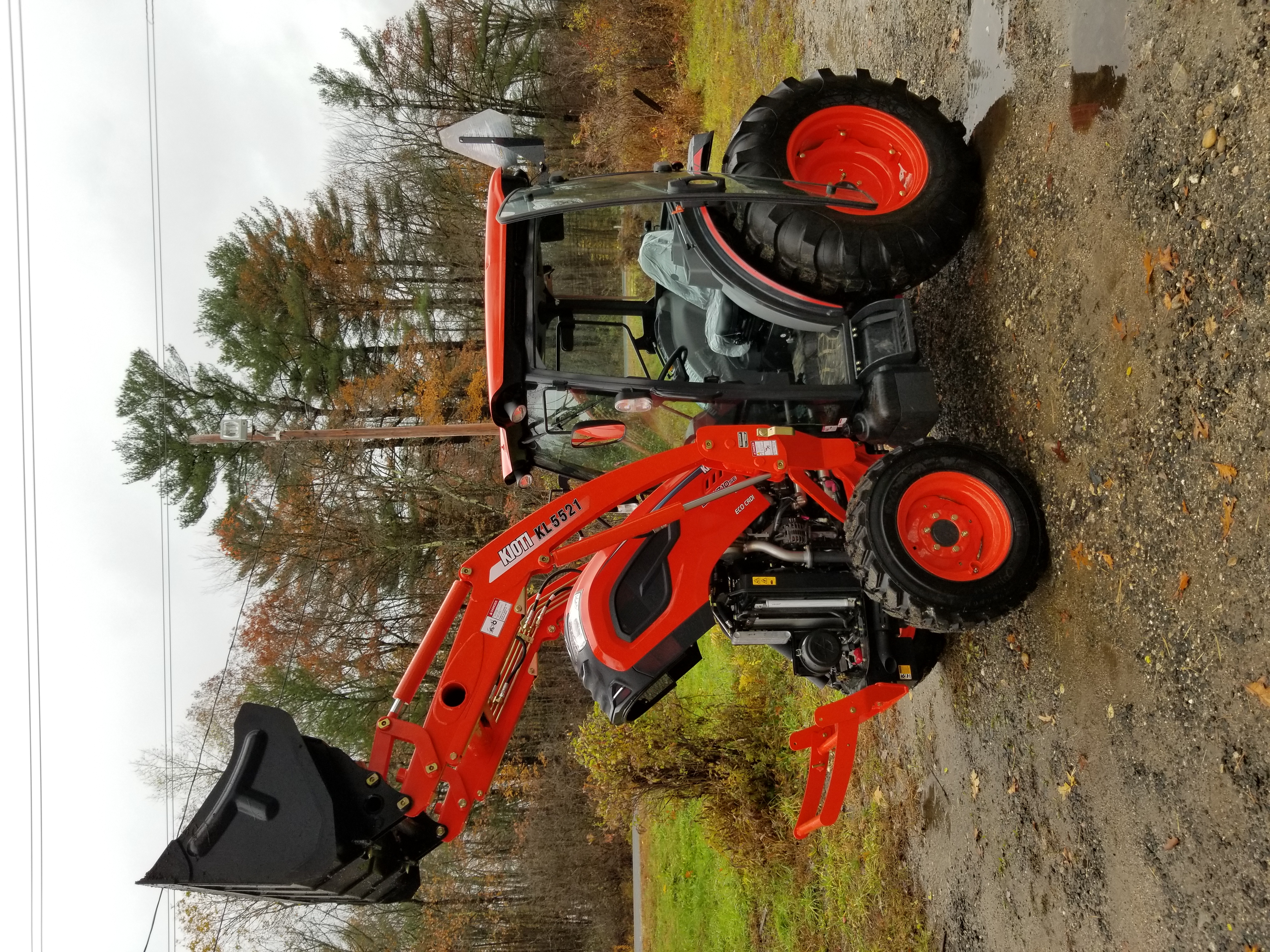

I've got a 2008 Kubota B3030 open station with loader and 72" deck that had served me well since I bought it used in 2013. I'm also considering a similar move from the B3030 to a Kioti Cab CK3510se or DK4210se. There's a good Kioti dealer about an hour from me that I visited this past weekend. I have to say that I was very impressed with both the CK and DK. The cabs were very nice with fit and finish you would expect. Very low noise and the A/C worked well. It was about 50F and I could make it uncomfortably hot and cold. Their CK was sold so I couldn't drive it, but I started it up to get a sense for noise and FEL performance. I played with their DK4710se and it was impressive. Had nice power and easy to drive. Going to look at a Kubota L4060 soon to see if it's worth the extra $7k. Here's some pics of the DK. Sorry doing this on my phone and it looks like the pics didn't rotate correctly. My primary motivation aside from the cab is more lifting capacity on the FEL. I just need more than the B3030 has to give.
