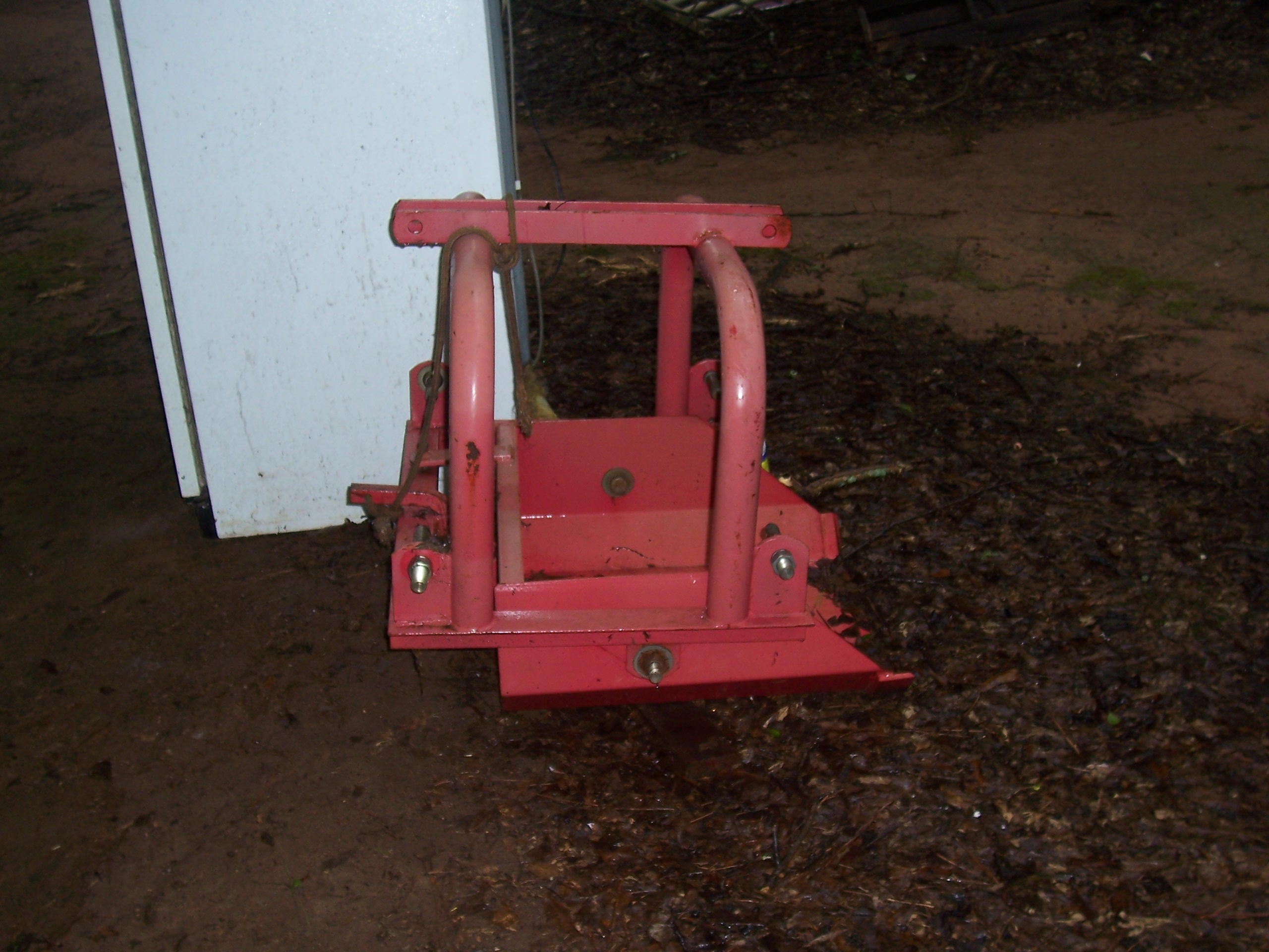

Another thing I forgot to add is that on the 2000 I use a rear scoop. And it works like a champ and Cheap!!! I purchased it new for 150.00$ I believe. It also works great for loading and just carry things. It's my Wheel barrow so to speak. I use it on our 11 acres which is 3/4 wooded. And is very easy to maneuver around than a Fel. sticking out the front!!!! I highly doubt it will ever get one. For the cost of a rental bobcat I would go that way if it can't handle the job at task. The JD. has never hit this property in over 10yrs. and only 4 miles away... Been a while on here and I have a pic. of the rear scoop but it's not on the Tractor I can get one if needed. Here's one of it so you can see the size. It doesn't stick out the rear much at all...

I'd love to get a loader, but at the moment I can't swing it, but I'm looking into the rear scoop. That looks like a very handy implement.
I know something about scoops vs loaders because back in the 1970s when I bought a used Yanmar with a loader my good buddy bought a nice nearly new IH with a scoop.
We did a lot of the same work and spent a lot of happy days comparing our tractors. Both of us could see the advantage in the other's choice. He got no loader, but with the same money he got enough tractor that it would plow and hay 40 acres of sticky soil - which the lighter Yanmar simply didn't have the power or weight to do.
On the other hand, the scoop is a great wheelbarrow, but it isn't a crane or a bulldozer like a front loader is. He had to wrestly every bale. A scoop can't lift things into the air - which means you can't stack much or load/unload a truck. Not even a pickup truck. Or pick up an old engine block with a chain. A scoop doesn't need chain hooks. But it needs an active owner with a strong back.
And although the scoop will move a surprising amount of dirt from one place to another and even dig a few inches, but it won't push dirt around into new shaped and compacted landscaping like a loader will. Landscapers use loaders, not scoops. And scoops don't do much at all to snow or mud except to drive around in it real well.
Good 3pt scoops are reversible like the one in the photo posted. And VERY heavily built. The best I saw was probably made by Massey. It had that signature round tubular frame and was reversible. Good ones are hard to find but are rarely expensive. If you find one, grab it. They tend to go for less than the cost of the steel they are made from. A scoop is pure magic to the guy without a loader, and handy even if you do have a front loader.
And BTW, that's exactly the problem with the 3pt scoop....that they are just good enough that they will keep a guy from buying a front loader. And the loader can do so much more.
