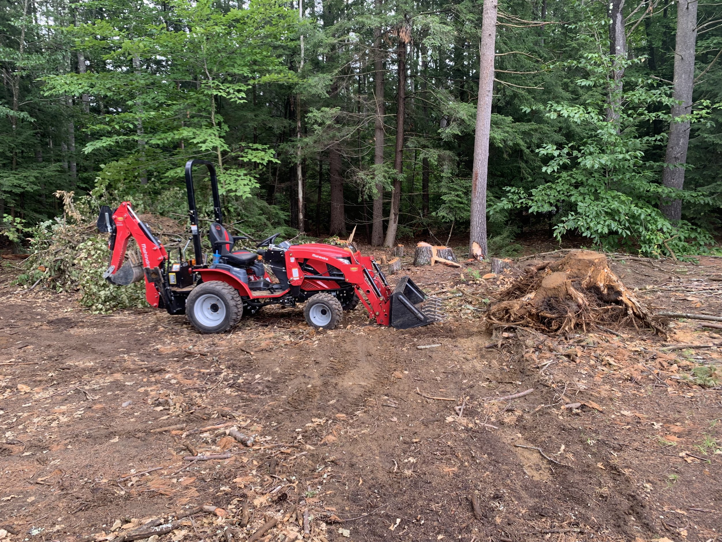

I always thought the BH for a 50hp tractor was too small anyway. Just my opinion. no experience with one. My main use would be to dig out stumps.
I just dug out this big double black cherry stump with my 22hp tractor/backhoe. I’ve dug up some big pine stumps with ease. This was the first hardwood stump I’ve dug, and the first stump I’ve really had to work for. It took about 2 hours to dig out all around it. I would think a 50hp tractor with a backhoe could make short work of most stumps?
