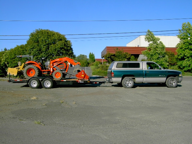

   / buying ck25 or ck30 #15
I haul CK30 on 16' 7000 lb. pulled with my '95 Dodge 1500 5.9 w/auto trans short bed w/ factory heavy duty tow package. I don't have any problems doing freeway speed or pulling long hills although I do see a new diesel in my future (the wife doesn't know yet!). Attached is a pix of the CK w/ box scraper and the flail mower on the trailer.(I don't have a load equalizer hitch)
How are you chained to the front there DH? That's a good load for the trailer and a big weight on that truck without a WD hitch. I think you will be very happy once you try the fancy hitch. You realize that the tractor and those implements combined likely weigh more than your pickup, right? I sure wish I had a flail mower for those mowing jobs near houses and roads. The brush hog is pretty dangerous.
Chained? The front of the tractor to the trailer? My trailer has 4 heavy duty "D" rings, one on each corner factory installed. As far as weight, well I went to the local rock quarry one day and weighed truck, trailer and tractor with just the mower..........ummmmmm should've taken my lunch box out!
   / buying ck25 or ck30 #20
I wasn't very clear, I meant how do you attach your tie down chains to the nose of the tractor? I run through the front box of the frame but there are these two big holes on the frame siderails just begging for some sort of tractor mounted d-ring and I thought maybe you had that.
