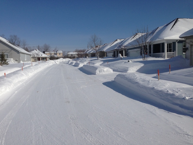

I posted what one of my other properties looked like last winter, this place is a bit more open than the new accounts I'm putting the tractor. We did this with toro groundmaster type machines with 60" blowers. The tractor could eventually be relocated to properties just like this as I service several communities and am expanding the snow removal end every year. Thanks for taking the time to read this and look forward to your responses.

Can you run chains? If not, you want WEIGHT from my experience. The NXs are very good tractors in general IMO.
Edit: a small articulated loader might be a more nimble option...
/ Buying first tractor need some advice
We cannot run chains. I also want to run a back blade on the 3pt so I'm not sure the loader would work. I do have a Kawasaki 60z loader already, 130hp, but that would only get brought out if we had to push back big piles or the "you know what" just hit the fan.

Just as a point of reference - I have a Kubota M6040 and would have no difficulties manuevering around in the areas shown in your photo. I use a rear blade exclusively. A word of caution - a snow blower, whether front mount or 3-point will throw hidden objects a long distance. Your photo shows a LOT of glass.

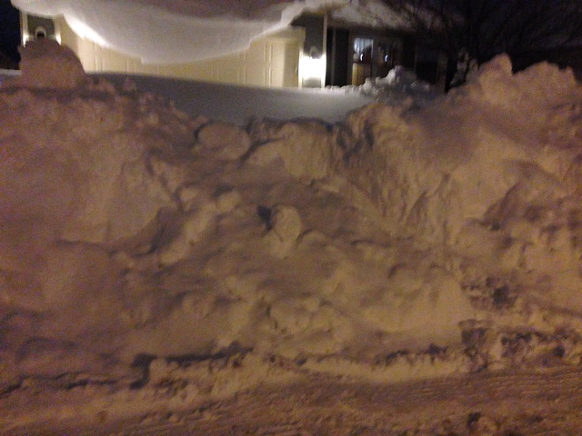

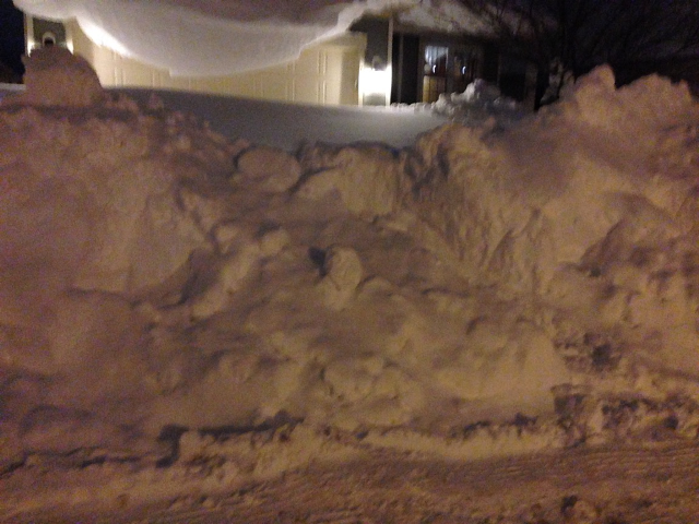

Here is the mess we had to deal with two winters ago. This came down over night.
I've decided to go with the larger tractor, I'm actually thinking the nx5510 or nx6010 with 72" blower. I'm going to the dealer tomorrow. they have a 5510 there. Just debating on going for the 6010 once it comes down to signing on the dotted line. It's another 40/month for 5 hp. It's only money, right?
Watching videos from other companies I see some guys are using monster tractors. Makes the NX models look like a toy, so I don't feel this tractor will exactly be too big anymore but i think it will be just right and I doubt I'll regret the extra power if we get a bad storm.
The only reason I fear getting an inverted is due to storms like this. You need a payloader or a front mount blower when you have 6-10 ft of snow staring you in the face.

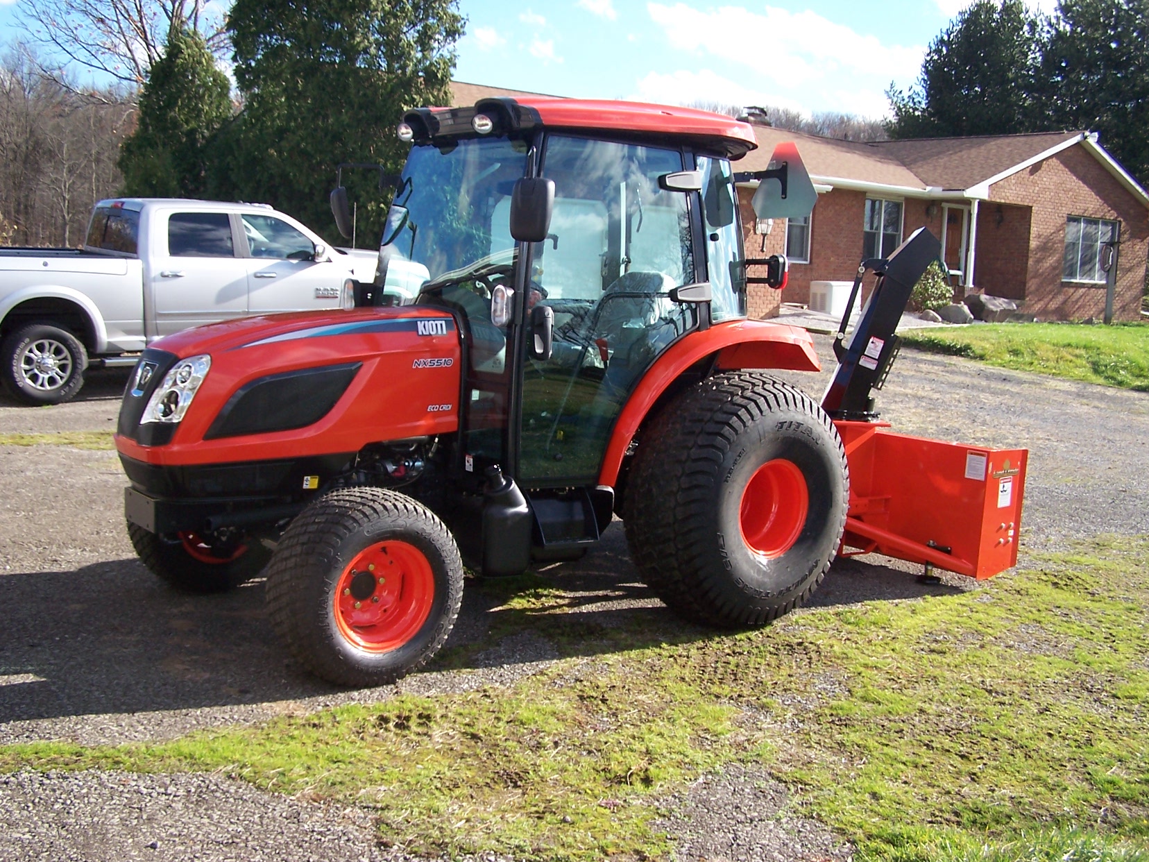

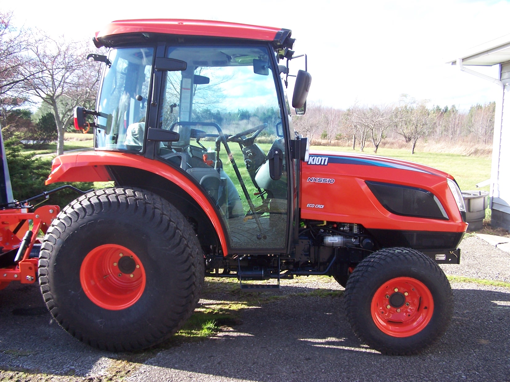

I found these pics from another forum member here, hope he doesn't mind me using them. I'm looking at the same tractor with these tires. How do you all think these will be on pavement for snow removal vs AG tires. These are what I want so I'm hoping they would work well...
