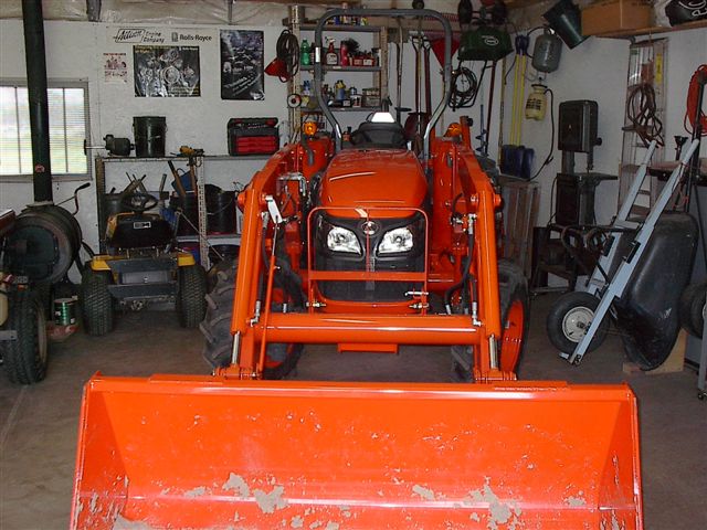

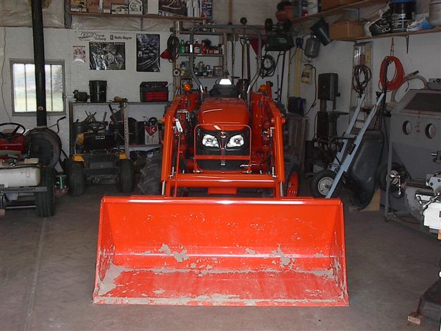

Does anyone know if the MX5100 loader can handle a bigger bucket as they one i sawtoday looked rather small to what i though i saw last time i looked.? Any comments wiil be very helpful..
   / BUYING KUBOTA BH 92 Vs HIRING/BUYING mini EXCAVATOR #13
This is my mx5100 don,t know bucket size but maybe bigger than what you have seen and will answer your question.

Thanks for showing your pics, yours looks bigger than i saw at showroom today. im getting a 4 in i FEL but i was sure its was larger...must be some slight of hand trick .maybe...are they any standard specs on a kubota tractor or is that flexible? I can read them on our australian website...seems its now under construction ...
