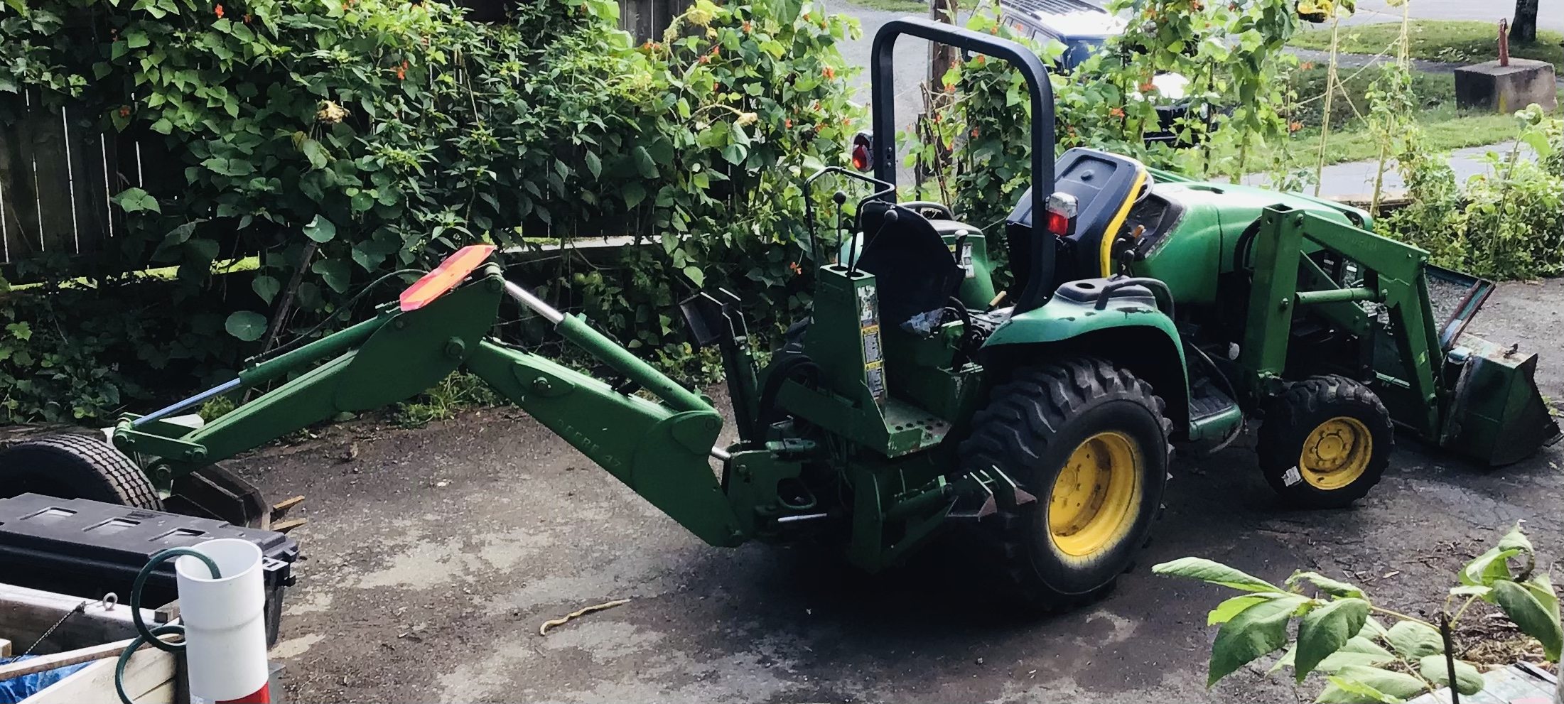

For one home a year the 25HP tractor with frame mounted backhoe and mower will work. Your biggest concern would be rock and lift height if material must be hauled away. You will also have to move material around on site for which it would work well. It would be very suitable for landscaping. Trench work can be done also. It’s best if trench depth be about dipper depth for ease of operation.
A tractor similar to a JD 4200 would be ideal.
