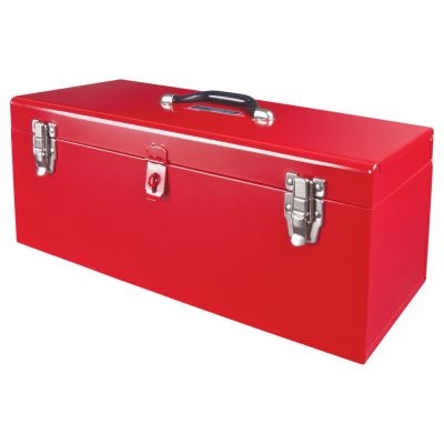

Sounds like you have good idea of what's needed.... I have a "on the road" tool box (left over from autocross race days) ..
Contains:
Metric/SAE socket set
Metric /SAE combination end wrench set
Assorted screwdrivers
Assorted pliers
"Crescent" wrench or two...
Hammer
Hand full of ZIP ties
Small roll of mechanics wire
Hack saw.
Roll of electrical tape
Assorted hand full of odds and ends...
And all in this size tool box...
WESTWARD-Tool-Box-20-in-Overall-Wd-36Y008
Jug of motor oil and hydraulic fluid if tractor is HST, of course a funnel.... Jug of diesel fuel.... Grease gun-YES
