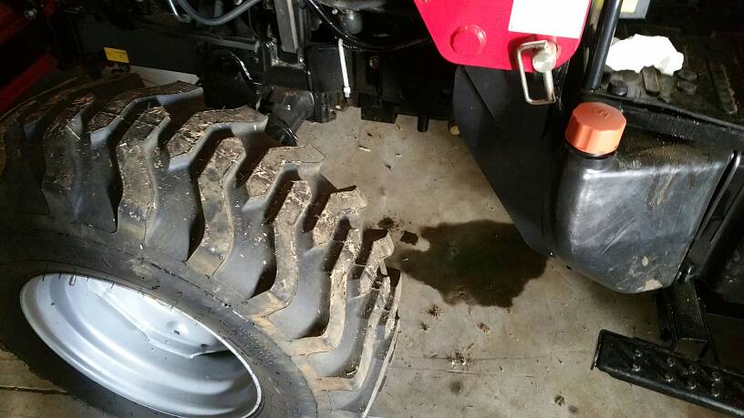

   / Buying new tractor - Kioti vs Mahindra #17
Coolant leak. Fixed two already, but I guess I have another one...... ugh!
