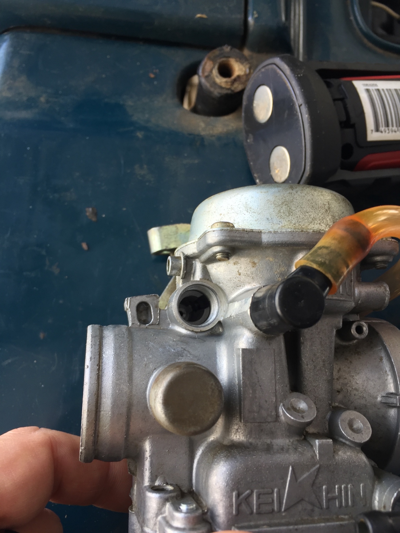

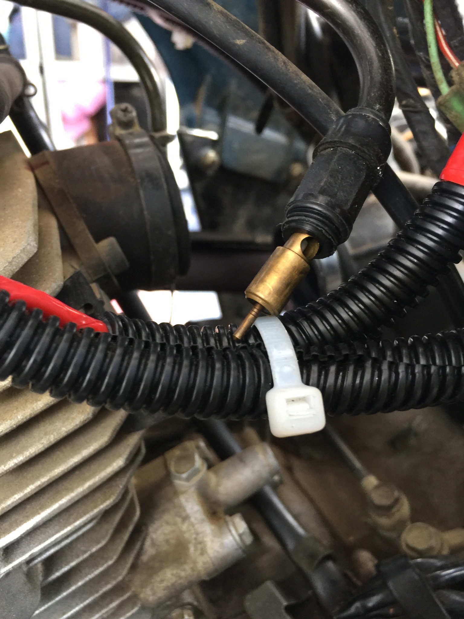

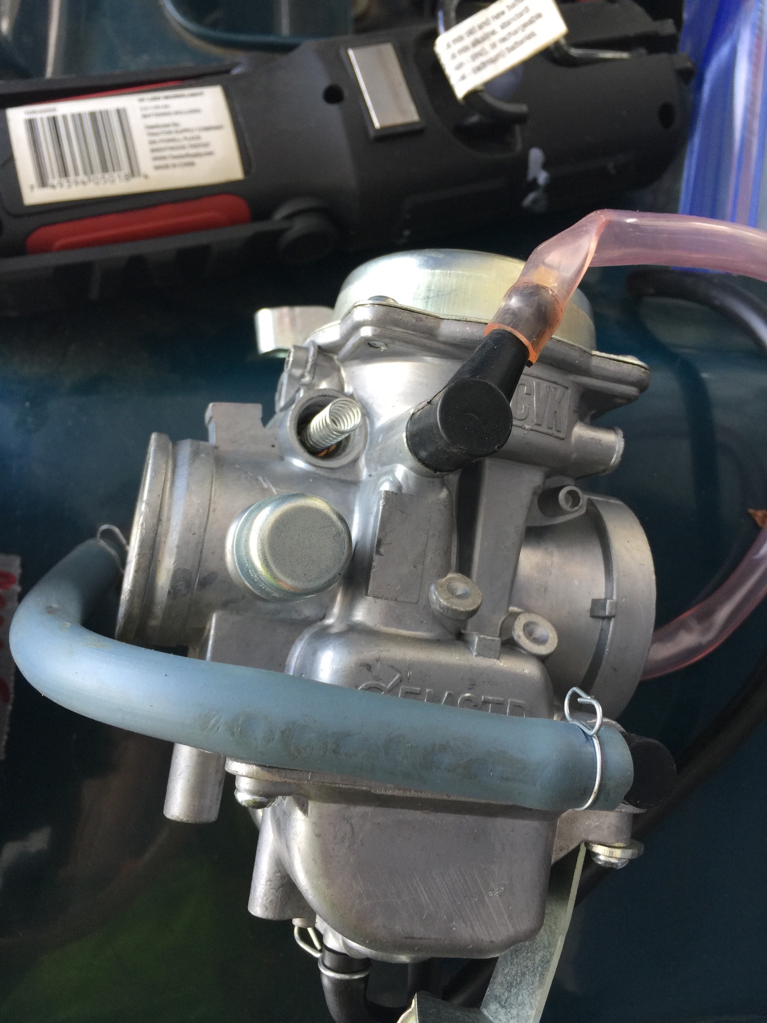

Thanks for the responses,I bought a replacement thru amazon and it said it was a direct replacement but after taking it out today everything looked the same except for where the choke cable goes into. So not sure if it has to be modified or not and I'm not sure what it would take to do. Again any thoughts and or suggestions. Thanks in advance. The 1st picture is of the original carburetor and there is a slot inside of the choke hole in the 2nd picture is the replacement and it has a spring and no slot in the choke hole. Thanks again IMG_0067.JPGIMG_0068.JPGIMG_0066.JPG

Thanks for the responses,I bought a replacement thru amazon and it said it was a direct replacement but after taking it out today everything looked the same except for where the choke cable goes into. So not sure if it has to be modified or not and I'm not sure what it would take to do. Again any thoughts and or suggestions. Thanks in advance. The 1st picture is of the original carburetor and there is a slot inside of the choke hole in the 2nd picture is the replacement and it has a spring and no slot in the choke hole. Thanks againView attachment 543402View attachment 543403View attachment 543401
First thing about the spring. I'm making the assumption its a replacement for the one in your original choke cable. Probably because it's one of those parts that wears out and they give you a new one instead of the complete cable assembly.
that spring is the replacement for the one on the end of the cable. there is most likely a new tip from your cable hiding in there also. Looks like the choke is pulled in your picture so push in the choke so you can get to the tip of that spring hiding in the screw fitting to push up the spring to get the old plunger tip off and install the new one that came with the carb. That part would have to be remove and replaced even with a new choke cable because they don't come with the choke cable.
