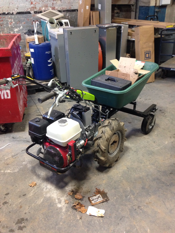

If your looking at a walk behind snowblower, but don't know your future needs check out two wheel tractors. Earthtoolsbcs.com is a great resource.
I have owned several 2 wheel tractors for snow removal, tilling, very very light grading of gravel walkways, PTO generator etc.
You can also mow, but I wouldn't want to do 1.5 acres
I owned a Grillo 107d version and it cost me $2900.
I attached a photo of my unit with the wheel barrow attached.
Good luck in your search!

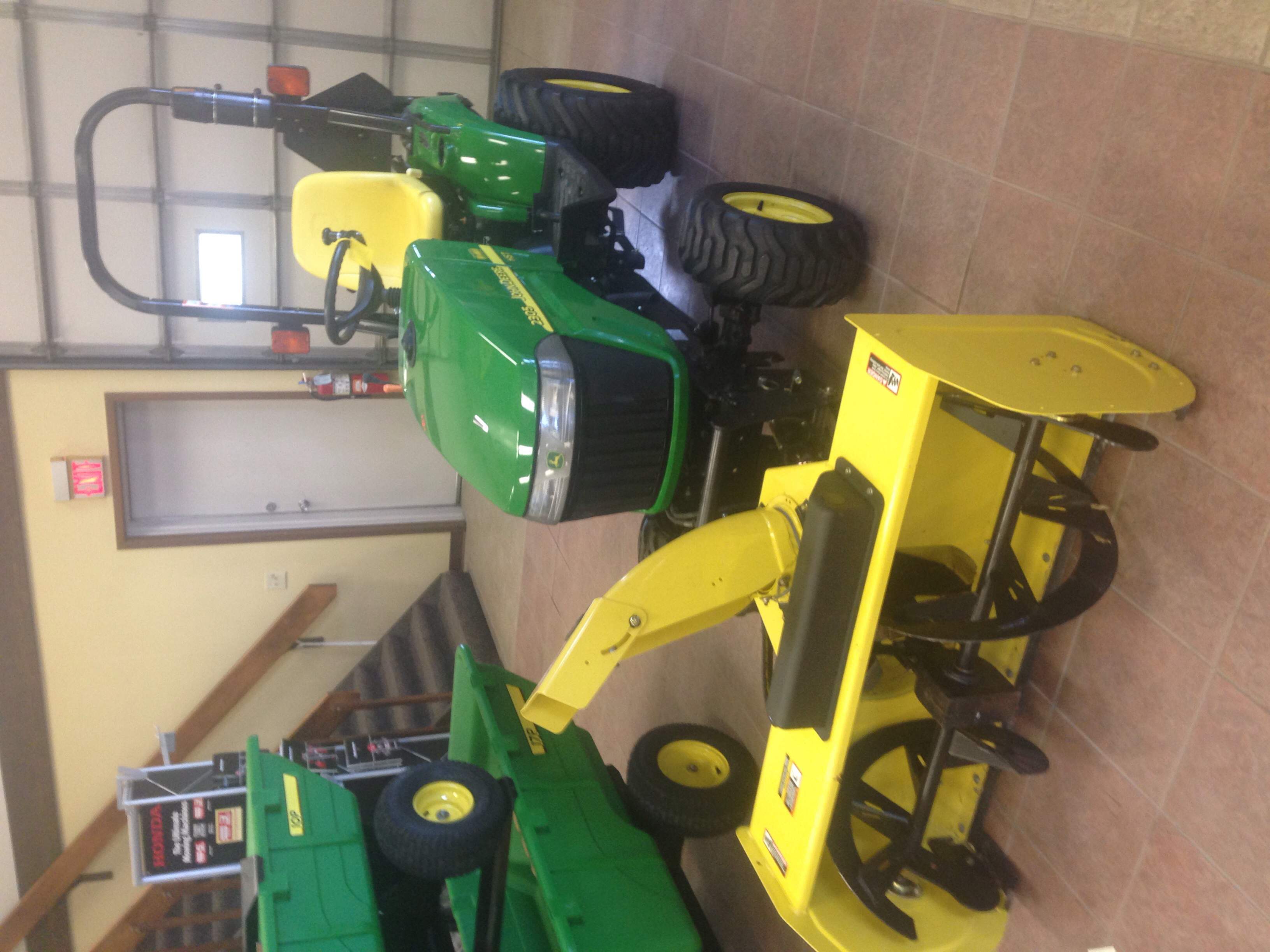

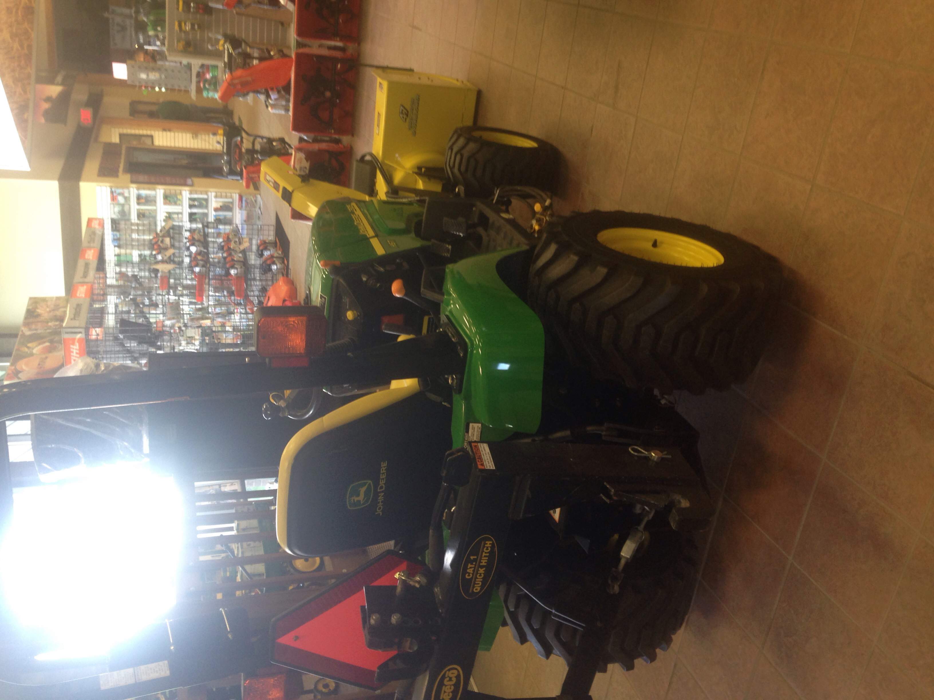

I have attempted to insert a couple pictures of a used John Deere 2305 that I looked at today. It is a 2012 with just under 300 hours on it. It comes with a 47" snow blower and a 62" mowing deck. Went to buy it and they have someone else that they are holding it for. I know it's more tractor than I need but want is probably the operative term form me in this sentence and I want something that is versatile for future use.
   / Buying the right tractor for 1.5 acres #100
Looks like a great fit to me. mower might be a little big but pusher mowers are cheap and would work good for the tight spots.
