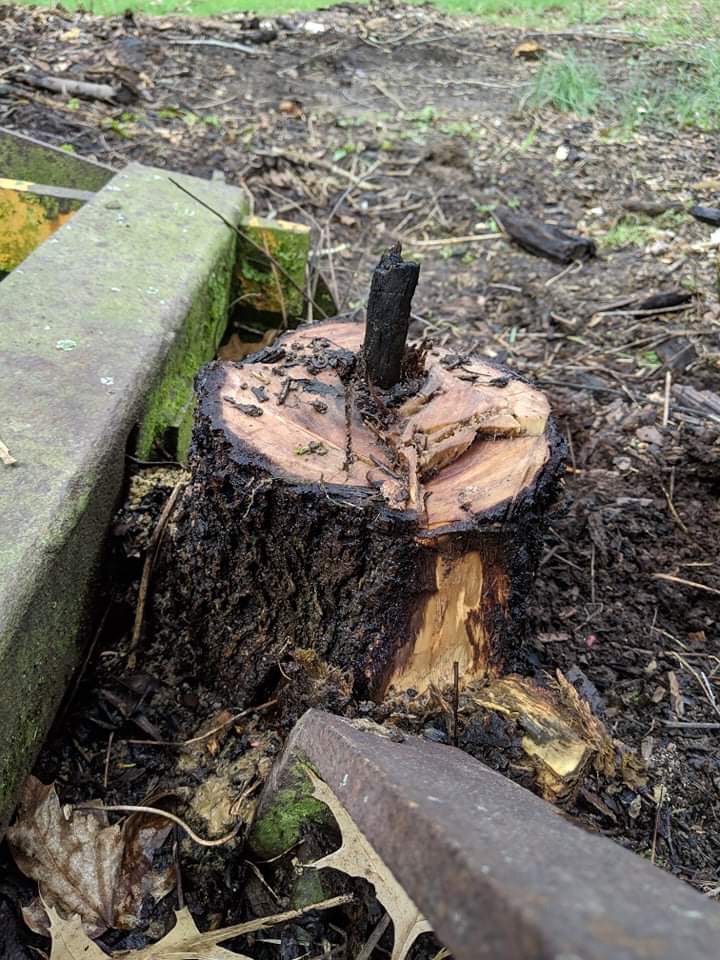

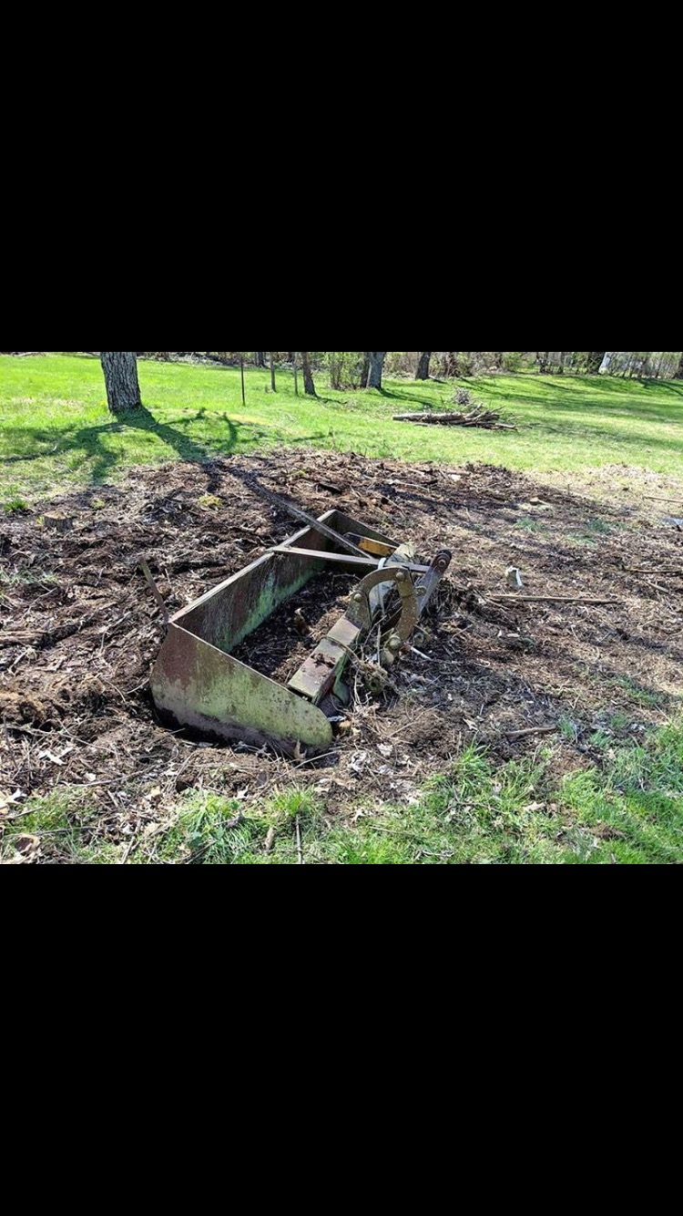

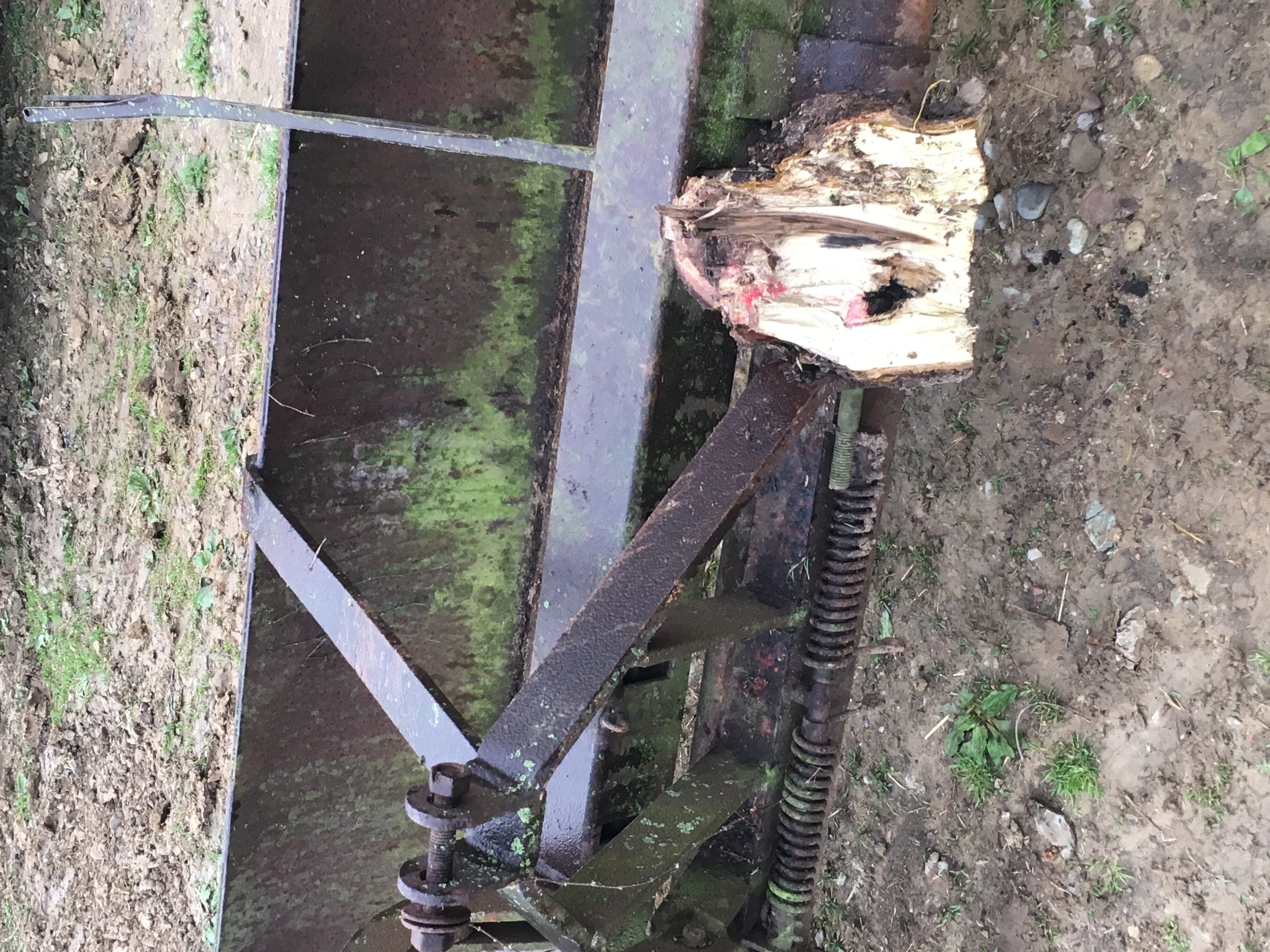

I’m buying this box blade for $325. I don't think I can get it any cheaper, but we will see. As you can see from the pictures, I m hoping it’s not damaged from the tree stump. I’m planning on bring my skid steer to load it, and I’m hoping I can pry the stump right out. Does anyone have any idea what the brand/model is? The only tooth left on it appears to be 1/2 thick. It appears to be built like a brick shithouse, so I hope its functional!

Just a guess by the color and shape of box I would say it could be an older Wood's/Frontier . My second guess would be a Gannon .

I was thinking Gannon myself, but haven’t been able to find a picture of a comparable model...
   / Buying this box blade....Bad idea? Any idea of manufacturer? #4
The general shape looks like a Gannon, as does the rotating scarfier mount. But the actuator for the scarfier bar isnt like any Gannon I know of. All the mechinism for them is inside the toplink tower.
I'm guessing it's been rebuilt severely at least once. But if the cutting edge is in decent shape it's well worth the $350 or we whatever. A box blade isnt a complex or precision impliment. Heavy & a decent cutting edge are the most important points.

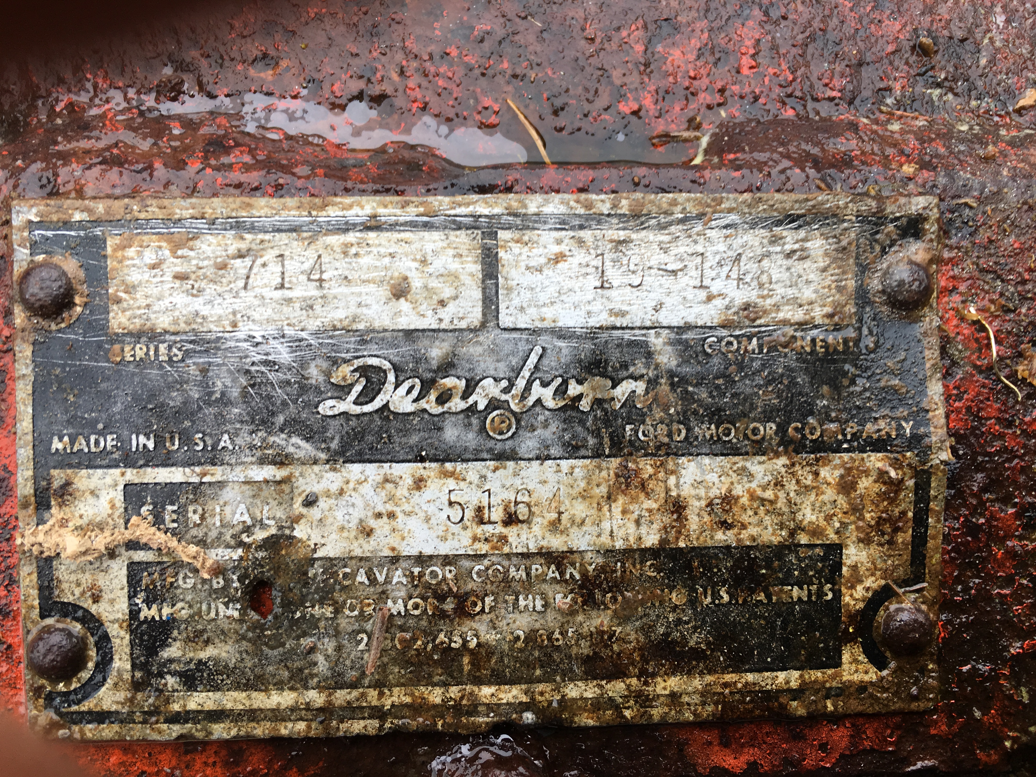

So I was able to pick up the box blade today. Took several wedges, a sledge, chainsaw and every ounce of power out of my L3400’s front end loader. I took some more pictures which I will add below. I was able to locate a data plate. It reads Dearborn, Series 714, component 19-148, along with a serial number. The only shank with the box is 3/4? and has 3 holes. I’m not sure it’s an original. The long tubular box that rotates up and down appears to have a mechanism on the inside that holds all the shanks in. The front and rear blades appear to be stout, but do not have any resemblance of a edge; I’m hoping they can be sharpened. The torsion springs are pretty rusted, and I don’t believe they are complete. I would need a manual or need to see a picture of an operational one to tell how they attach and function.
Any advice anyone has on getting this thing operational I would be grateful for. Google has not helped me much in the way of literature, parts, etc.

Being that it’s a Ford/Dearborn i’m Betting on it being a Gannon, as Ford had them build a lot of their attachments from the early
60’s into the 80’s. With that serial number, it’s an old one
