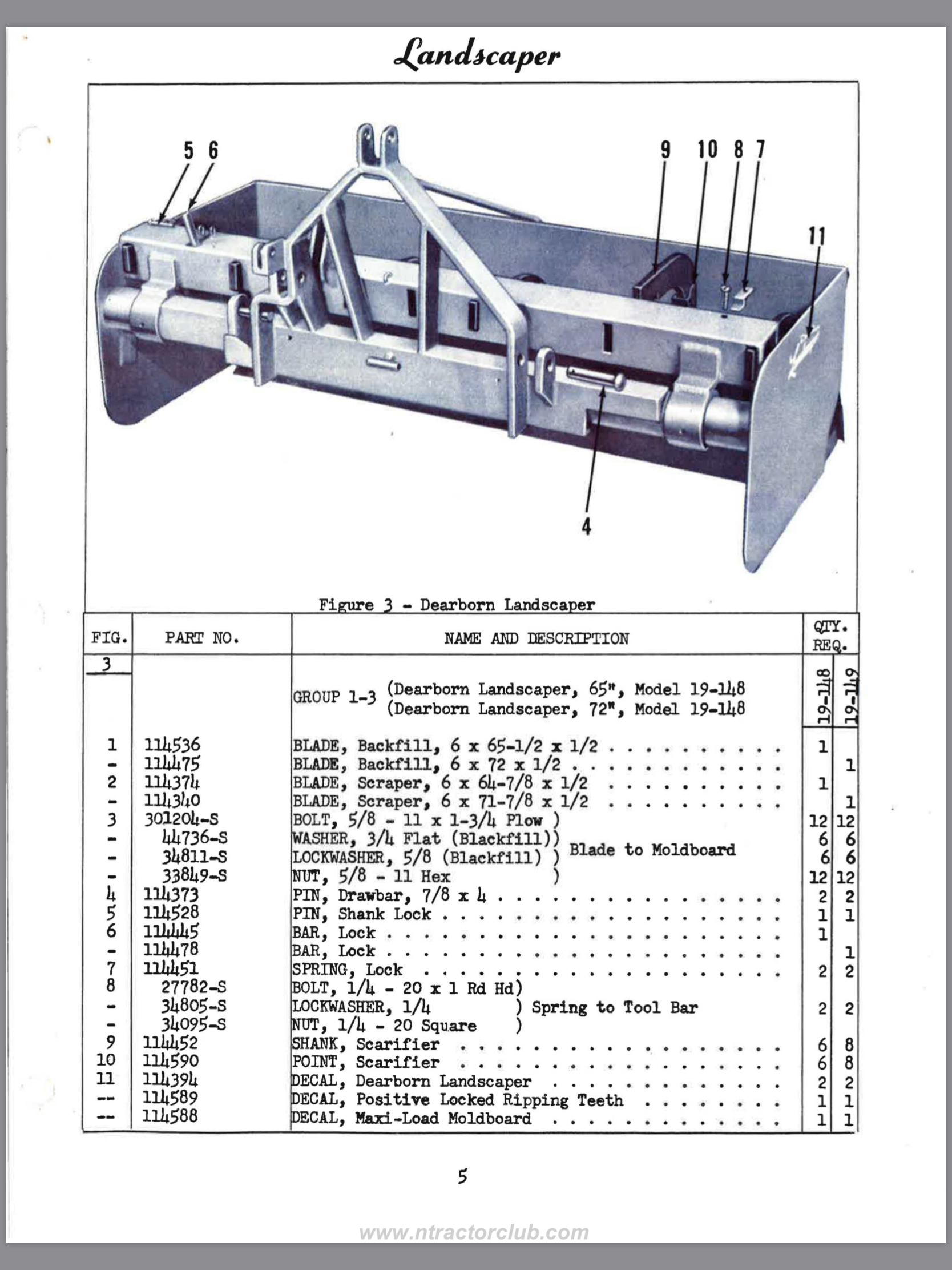

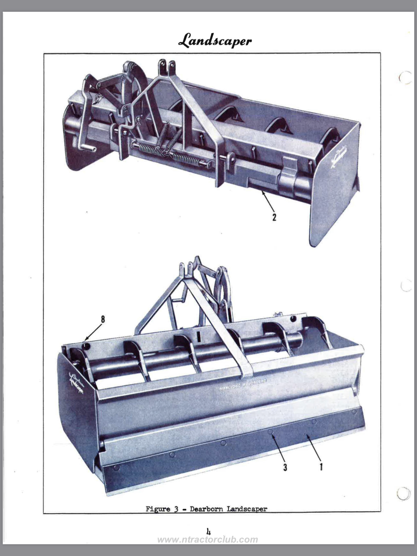

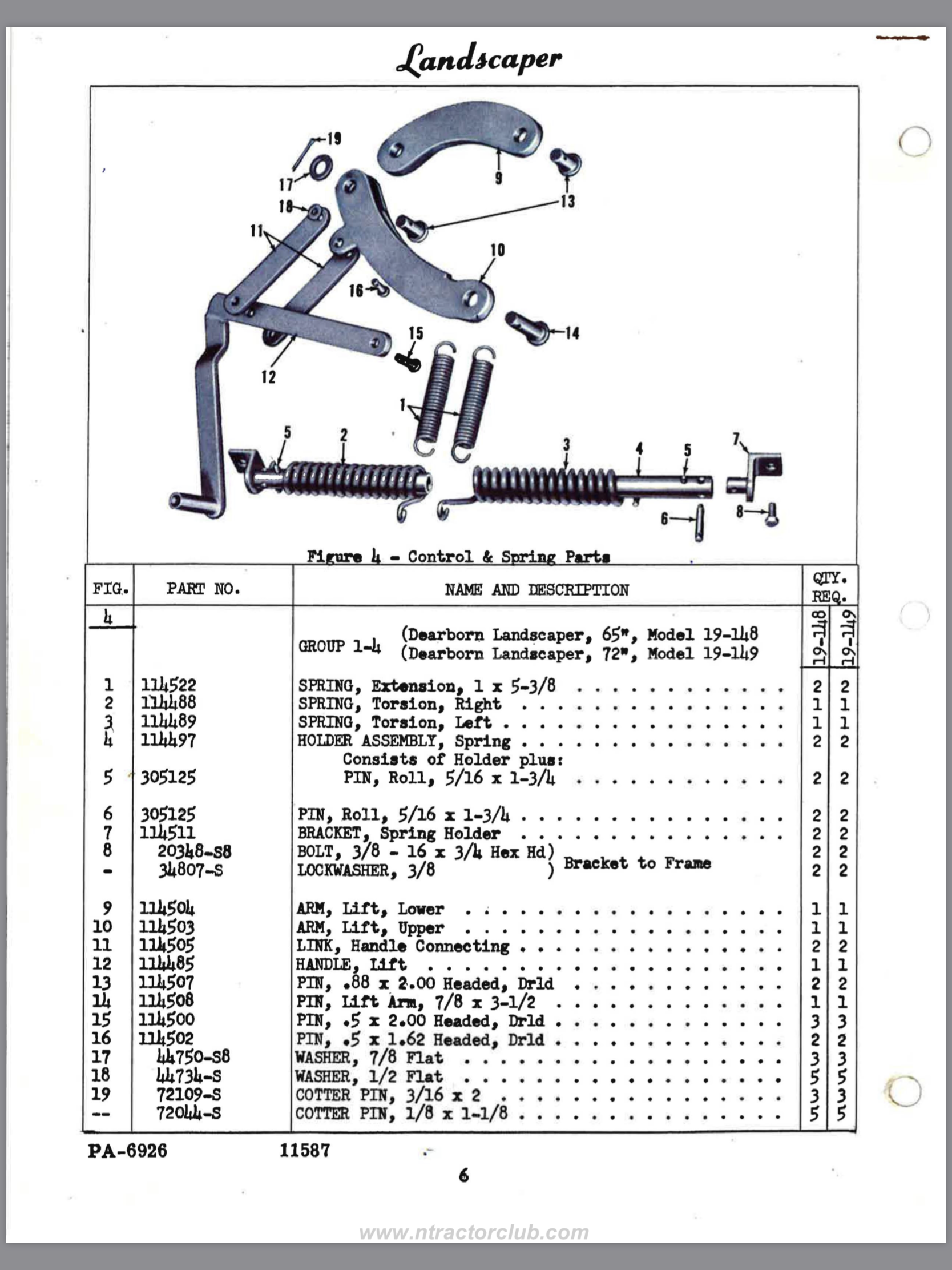

So after searching for several hours, I was able to find the parts diagram. I must admit, it was getting frustrating when trying to search for anything 泥earborn? Almost everything that came up was real estate related in Dearborn, M*ch*gan. Adding Ford, Earthcavator, etc didn稚 help much either.
Is anyone sure of the progression of the original Earthcavator? From the limited info I have been able to find, it started with Earthcavator Manufacturing Inc, to Gannon, and now to Woods.
Regardless, here are the pictures of the parts diagram for the model I have, called the 鏑andscaper model.
