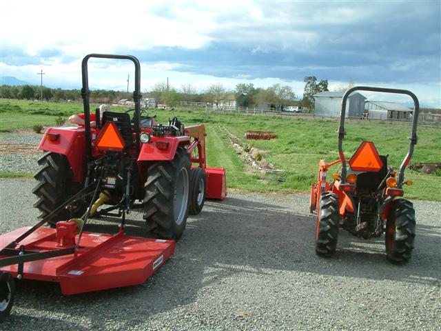

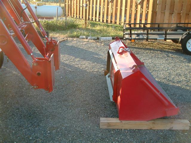

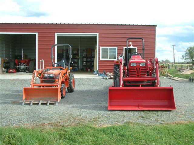

To work 30 acres, I'd be looking for larger CUTs in the 45-65 hp (pto range). As a minimum, something like the Kubota L4400 or my 2008 Mahindra 5525 (54 hp engine, 45 hp pto) would be typical. With the ML250 FEL (6 ft wide bucket, 2950 lb lift to 10.5 ft height), the 5525 cost about $18K (new). I had the dealer weld three chain hooks on the bucket and add the skid steer quick attach option to the FEL. There are triple hydraulic remotes on the rear of the tractor.
DSCF0061 (Small).JPGDSCF0062 (Small).JPGDSCF0067 (Small).JPGDSCF0110 (Small).JPG
