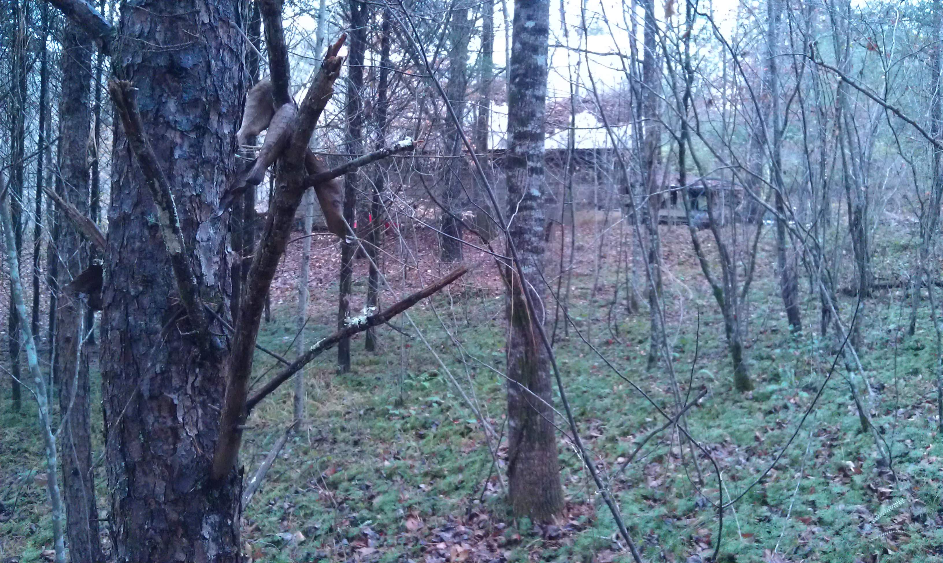

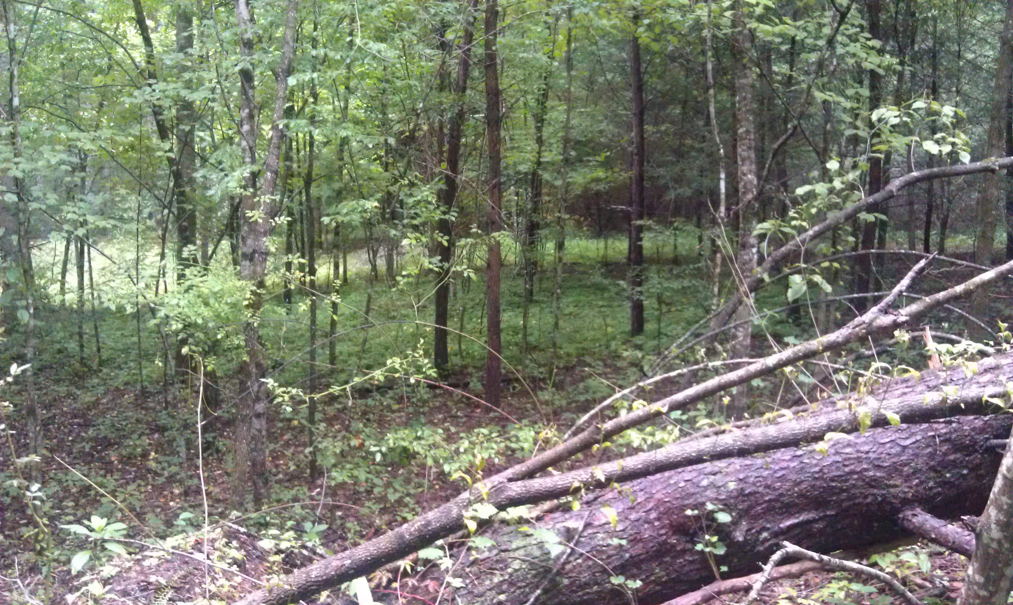

Thought I'd give an update on our land clearing job: I've been overseas for a bit, but will have (45)days off real soon. My GC gave a quick estimate for the following: $3,800 for clearing/grading driveway, no gravel, to home site (about 300yds). And $2,450 for clearing trees/brush from the (1) acre home site. The trees are about 25 Virginia Pine and Yellow Poplar, most of which are less than 12in diameter. My Uncle's JD350 crawler with clamshell loader has been offered for just the cost of fuel, and sits about 2min away from my property. I've attached a pic of the property, and I think I'm going to do it! I plan on reaching high, knocking them down, cutting off the stumps, then using the clamshell, piling the logs and stumps separately. I figure worst case, my GC charges the same amount just to fix my mistakes:laughing:
