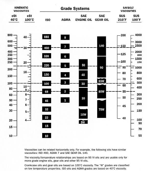

I was able to run the tractor this weekend to do a little light grading before planting grass. The buzzing sound is still present, however it is definitely significantly quieter than previously with the 80w-90. Loader, 3pt, transmission all seem to function just fine. I lowered the teeth a little further than I wanted to while grading and the box blade really bit in, but she kept chugging forward so all seems well in that regard.
I experimented with the clutch and the hydraulics because oldnslo's comment got me thinking. Clutch in = not forward or reverse, but loader still works.
I also took a peak into the hydraulic reservoir after running it and it seems the air bubbles I had mentioned earlier are much less numerous and dissipate more quickly. I was thinking about it more and the fluid was not foamy as some I've seen some people on the internet describe air entrainment. To me the bubbles seemed much more on par with fluid that was being sloshed over a bunch of moving gears and then was so thick (80w-90) that the bubbles did not have a chances to settle out yet. With the new hydraulic fluid, it seems that "settling out" process happens almost as quickly as I can shut the tractor off and unscrew the reservoir cap. Which makes sense to me considering how thin this stuff is.
I think i would like to investigate the Oil Suction Port (#16 on the diagram) that Dave pointed out. Makes sense to me that the issue creating the buzzing must be where ever the pipe is sucking from. After I get a chance to inspect that, I'll report back what it looks like and if I decide then to drain the fluid once more and get a fresh filter.
