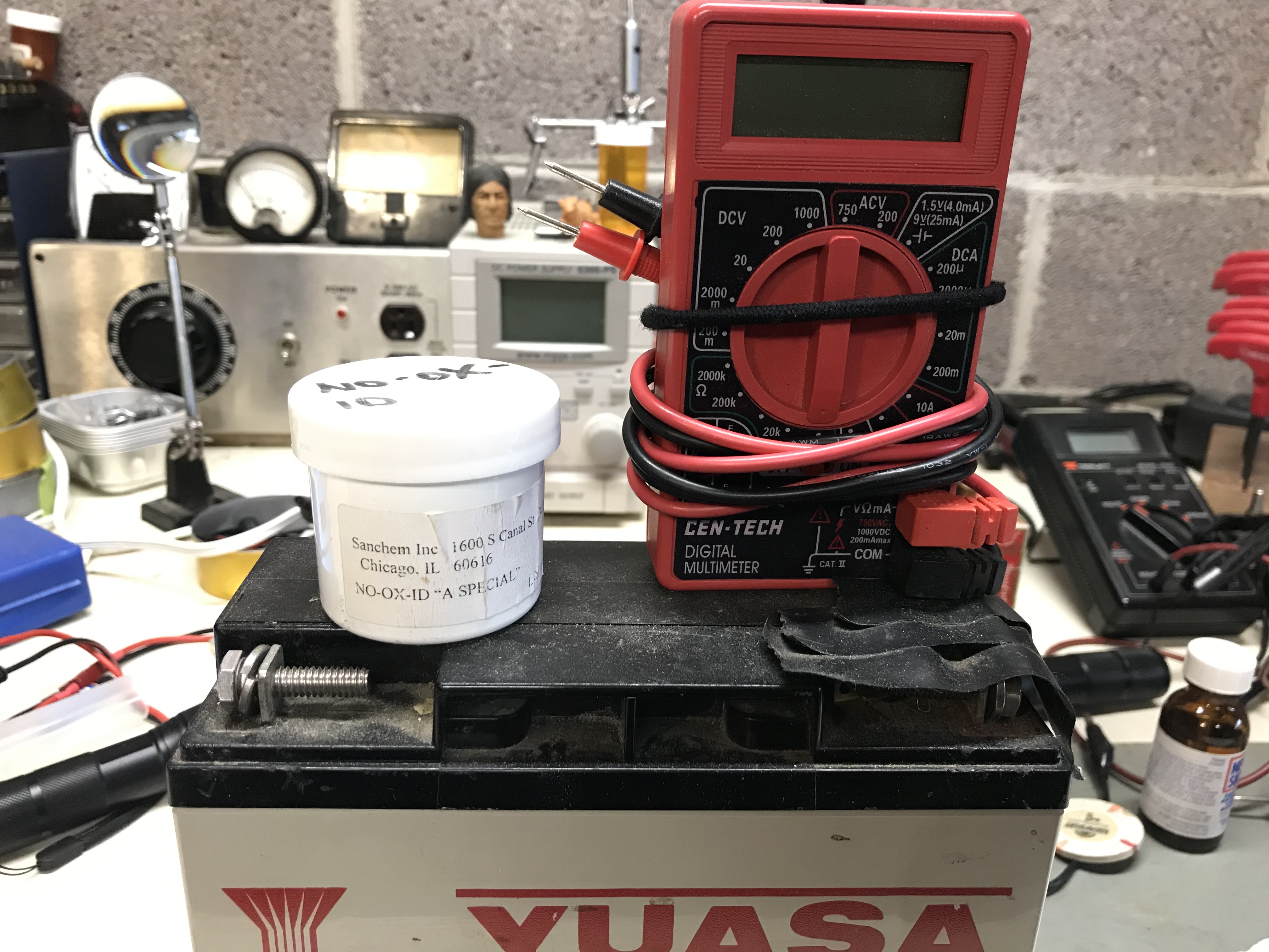

I have been telling people for many years to use No-Ox-Id, on battery terminals, But no one believes me. What do I know?. I only worked around and installed battery plants for many decades.. That all.. If you use No-Ox-Id, you will never replace a battery cable again. You will never have corrosion on cables. Using spray stuff and pretty little felt rings is about like pissing on them. Totally useless. But like I said, no one believe me, and you know what? ..........

I replaced mine like 5 years ago.....
James K0ua recommended using a paste ( I do not recall the name of it off hand right now) on the terminals.
Best stuff I have ever seen, no new corrosion and the positive cable still looks like the day I bought it from Bobcat
Well, looks like one believed me :) I didn't lie did I ?

I believe you....
I bought it and its the best investment I have ever made
I do not make an electrical connection that sees any sort of environmental contaminant that I don't coat with it!
