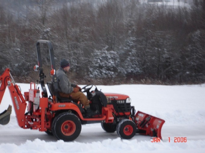

   / BX 22/23/24 Owners #2
I have used my BX23 with front blade a bunch this winter without any issues at all. It was quick and did a good job, plus it was a lot of fun. I don't know your situation but my driveway is about 400' long or so and there is about a 100' stretch that is 15%. The most I plowed this year at once was only about 15" or so. I bought the blade as I thought it would be quicker than a blower and was much less expensive, in fact, I am so satisfied I will probably not consider a blower, at least for next winter.

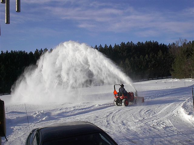

   / BX 22/23/24 Owners #10
I have been snowblowing for years now with my Bx in Mich North of Petoskey we are in a snow belt. Only problem ever was snow pluging the screen that covers the battery it is also the intake for the radator. The cure was a removable plate inside on the bottom that let in air again. the only problem with the trans fan is in the woods. sticks get up there and breakit. Its not easy to change. /forums/images/graemlins/frown.gif
