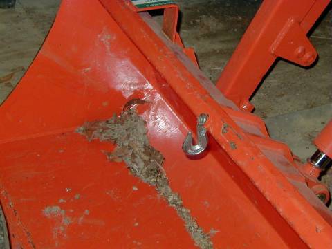

   / BX 22 Bucket Hooks #35
Here is how I did mine. I sometimes use straps rather than chain and these hooks lend themselves better for that. I put on two just to distribute the load a little.
   / BX 22 Bucket Hooks #37
JC Whitney: Item 81SB3477R Chrome Tow Hook Set
Quantity of 1 Total Price:$14.99.
I took a cut off wheel on my die grinder and cut off the excess bolt length, but that still leaves the ny-lock nuts on the inside of the bucket. I don't expect this to be a problem but if it is I will replace them with carriage bolts from the inside.
Hmmm, do carriage bolts come in grade 5 or better?
BTW, the hooks do not touch the front lip by about 1/8".
   / BX 22 Bucket Hooks #38
If you have a Tractor Supply Store near you you can get them there also. Not sure of the price of chromed hooks but it should be competitive. I bought a black painted one for my trailer that cost about $10 per hook. Some auto part stores also carry these hooks for truck applications as well.
   / BX 22 Bucket Hooks #39
Carriage bolts are available in Grades 2 and 5, as well as 18/8 Stainless Steel from Lawson Products. They generally sell through local area sales agents (although you may be able to buy directly on-line).
