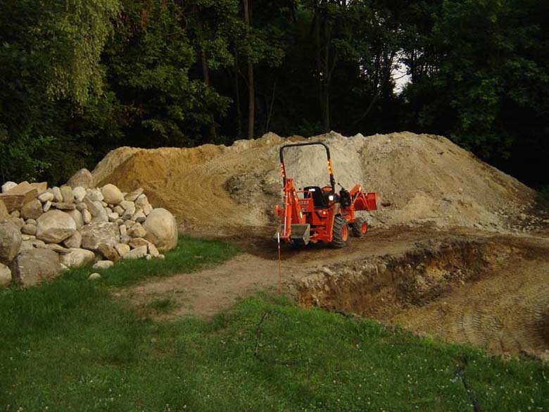

I believe the lift capacity of the BX FEL is 460 pounds at full height. It is higher at lower lift heights. I once tested the lift capacity of my BX23 by loading up the bucket with weightlifting weights and I was able to get 675 pounds up to waist height in the bucket. After having done extensive digging with my BX (see attached picture) I can say that you can load the bucket to the point where it won't lift. A lot of this is technique - I can overload the bucket (piled high to overflowing) with heavy gravel, wet topsoil, etc. and lift the bucket to a safe carrying height if I drive the tractor into the pile - the force of going into the pile forces the bucket up and the FEL hydraulics don't have to do all the lifting work. If you expect to be able just load the bucket up with heavy gravel or anything like that the BX FEL just isn't going to lift it. The one thing I do wish the BX had is a stronger FEL. Maybe when they come out with a new BX they will make a stronger FEL.

Forgot the picture...

You might try changing out your hydraulic fluid. Use the Kubota Super UDT. My tractor is at almost 285 hours and it seems lately like it might be losing some of it's lifting power. I know I have read in other threads here on TBN of people who changed out their hydraulic fluid and used the cheaper stuff - and afterwards the tractor seemed to lose some lifting power. Replacing the fluid with the SuperUDT made it work better again.
The backhoe bucket is a 24" - I bought it off of a fellow TBN member who sold his BX23 to get a B3030. The hole you see in the foreground of the picture is a foundation hole I have been digging to put in a new garage. The big bucket helps quite a bit with making a level bottom to pour the footer on. I have to be careful though of snagging rocks and it does not dig as well as the 12" bucket in rocky soil.
