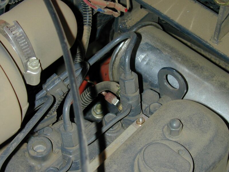

BX 23 Temp Gage < cold
   / BX 23 Temp Gage < cold #11
Here you go man. Pic taken from the right side at about the dash looking forward, the wire is close to the center of the pic, just to the left of the bottom of the #1 injector, it has an insulated terminal that is light red.
#12
Thanks for the shot brew, I looked at it this weekend and thought that must have been it. Its fully seated, I did everything just short of putting dielectric grease on it and re-seating. I am gonna run it again this week and see if its working. We got the heat on so I am expecting it to run > cold this time around.
