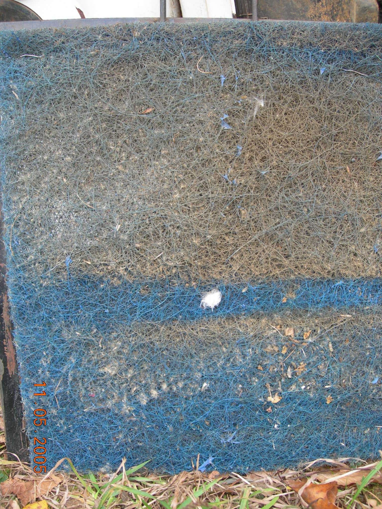

Blow, suck, back, front, no mater. What you want is clean cool air from some place that is free of chaff. I also use a Hogs Hair filter in front of the radiator to keep the junk out. Why Hogs Hair? Because it is TUFF and can take a beating.
