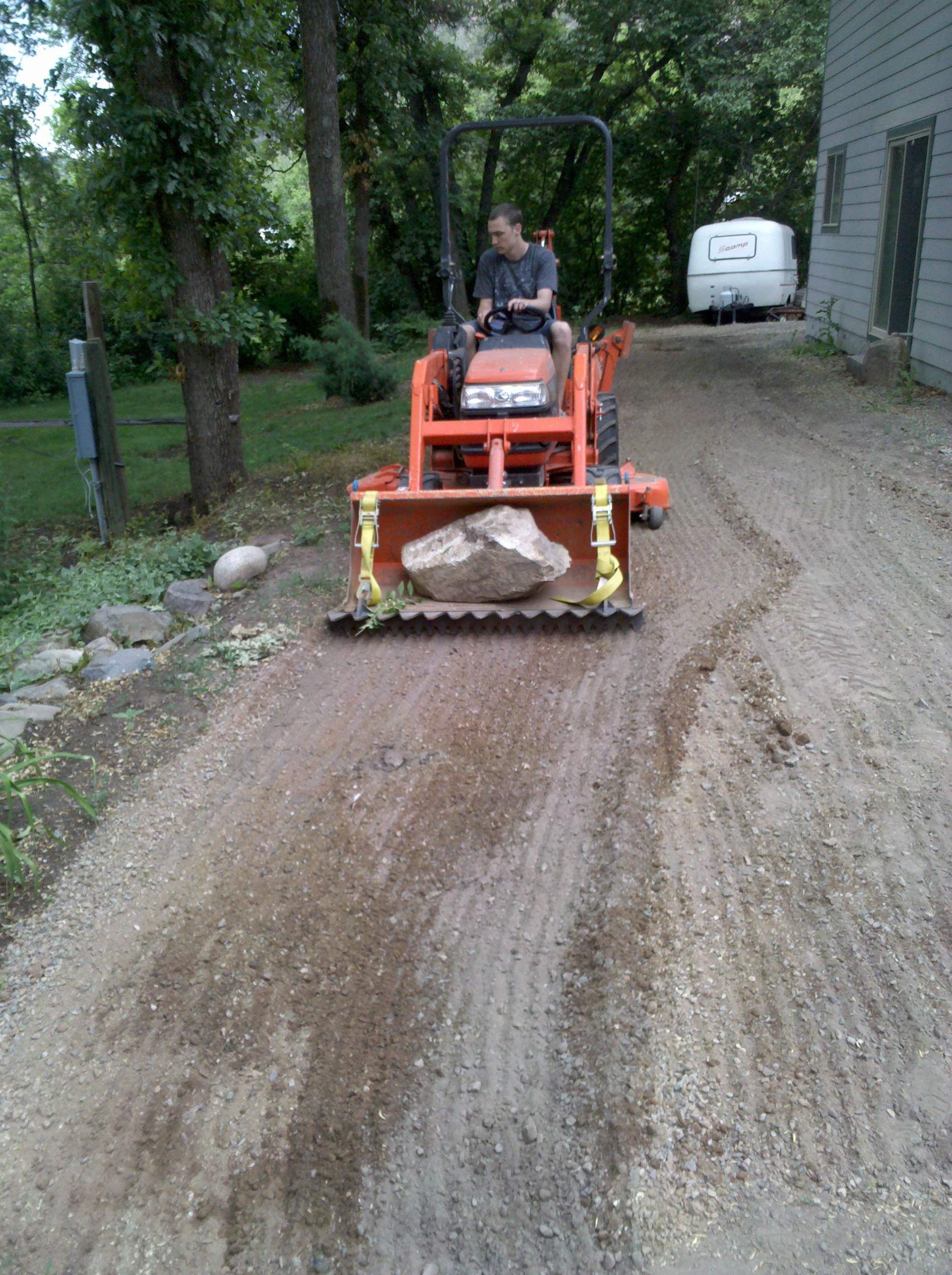

I have the ratchet rake on my front bucket and put a large rock in it. The teeth dig into the ground and it anchors the front much better. The BH can still pull the machine around, but every lit bit helps in anchoring the machine.
The rock makes the ratchet rake work great in the "float" position for manicuring the drive.

This is just a poor suggestion. Loading the BX FEL bucket is much simpler and less likely to damage anything, and why scratch up your new tractor when you simply don't have to. ;)
