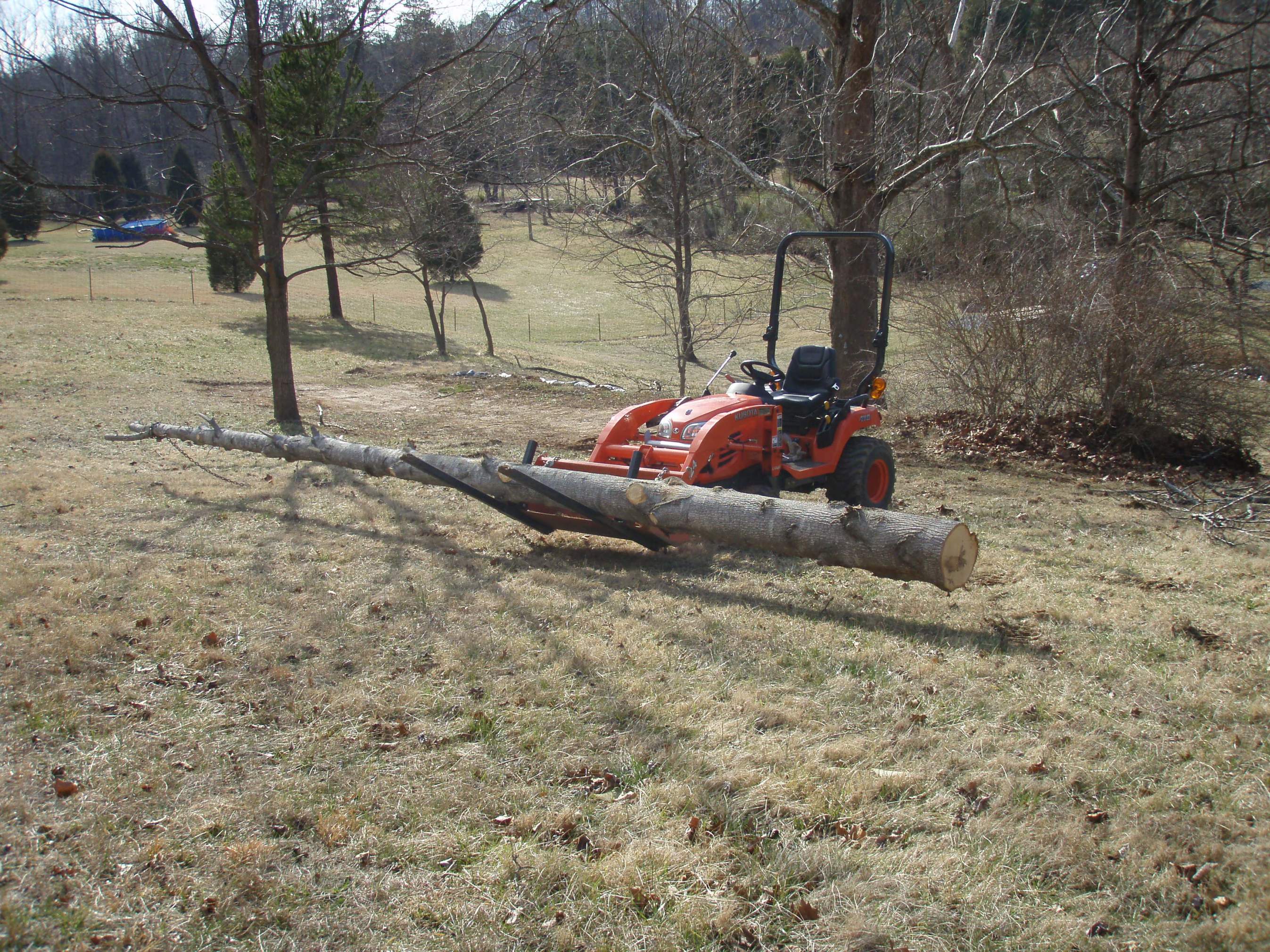

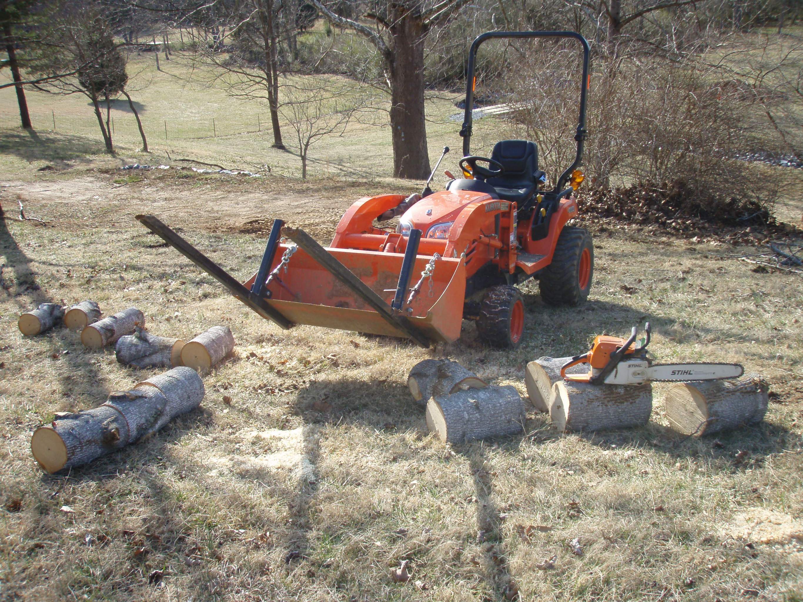

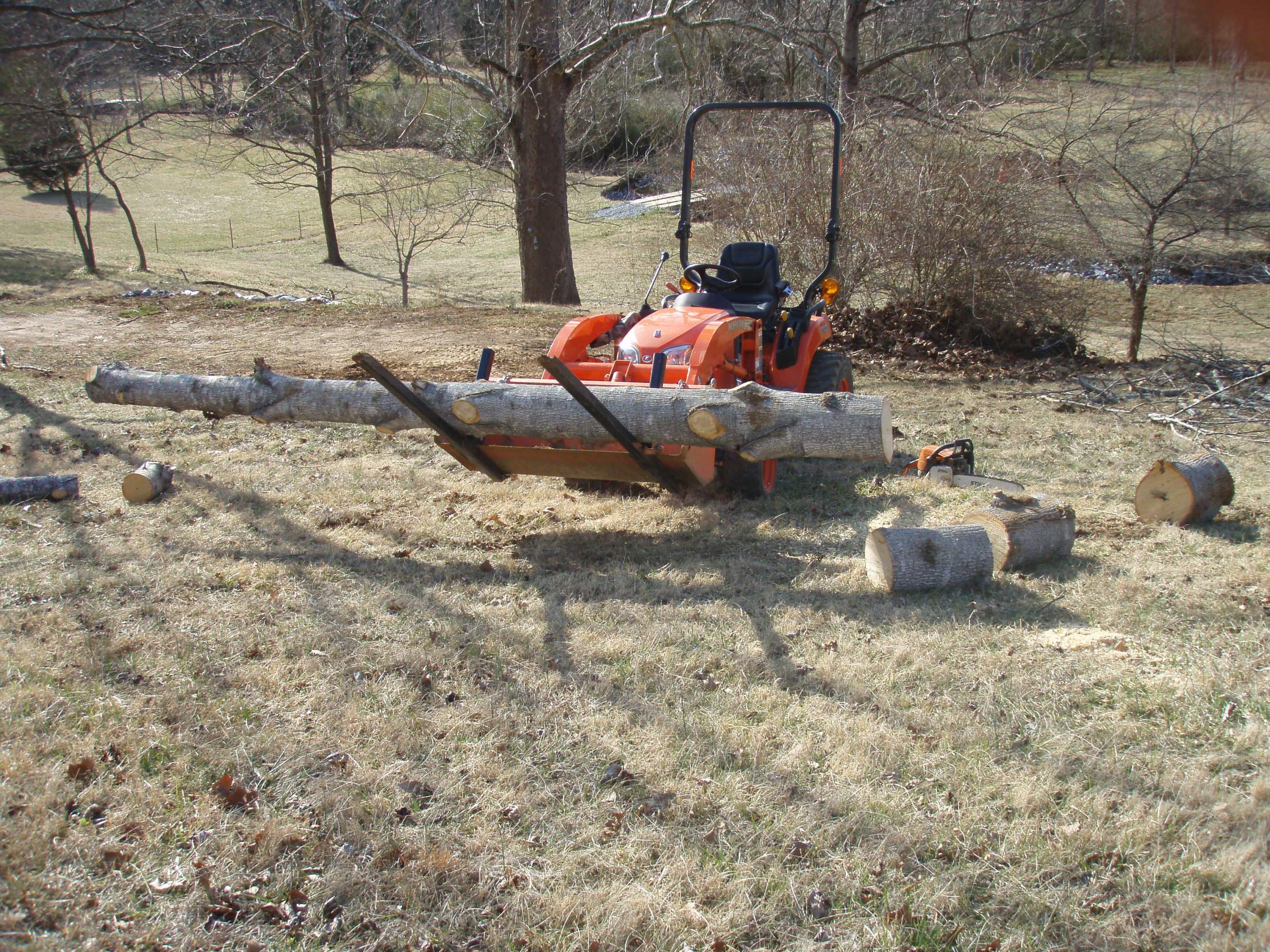

   / BX 24 Bucket Forks #18
Ruining chain saw chains in the dirt is history with a set of bucket forks.n
