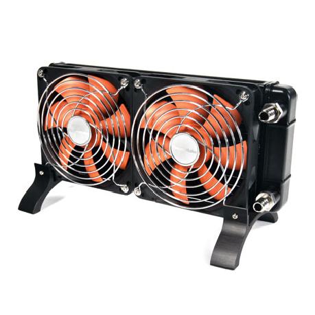

I would not be surprised if at some point in the heat after a long period of higher revs that the engine cooling system would have a harder time cooling things down - I guess my question would be if it is doing any harm to the motor running 20 degrees warmer than "normal". I know the hydraulic fluid breaks down faster at high temps so I guess the engine oil would do the same thing. Add a cab and some heater cores and they should be able to help with the extra heat in the summer ...
One thing I know for certain is that the copy writer for those ads are often clueless as to how things actually work and are simply going for dramatic effect. I like the shows Ice Road Truckers and the towing show Wrecked, but depending on how you look at things, they often either outright lie about specific dangers to make them more dramatic, or they simply don't know ... Either way, they are still fun to watch.
