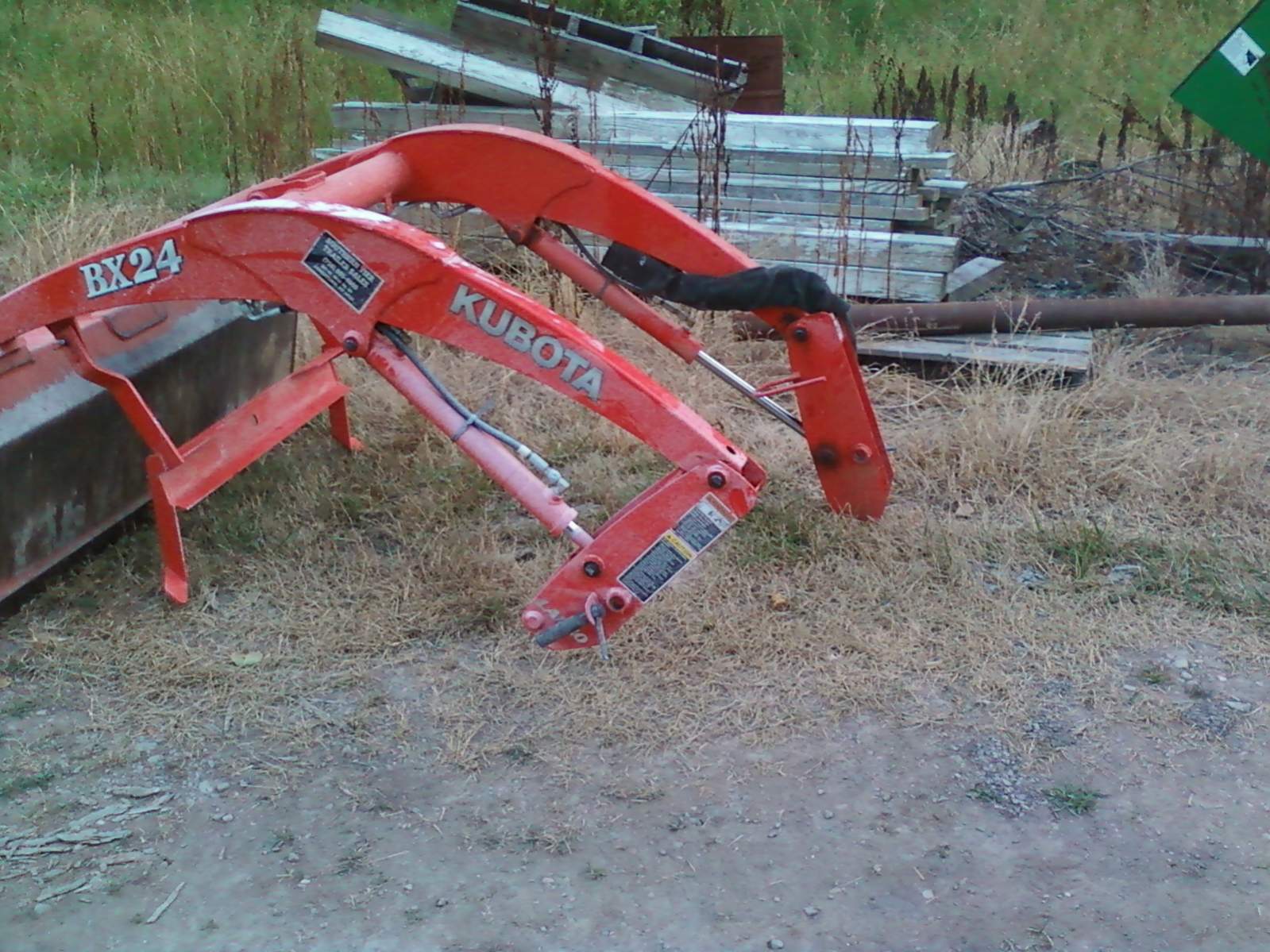

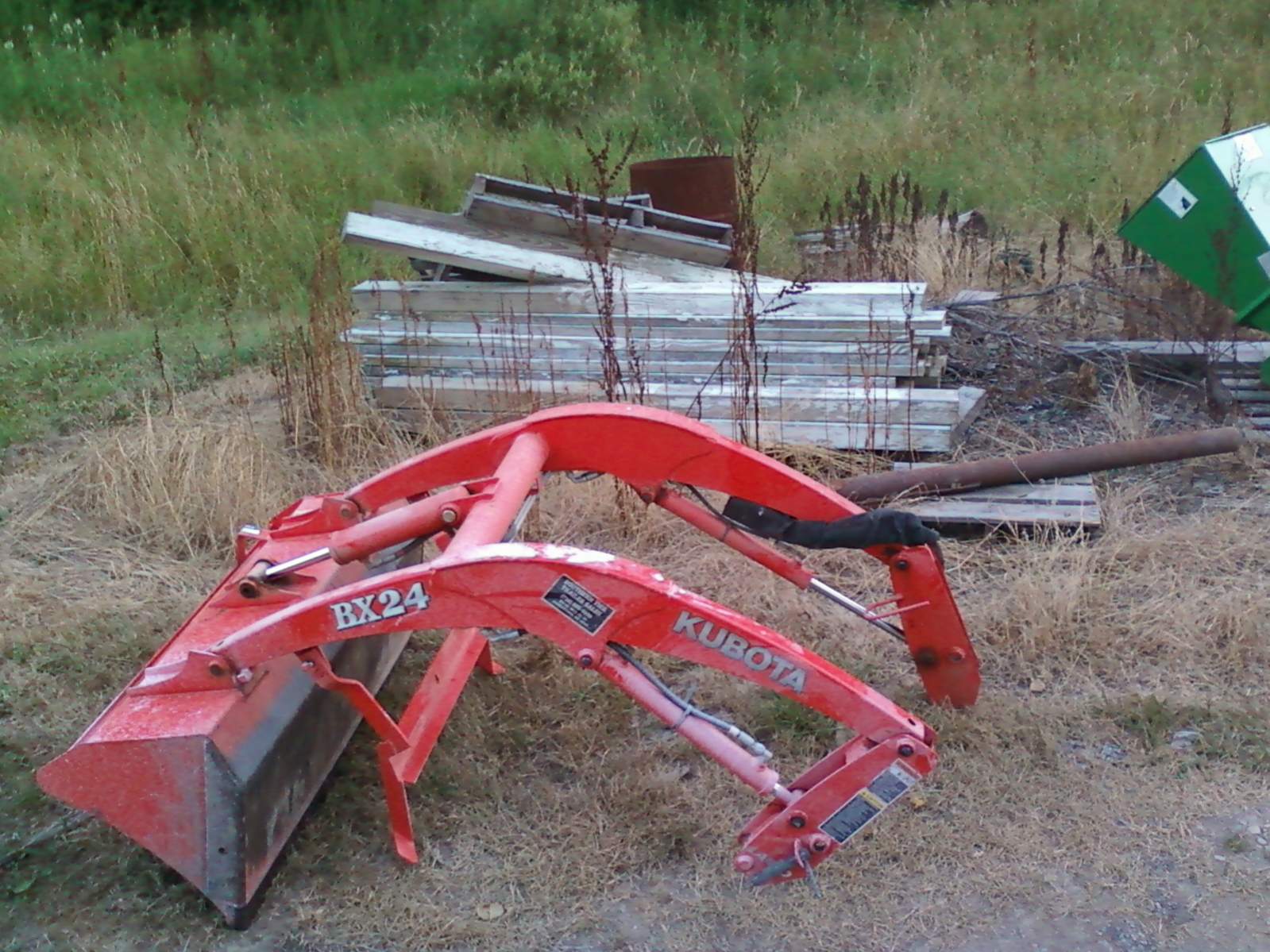

I have yet to get my FEL to play nice and park well on my very uneven ground.
This is what it did to me today :(
I know it's not suppose to look like that, but that's what it took to shake the booger FEL off of the front of the tractor...

Why do you still have uneven ground where you remove the FEL?

Dude,...Use the FEL to make a level spot...Allowing that to happen will cause all kinds of down the road problems, and it dangerous in more ways than one.

I'm not sure but it looks like maybe you are removing it wrong. Solid level ground is a lot easier to remove and reinstall it but it still should not look like that. When I remove mine I put the bucket down level on the ground allow the bucket to pull the tractor up, remove the pins and let it back down, which should move the arms forward and then tilt the bucket to allow it to come out of the bottom notches. The fel should be resting on the stand and the bucket should be fairly flat on the ground. Hope this helps?
/ BX-24 loader hates me #6
Here's a video that pretty much follows the way the manual says to remove the FEL. I use the method in the manual and it seems to work fine. Have done it on smooth concrete and a stone pad without any problems.

I think al is putting us on for show. If you look at the right side of fel arms, its appears to be touching the ground. It looks like he unhooked FEL sideways on hill instead of pointing down hill. I see he has pallets/timber in background he could've used it on the low side of bucket/FEL stand of hill to uneven it out. but then when rehooking it, it will be a nightmare due to rear tires on different plane. :laughing:

It went back on easily enough... I take it off when I'm servicing the engine and axle since it tends to get in the way.
We haven't had rain for ages, and I was in no mood to try and flatten a hunk of rock-hard dirt to pop the FEL off... I was just annoyed at how clumsy it was.

Looks like you need to work on your technique a bit, that bucket need to be flat on the ground when it is off the tractor

You need to watch the angle of the mounts when you hook up. Works best to push the tractor into the loader, this keeps it all in alignment.
Then when you dump the bucket watch the pins, if the are going to miss just bump the lift slightly to push the arms into the tractor.
I have 2 Kubotas with loaders and neither take more than 2 minutes to install when on concrete and no more that 5 in the dirt.
Between the 2 I probably pull the loaders 20 times a season as I pull them for service and brush hogging.
If in the dirt put a thin piece of wood or steel under the bucket lip and the feet so it slide as needed.
