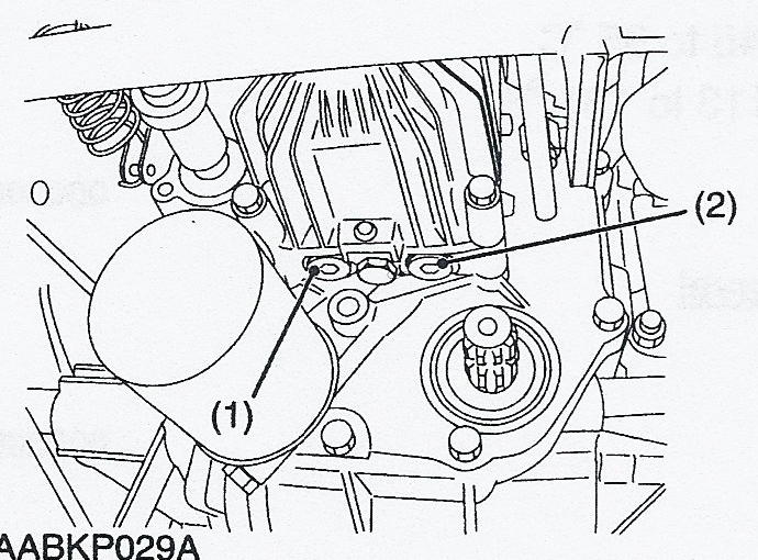

HST Sensor...Hmmm. Would have to be mounted in the actual closed loop HST flow path between pump and motor to be of any use. Reading the temp on the return line from the power steering wouldn't do any good. On the top and bottom of the HST there are two plugs that close the galleries between the HST pump and motor. The plugs are threaded 3/4 16 UNF. If a temp sensor could be found to fit in one of these plug openings, could be wired to a gauge (or the existing idiot light on some BXs if you could find the right temp switch). Would probably need to be stainless and rated to 2000+ psi. Spec for HST pressure is 1991 psi. Would have to make sure sensor didn't protrude too far into flow path and impede flow.
Picture below shows location of these plugs on bottom of HST. There are two more plugs on top of HST that would be more protected if there is room. I know these plugs exist on the 22, 23, 24, 2200, & 2230.
I'd be interested if anybody had a good idea where to get a temp sensor.

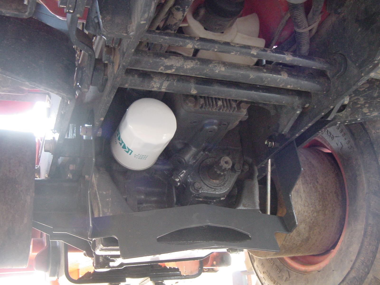

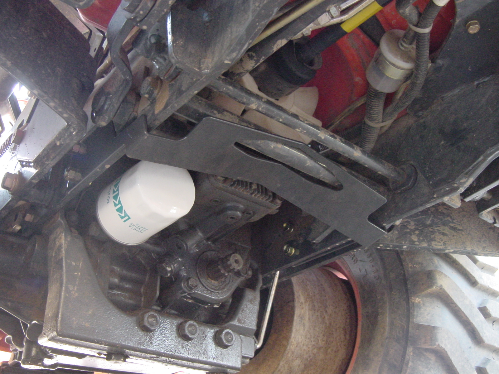

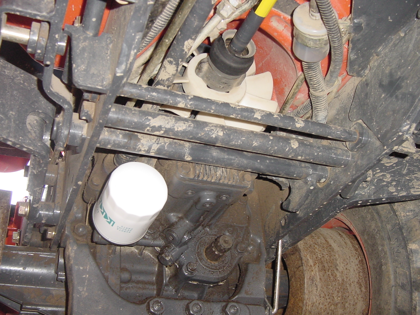

I have installed a Kubota PN K2581-92120 "skid plate" on my BX-24. The part is more of a fan guard than a skid plate. But for $37, it is what it is. I had to scratch my head a little bit to figure out how it fit up. So I thought that I would provide some photos of the process.
The first photo shows the fan area before the installation.
The second photo shows the guard partially installed, and hanging down by just 2 bolts.
The third photo is the finished job.
As you can see, the fan is still exposed to brush and limbs that may attack it horizontally, but not from straight down.
By the way, the big rusty things are the wheel spacer/weights.
