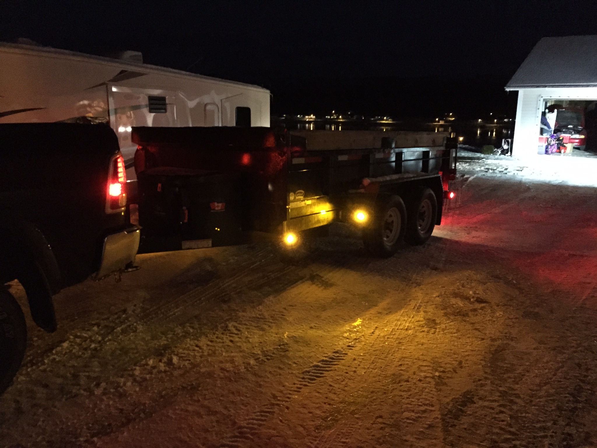

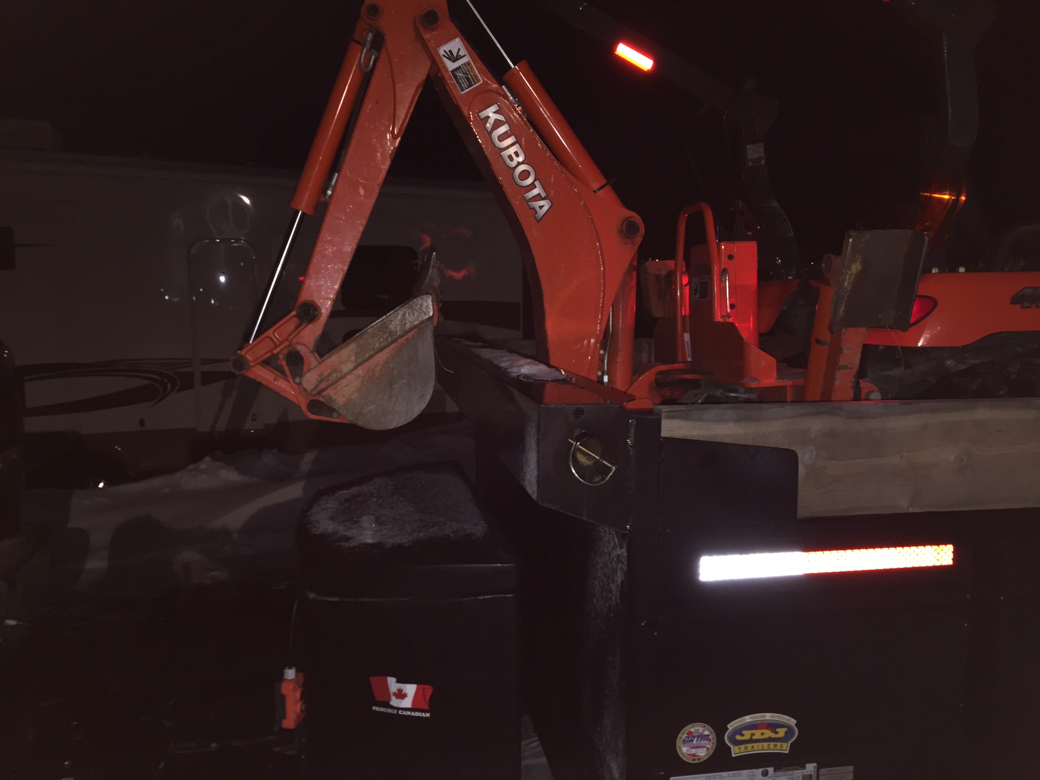

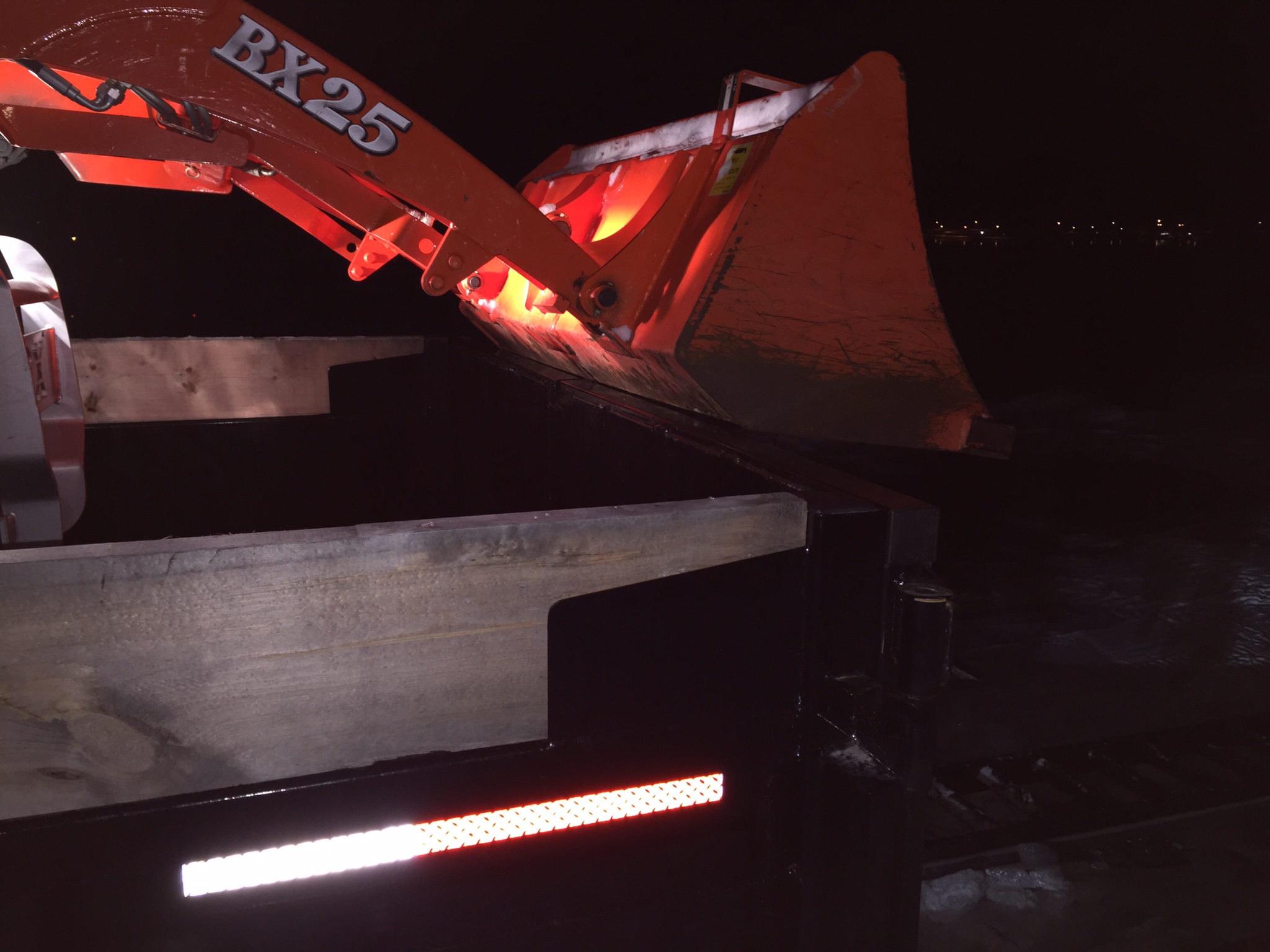

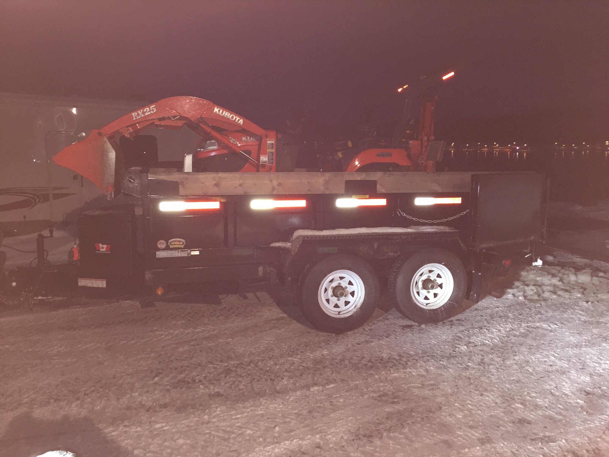

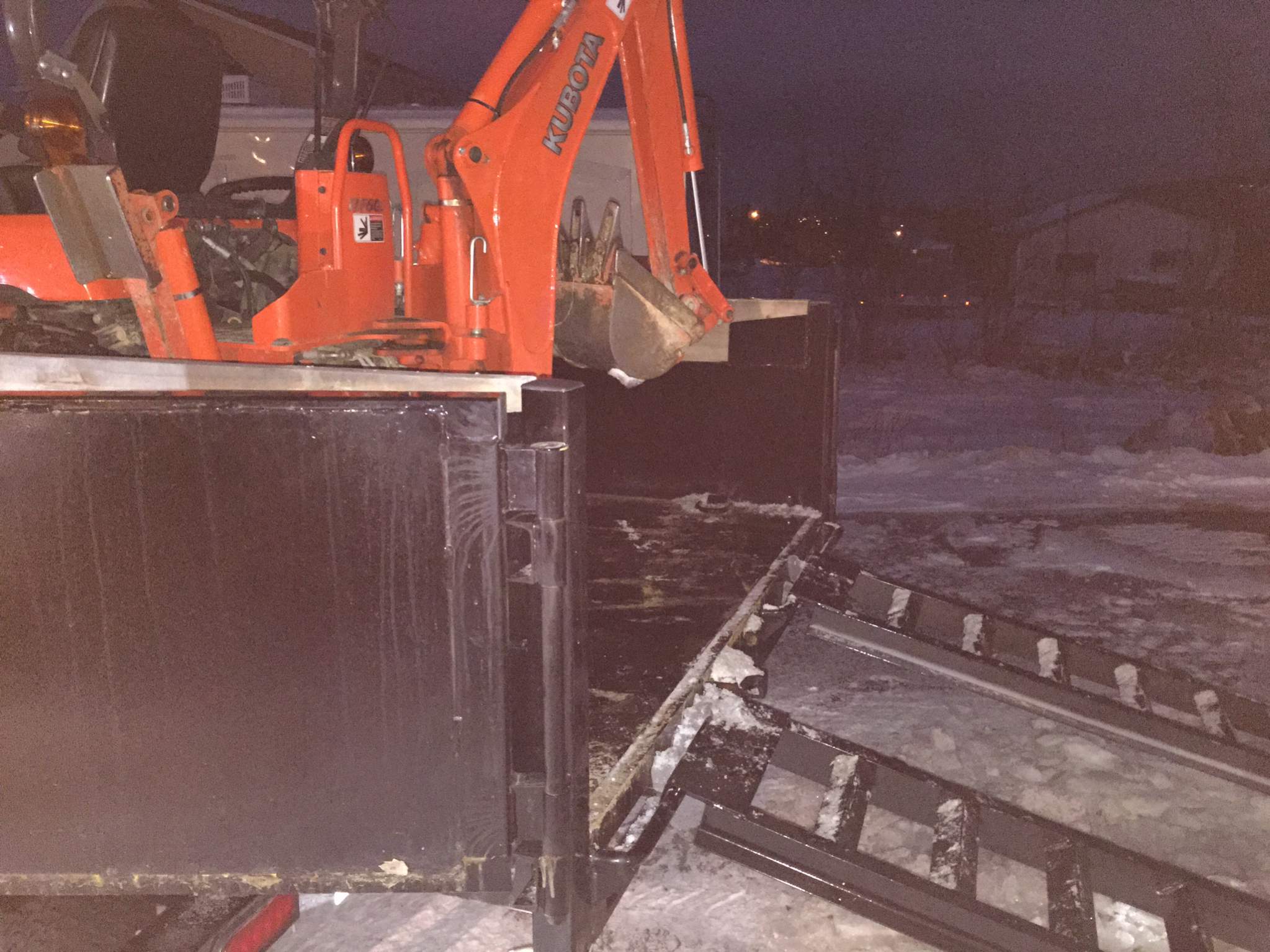

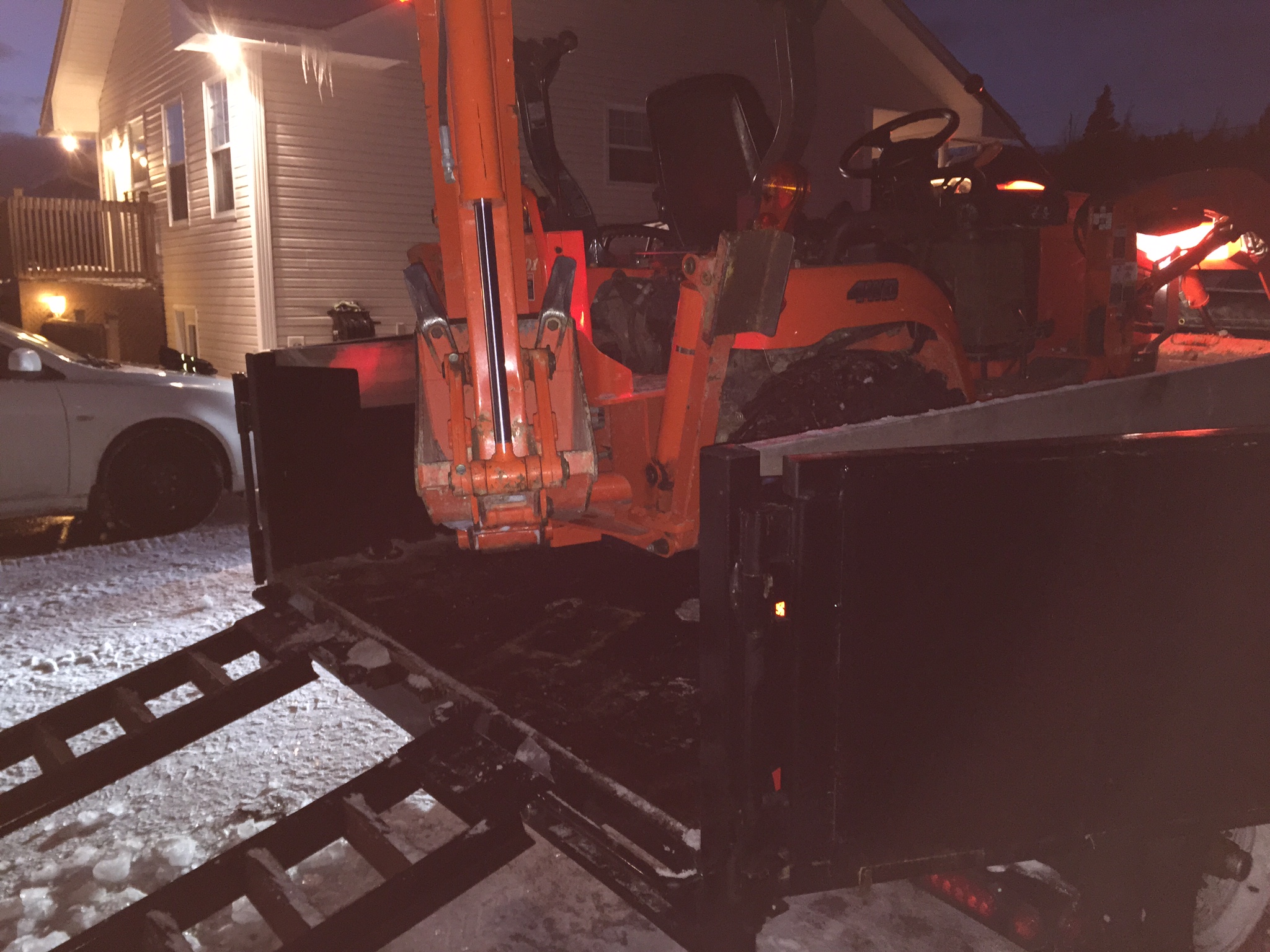

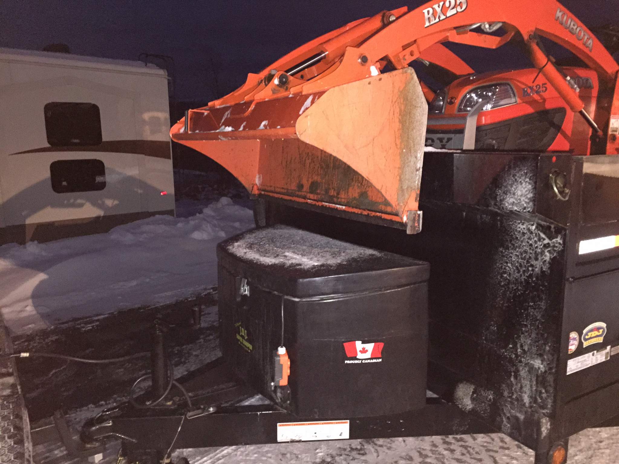

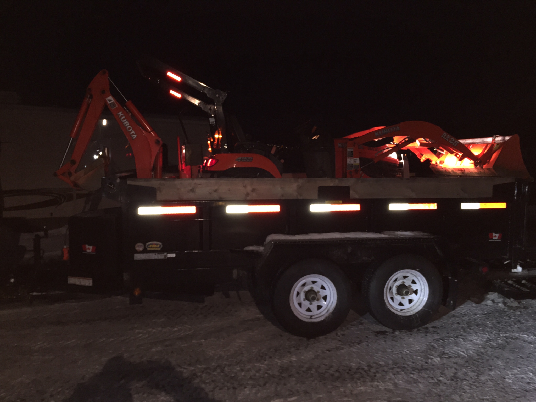

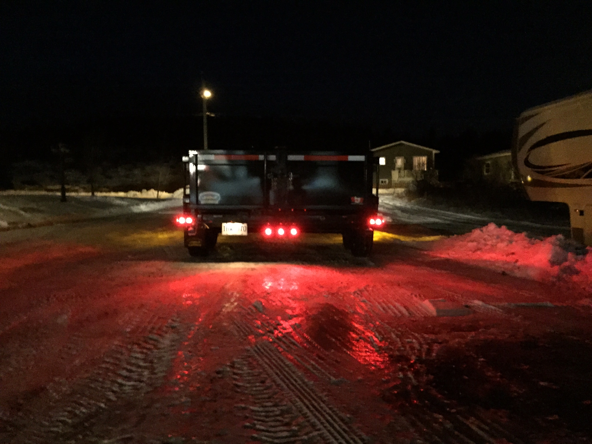

Guys, took some pics tonight....yes in the dark again. Anyway as expected, the BX wont fit without either the FER or BH hanging out over. I guess I will have to come up with something to rest the FEL on with the BX backed in.....I like her in that way more for some reason. Let me know what you think.

I think ypu made the right choice by going with the longer and heavier duty trailer.

Guys, took some pics tonight....yes in the dark again. Anyway as expected, the BX wont fit with either the FER or BH hanging out over. I guess I will have to come up with something to rest the FEL on with the BX backed in.....I like her in that way more for some reason. Let me know what you think.
No problem. Have the FEL inside, and hang the BH out over the back, where you can chain it to the outside back of the trailer. What do you have back there that you can hook on to?
I'm sure there is something back there to chain it to however it seems when loaded that way there is to much weight rear of the trailer axles.....it seems better loaded when she is backed in.
OK, is there something you can chain the backhoe bucket to over the front of the trailer, and with that arrangement, will the FEL bucket still fit inside the trailer?

I have a 14 ft trailer ( no sides) that the bucket goes over the box on the front like yours. I fastened a 2x12 across the top of the box and let the bucket sit on that. It doesn't hurt the box at all.
I don't tie the bucket down, but the tractor axles are tied down in all four corners.
I don't have a picture, but yours reminded me of how I do it.
With yours, just screw the 2x12 onto the box top from the bottom, and set the bucket on it. If you're afraid the bucket will bounce on the box, then put a strap to the trailer.
I think it would work fine.
