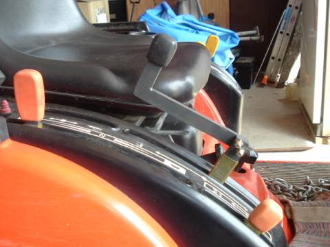

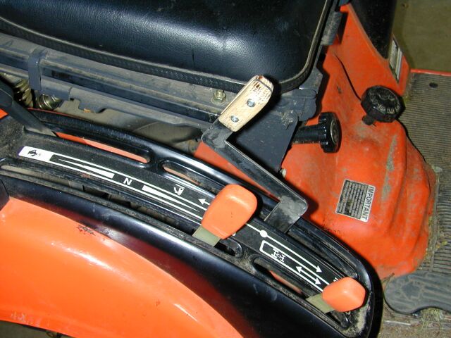

I figgered this was a prob unique to be but, my neighbor who bought a BX23 a month after I did was complaining about the same thing last weekend. Of course, I had to realize my solution before he got to it.
Problem: when keeping an eye on a scraper over my left shoulder, I ran out of arm to control the 3PH height (especially in the down position), resulting in extreme fatigue that I promptly treated with liberal amounts of homebrew which usually resulted in a shorter day than planned.
Solution: Rebuild the 3PH control lever.
Detail: The main connection to the tractor hardware is 3/16 x 1 bar bent using a torch and the angle was set by eyeballing comparison with the factory lever. The top portion is 1/8 x 3/4 bar angled to fit. All pieces are welded. The knob was cobbled out of junk oak moulding, shaped on a table saw and 1" belt sander. .. not a real big deal project but sumpthin I needed to git done.
Yes!, I know it needs painting.
Cheers!

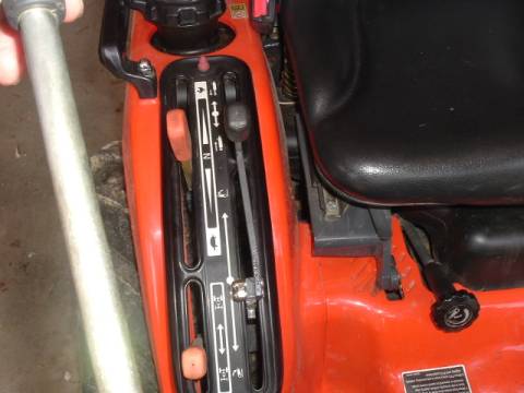

Wait til you are using a post hole digger and you are doing the lean left/lean right, grab the handles dance!
Great mod.
I think it's stupid the PTO and 3PH controls aren't on the same side. My temporary solution is to place the PHD, dismount, and have son control the 3PH from the right side while I control the pto from the left. We can both see it better also!
Got any mods planned to fix this one for me?
Thanks.
Ron

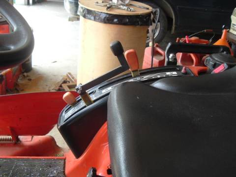

I wanted to leave the original lever so I could go back if I ever decided to. I drilled the lever and used two 1/4" bolts and acorn nuts.
