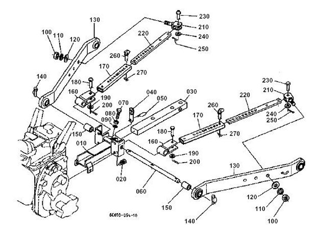

Here's a link to a thread about the change over, but on the BX, you only need two parts for each side. http://www.tractorbynet.com/forums/kubota-owning-operating/49403-b7610-3pt-stabalizer-replacement.html
In the attached pic, you need to get the parts # 160 and # 220, you will need two of each. I can look up some other posts and show you the modification that needs to be done to the part # 220 to make it hook to the lower lift arm.

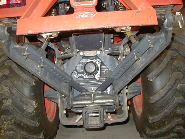

Here's also a pic of the completed install, notice the end of #220 that has the single hole has a slot cut in the side to enable it to attach to the ear on the lower lift arm.

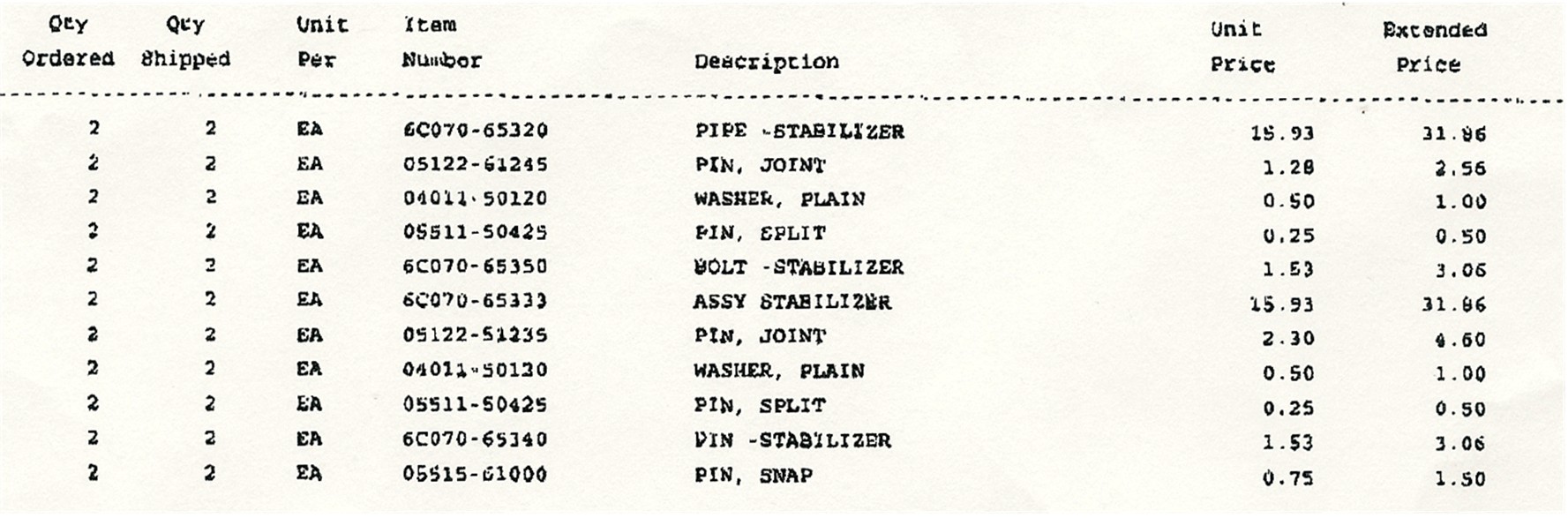

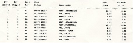

Here is the parts list that I used for my 3PH mod. Hope you can read the numbers. This prices are early 2003.
John

Did you find your parts yet, I didn't have the part numbers either, I printed out the pic and took it to my dealer and showed him the parts that I needed, they are for the B2910 so he looked the part #s up and ordered them. I screwed up on the # on the other post, should have been two of the # 220 and two of the # 170, I should have caught that earlier.:eek:
