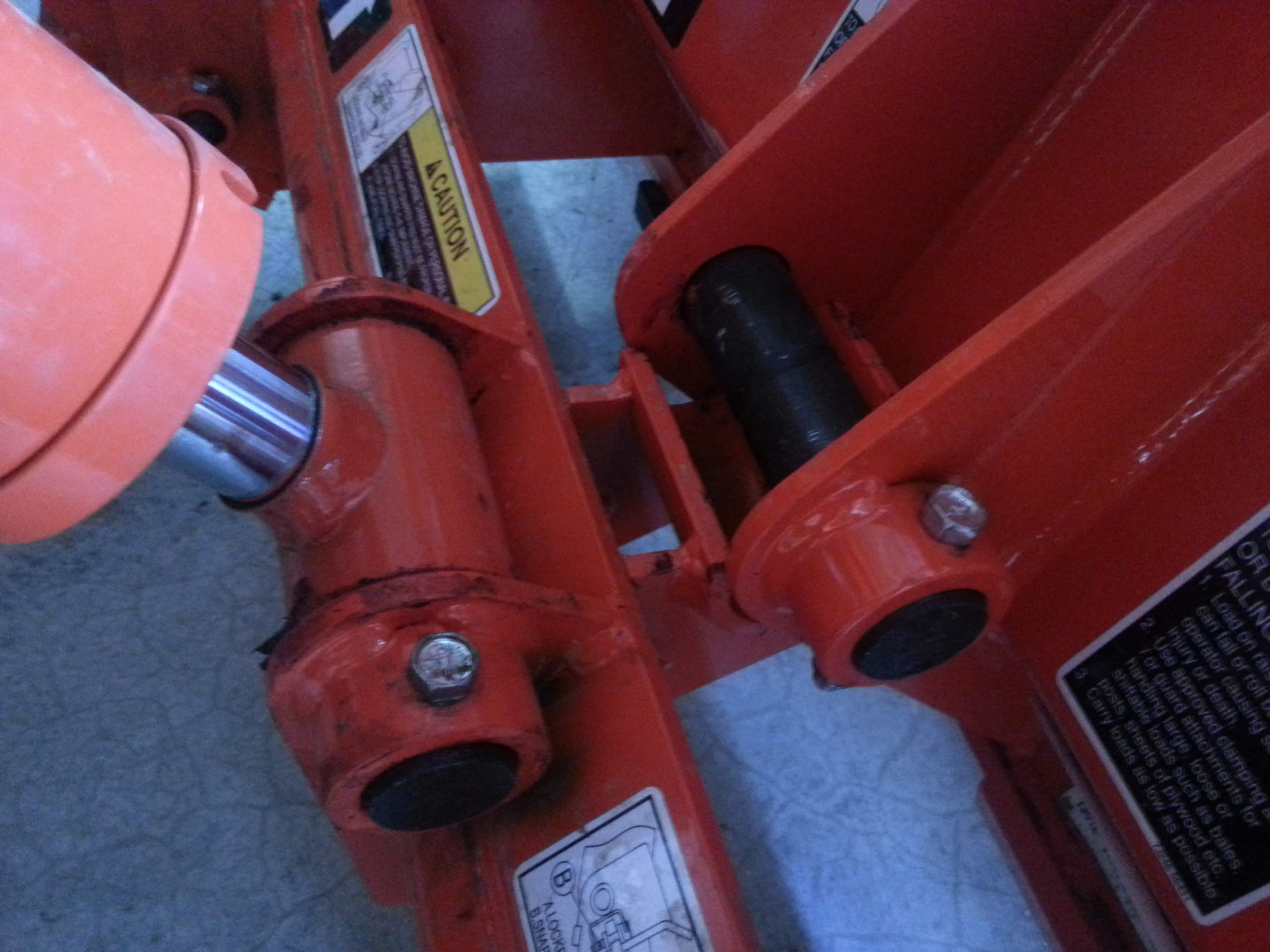

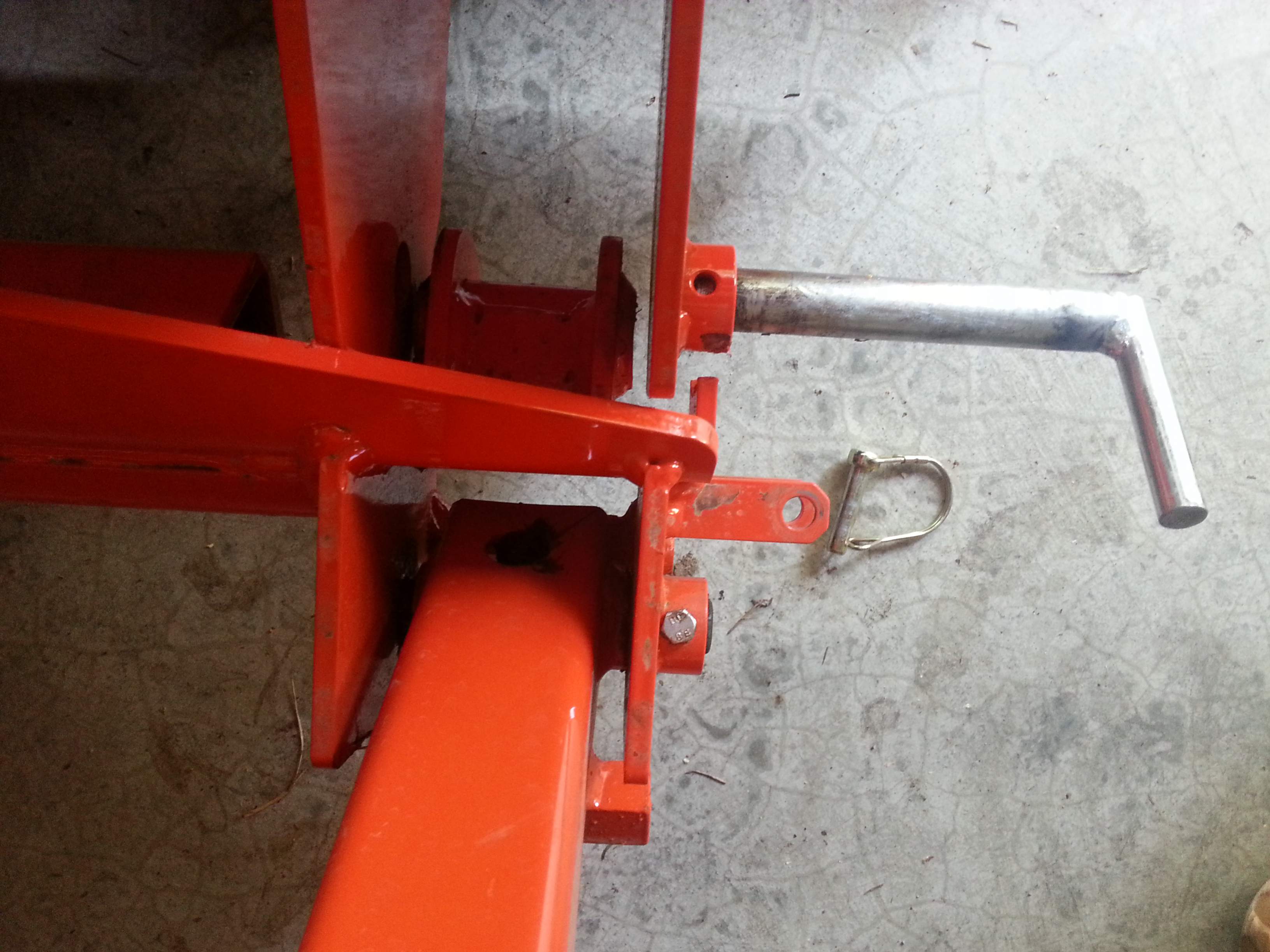

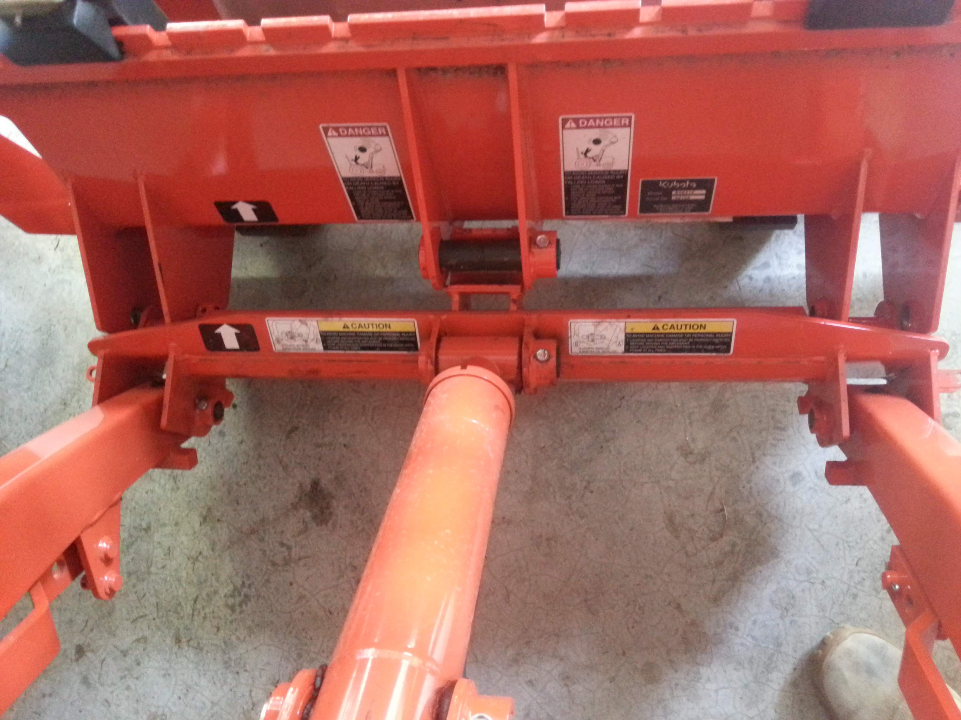

It's just a bracket that fits where the bucket would be, the pins from the bucket are actually used for the QA minus the center pin which is replaced on your bucket. Anything that's made to replace the bucket would work, it uses the standard pin spacing/location.
You drive up and roll the bucket back under the center pin, this lines up the two sides.
The two side's have quick pins, from the time your butt leaves the seat to the time your back in it could be 30 seconds for on or off but I have one sticky pin I need to figure out maybe remove some excess paint on the new adapter so it's taking me about 45 seconds.
Best part is I think in another week or so I'll have the wife trained to take the bucket off herself to mow.

Thanks for the detail pic's and descriptions. I stopped by another Kubota dealer today and got a quote of $1100 plus tax for the QA and forks (backplate and forks), so that's quite a bit better than my selling dealer. I decided to order just the QA for now since it would allow me to drop the bucket easier which will help when I need to store my BX25 in my shed with something on the 3PH. But, since it can work with any implement that has the same spacing as the bucket, I could opt for the Everything attachments forks at some point, or order the Kubota version. One thing the dealer couldn't tell me is what the weight of the Kubota forks is. I'd like to compare the weight to the Everythingattachments version to see which is lighter. The EA version uses 42" forks while the Kubota version is 32" so they must be lighter, but apparently, Kubota doesn't list the weight. Anyone know what the Kubota forks set up weighs?
Also, the dealer ordered the QA without deposit since I told him I'd really like to see it first, so if I don't like it, or change my mind, I'm not committed to it, yet.
