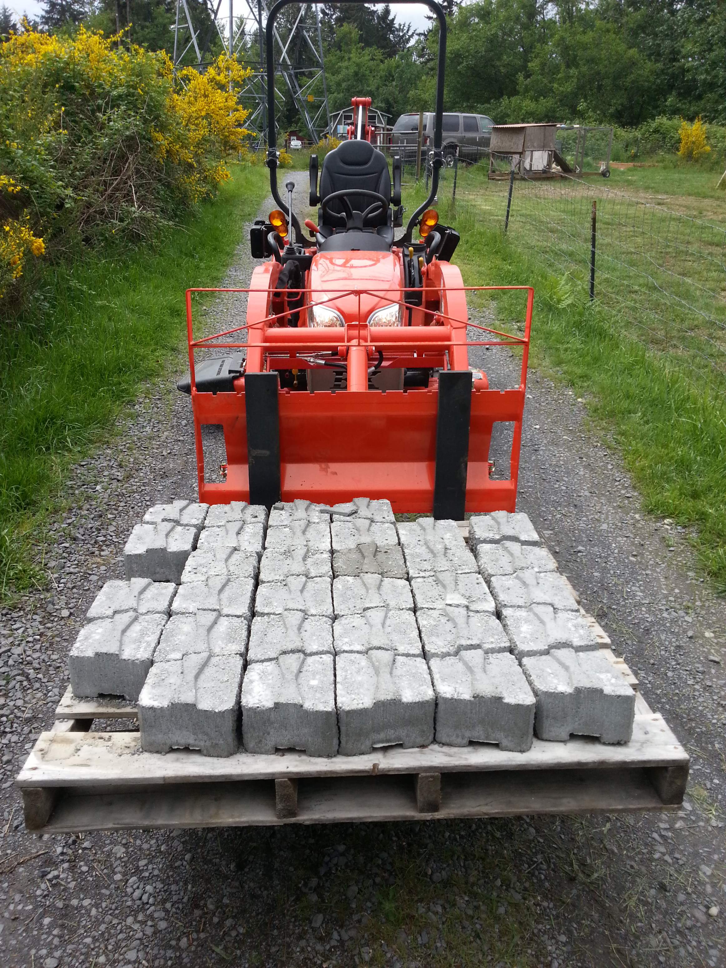

Had a chance to do a non-scientific study of this whole fork issue.
Results:
According to my bathroom scale these bricks weighed 15 pounds a pice, 30 bricks, 2600 rpm it didn't even feel it lifting or rolling (however my front turff tires didn't like it)
Here are 32 bricks on a standard pallet sense everyone seems concerned about 32" forks. It wouldn't lift this but it would roll not problem. Turf tires where on the rims. I'm totally convinced if I would have adjusted the load it would have lifted it just fine but the wieight was significantly "out there".
All in all I have no disapointments, I think if I had R4s on it I would have felt better about the loads but other than that I think it functioned well within what I expect from this/this size tractor.

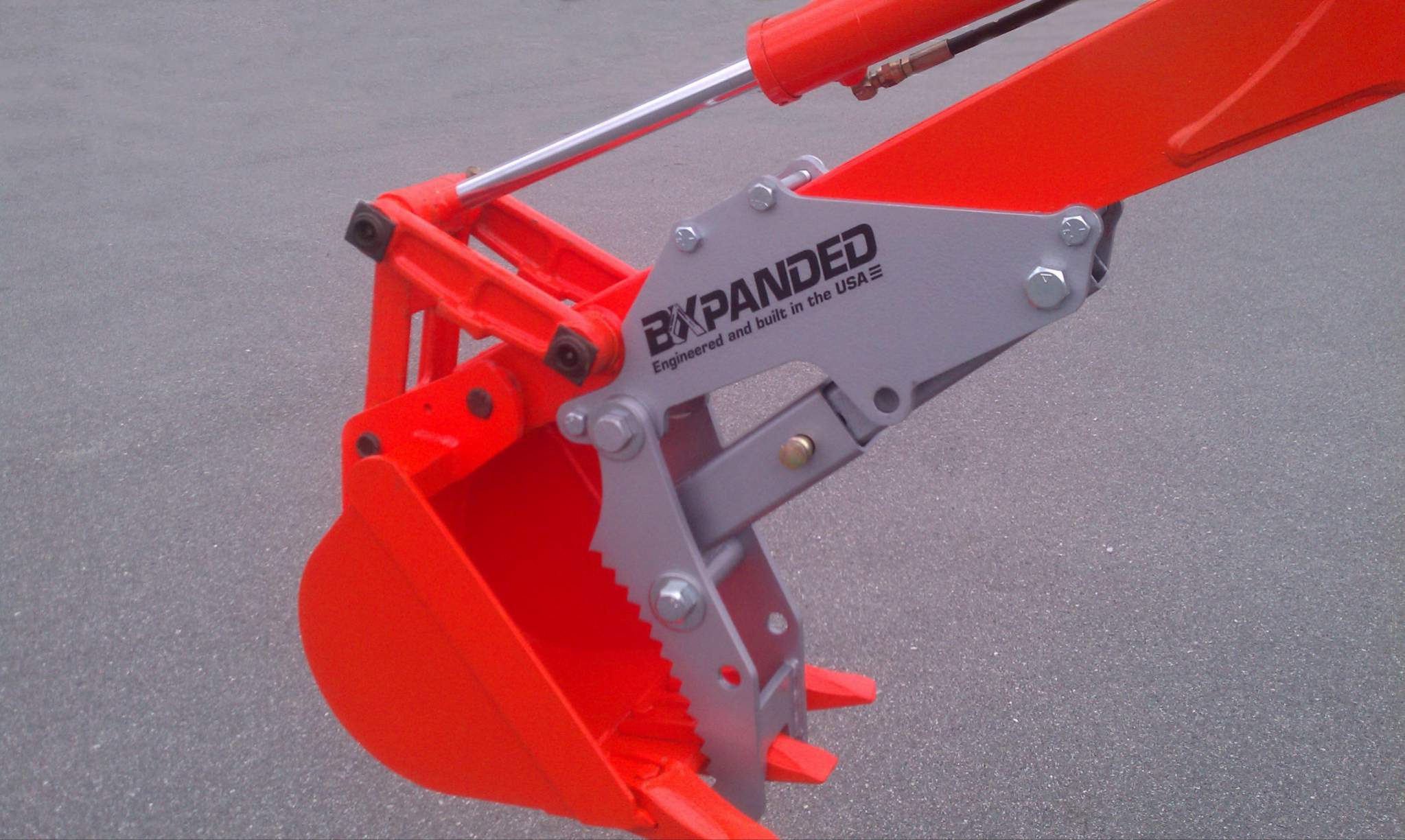

Check out the new BXpanded BARRACUDA BH thumb for the BX Series. Fits them all, including the BX25D. Like all of our other products, it's designed and built in-house, right here in the USA. You can see it here: Barracuda BH Thumb
Nice looking thumb. I like how it meshes with the backhoe teeth - better than my Bro-Tek version. Price looks attractive too. You should do well with those, except people with the new BX25D that opt for the factory thumb. Would be kind of a waste not to use the Kubota thumb mount that comes standard on the new BT602 backhoe. Good luck with sales of it.
