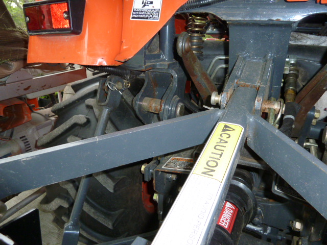

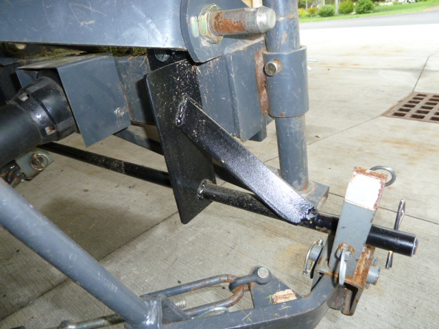

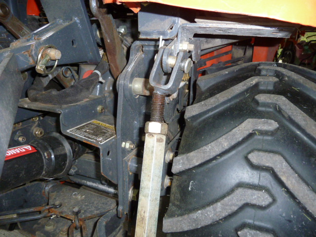

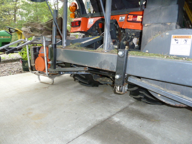

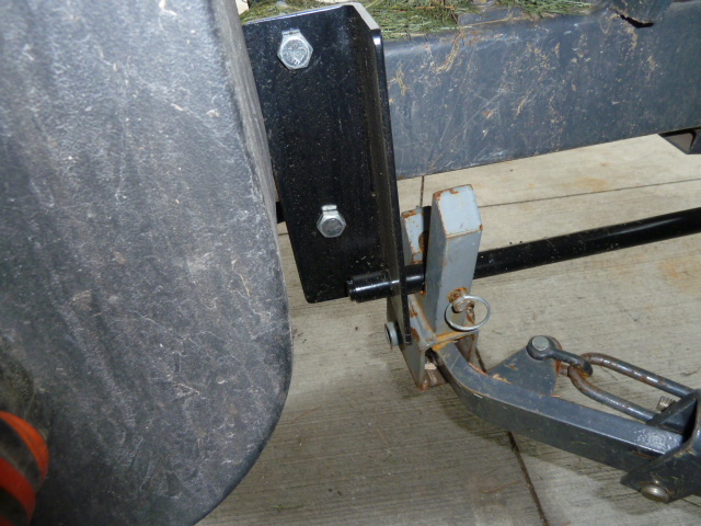

Mounting the deck should not be a problem, If you don稚 have a FEL mounted when you're looking to hang the deck then drive the front wheels up on blocks to get the deck under the BX. I always leave the FEL mounted till I'm done hanging the deck then I remove it.
I never turn the anti scalp wheels on the deck, I just hook on the deck w/a tie down or the chain I leave w/the machine (on the foot well) and pull the deck under the BX. I have a cement pad around the shop; I hear some of you have to deal w/a gravel area. I'd get a couple sheet of plywood to leave on the ground in an area were I kept the BX stuff. Once you've mounted and removed the deck a couple of times you'll get the hang of it.
The grass catcher is a ball buster, every thing ells that mounts to the 3 point hitch goes on no problem but removing the 3 point hitch and all that the factory has you doing is
poor design. I've modified my catcher this year. I'm always having to switch implements so the catcher was a pain. The photos show my modification. The pipe I used is a 1/2" gas pipe filled w/a 1/2" bar stock. Finding a piece of 5/8" solid stock wasn稚 happening so I used what was readily available to me. I simply pounded the solid bar stock into the gas pipe on each end about 12". Be sure the center top pin is lined up before you go welding anything up. I lined everything up then tack welded it before removing it and bench welding it all. All I do now is pick each end of the catcher up and lower it into the hitch coupling then role it forward and insert the top center pin. Hope this helps someone out.
