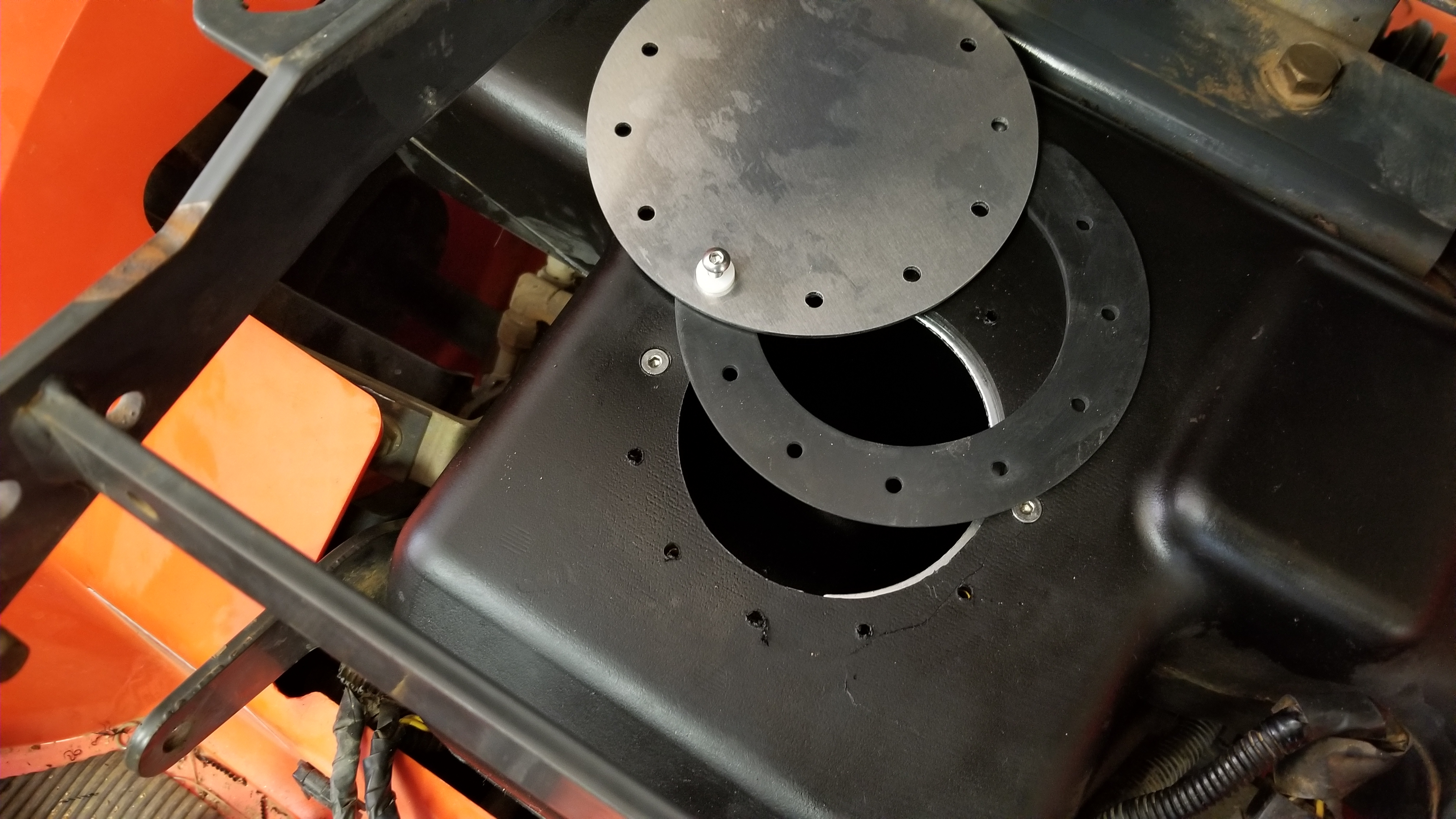

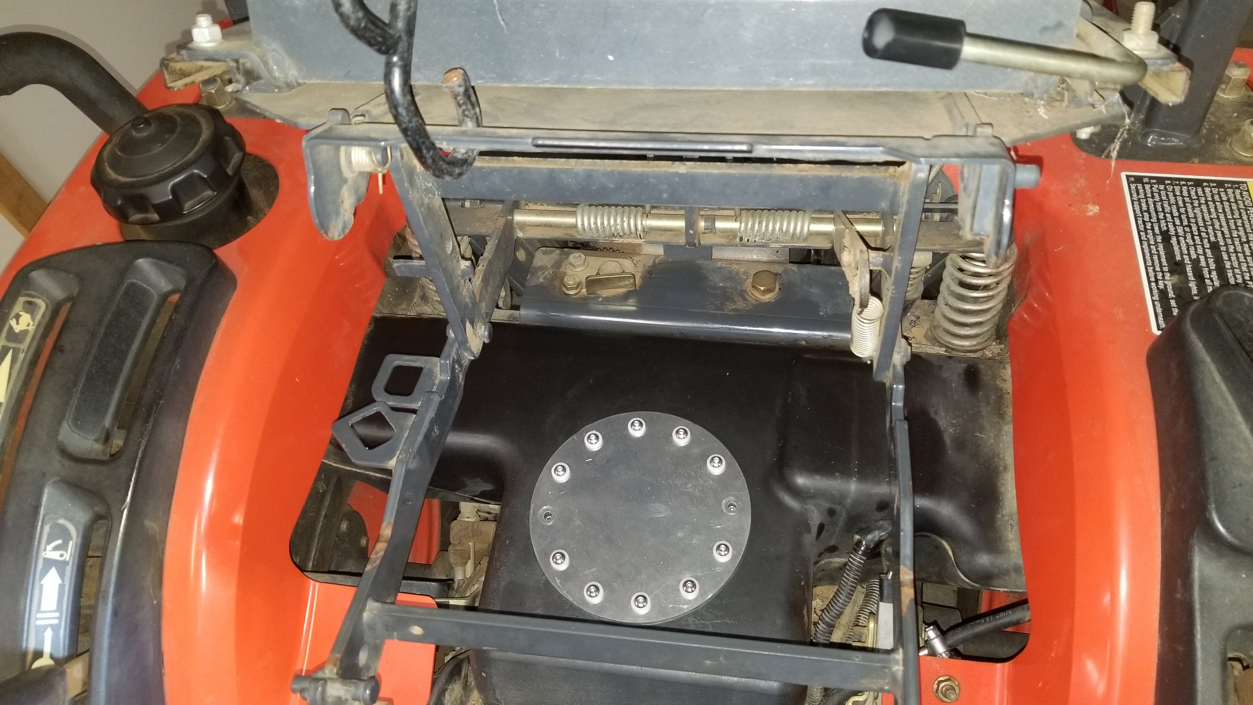

After multiple filter and fuel pump changes I expected to find material blocking the fuel outlet inside my tank but.... my tank was clean.
I think I have an occasionally collapsing or pinched fuel line (it's 15 years old) so the back half of tractor has to come off which I was trying to avoid.
The plate comes from "Boyd welding" in Florida for $38 plus shipping, SKU44033. I carefully redrilled the holes in the tank a little larger than suggested using metal plate as a template and it worked perfectly.
Hope this helps others, it's a great well made product

I posted this on OTT as well because this seemed to be a common problem with these tractors.
I could only find 2 other inspection plates both marine applications, one from Australia (and not available here) the other was too pricey.
As I said before, I found the tank clean AFTER I installed the inspection plate.
No back door approach.
I've gotten a lot of great information from these sites and wanted to share some info that's all.
