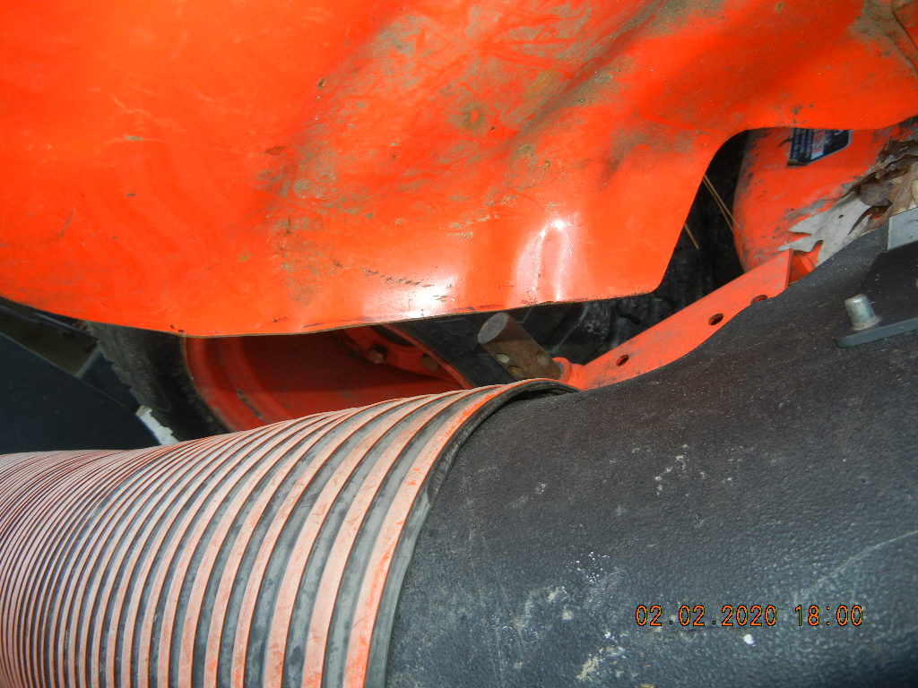

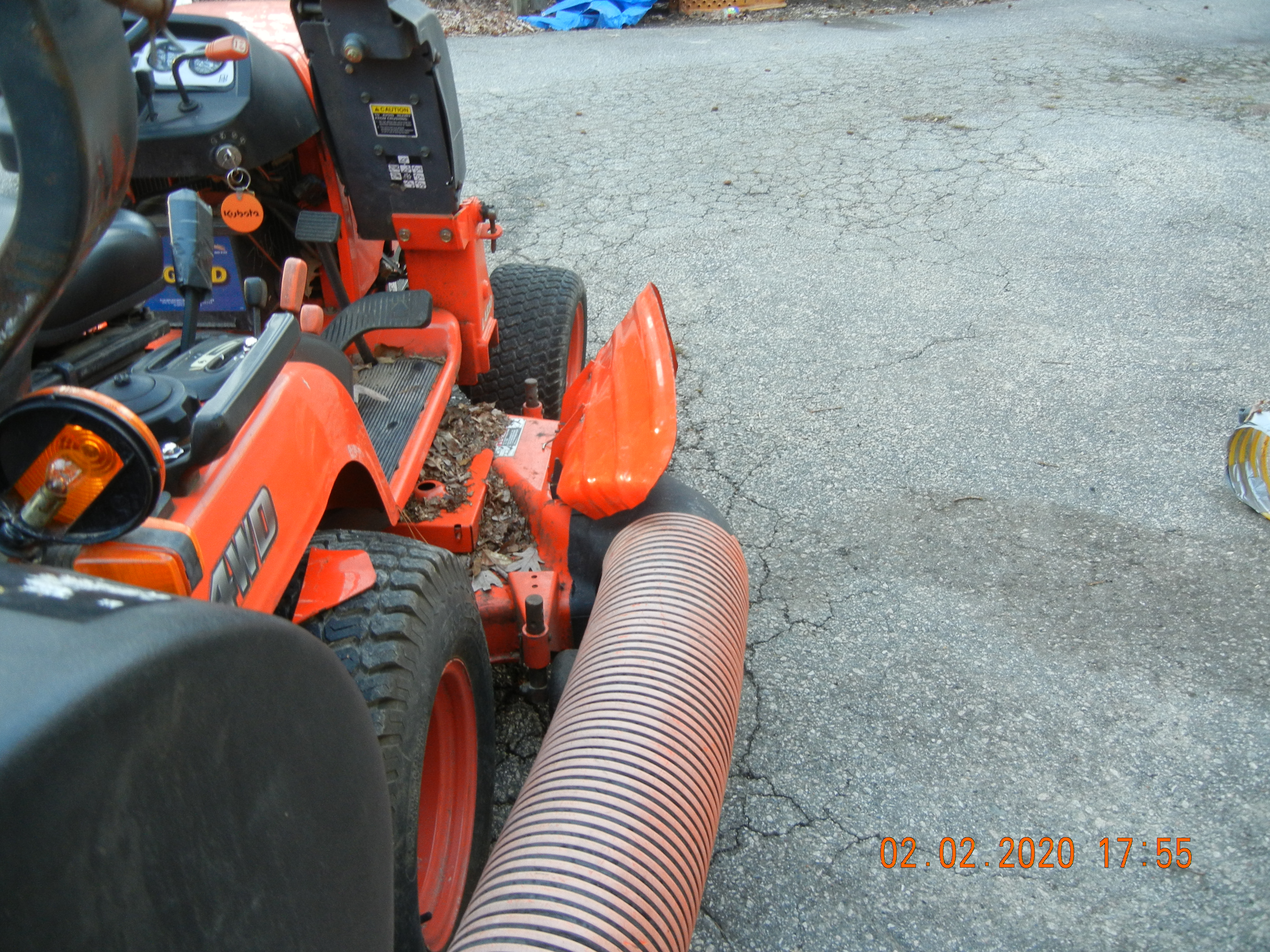

I discovered that the boot bracket was assembled incorrectly. It now resides between the two tabs coming off the portion of the bracket that is fixed to the plastic boot. Before, one ear was inside and the other on the outside. Anyway the thumbscrew holes now line up, so I am able to use the thumbscrew to secure the assembly in place. However the deflector still rests on the shoot. I guess it's as good as its going to get at this point.

Well - me again!
Had that warm day...
Turns out the flat bar goes in the front - exactly where grass escapes!
Odd bit does bolt to and support the plastic - without it closing becomes a 2 step process, not a bit cleaner than when attached.
With it - I can raise deflector (and boot) with my foot, release it and it goes right back to attached!

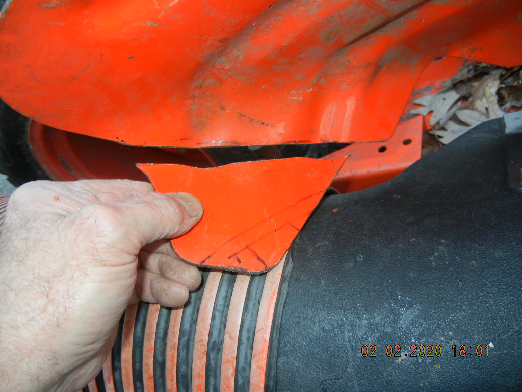

I did cut about 3 inches off deflector end, from resting on hose. Looked at various bends, etc and that last 3 inches was cleanest when just gone.
