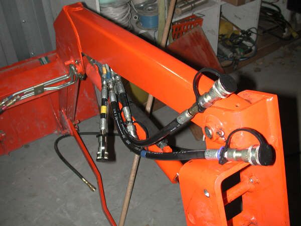

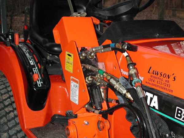

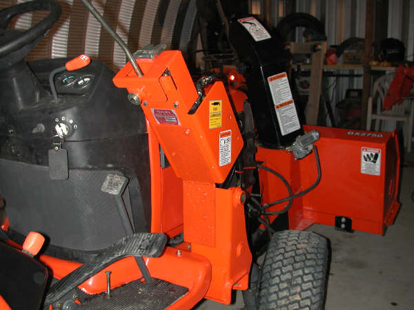

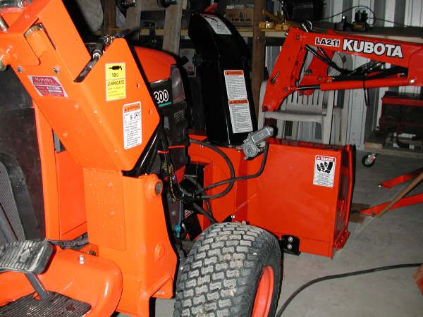

I have a BX2200 with the snowblower. This spring I ordered the FEL and gave the dealer the pictures and description of Woodstock's mod. My dealers saw that and made a similar mod before delivering the BX back to me. His choice was to cut off the upper part of the stand that the blower used for the valve and simply bolt it to the loader mounting bracket. Works like a champ and is a bit simpler than fabricating the plate and welding it on like Woodstock's. I'll post a picture shortly.
   / BX Hydraulic Valve Mod #14
Miki,
I hope Woodstock doesn't mind, but I downloaded them last winter and can re-upload them now. Here's the first one.
