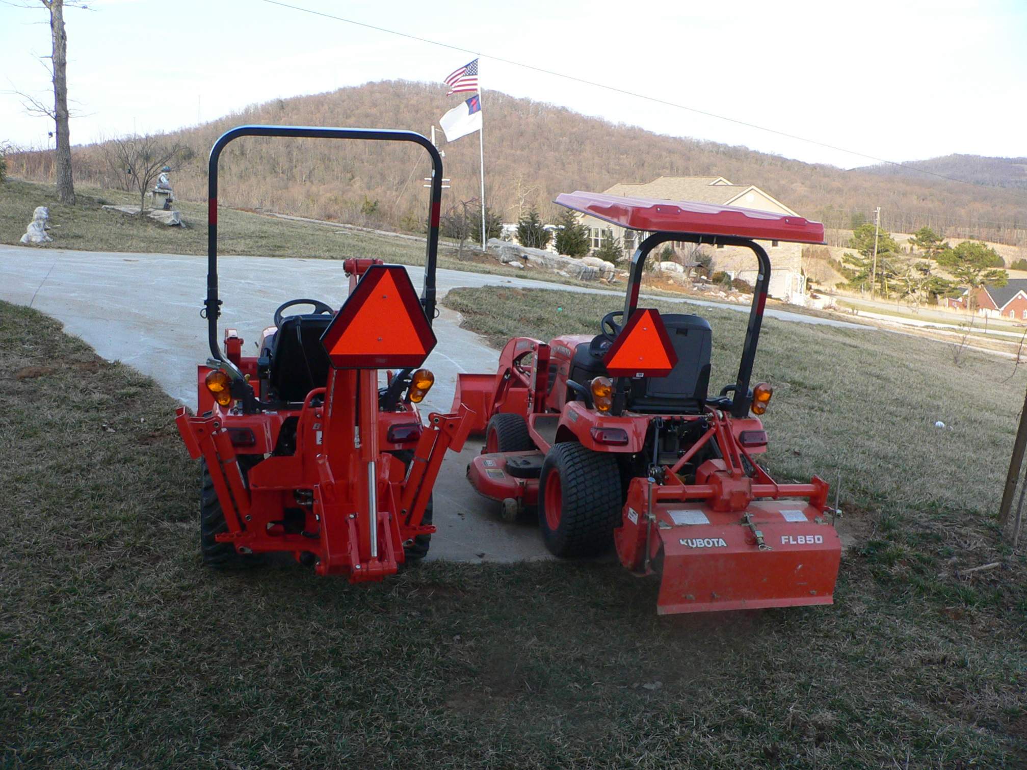

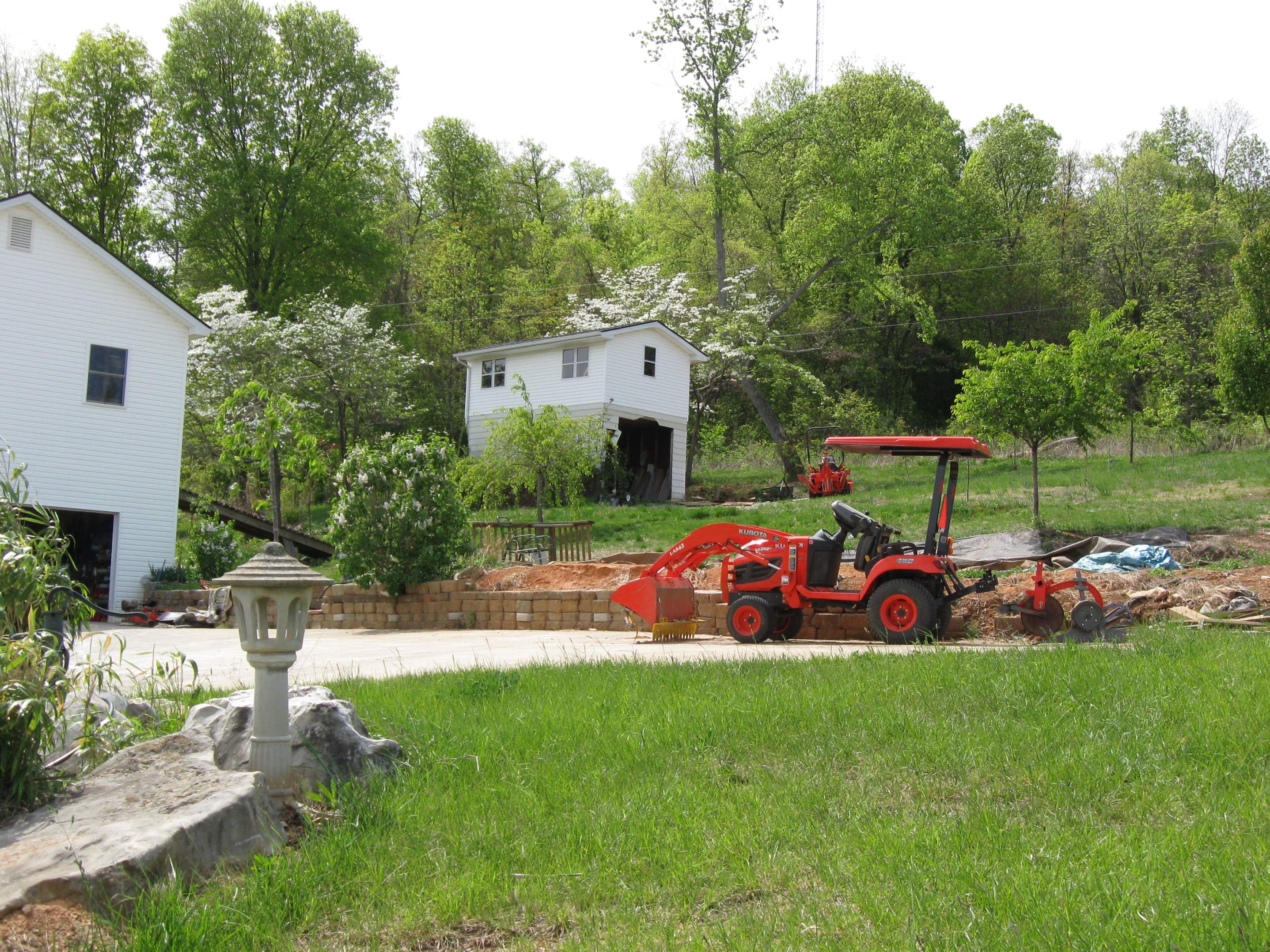

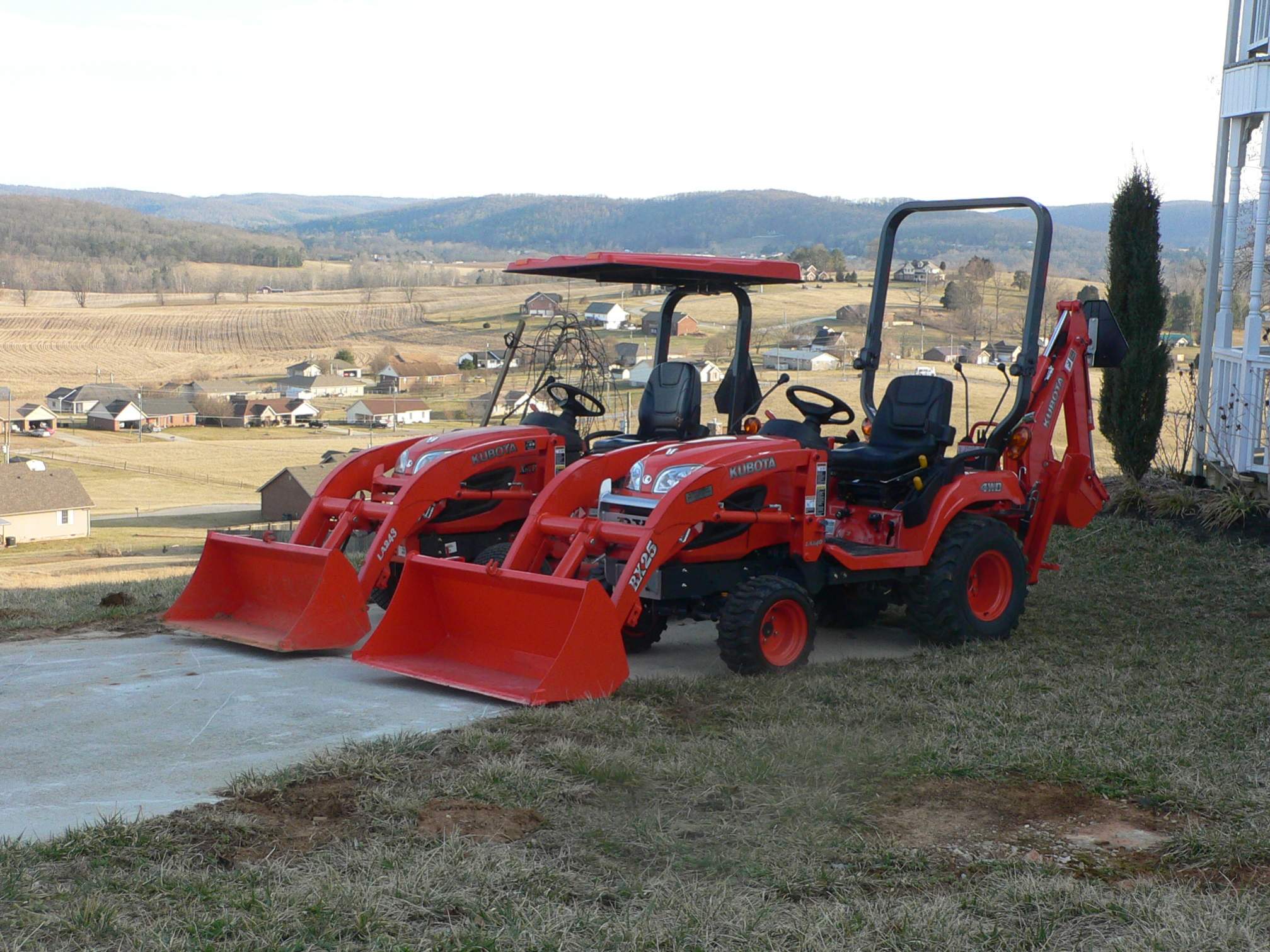

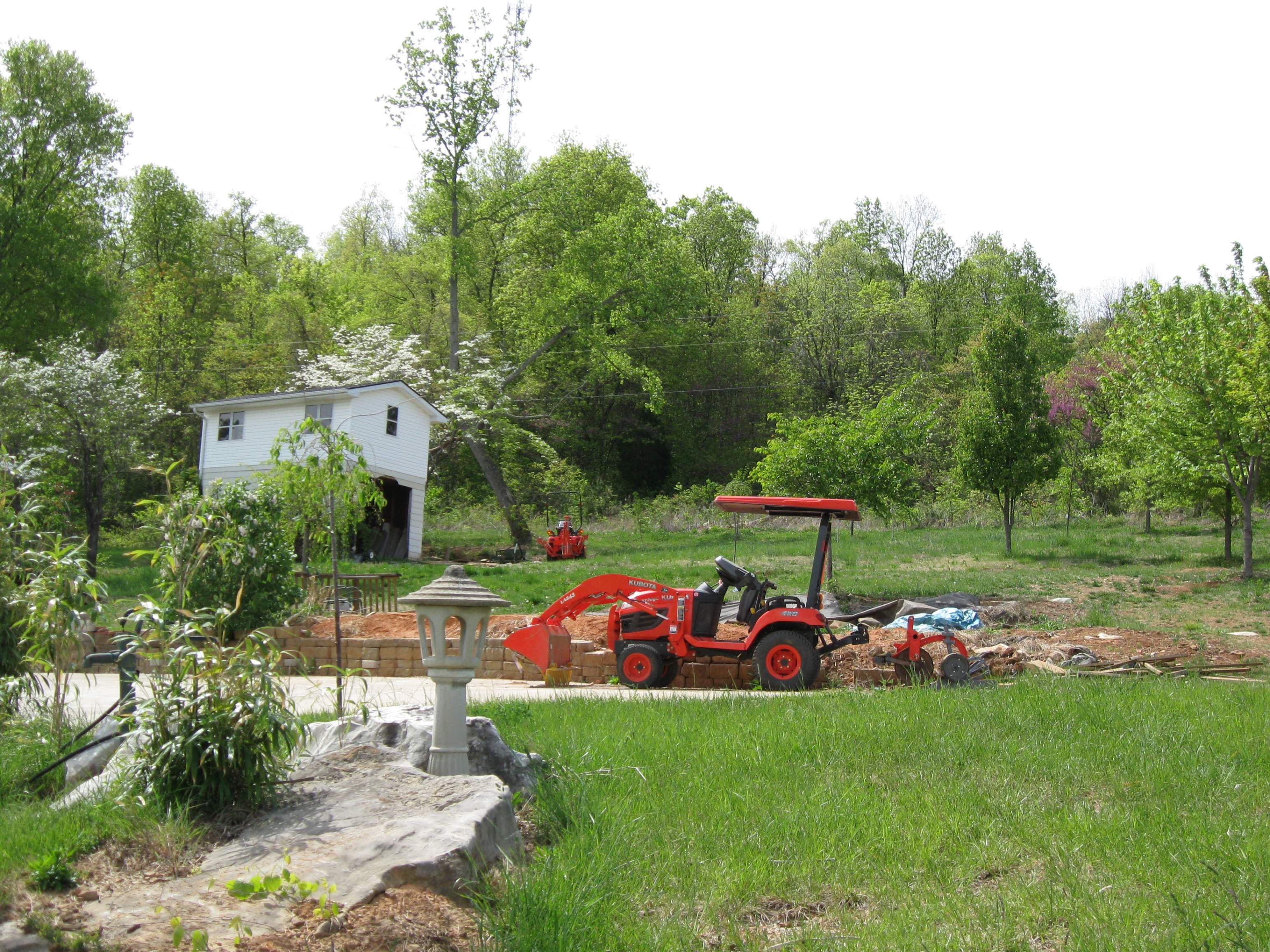

Actually the BX25 will be moved to my rental property.
