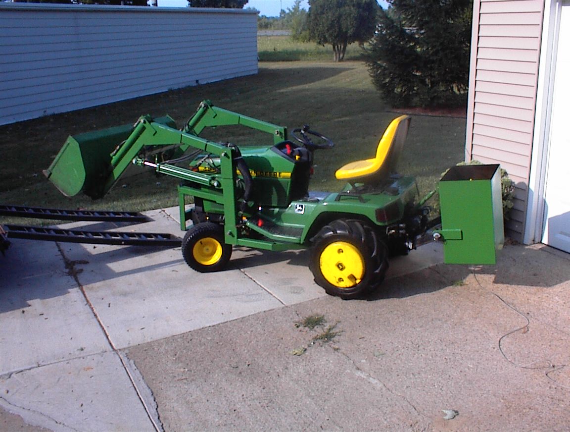

I just wanted to let you guys know about a real cheap and easy way to add counter weight to the back of tractors. I built a box out of 3/16" metal which is 20"x14" by 24 inches tall. Mounted the nessesary brackets for my three point hitch, and then added the cheapest weight you can buy. 80Lb concrete bags that sell for around $2.75 - $3.50 a bag.
I left the concrete in the bags so that I could take them out later if I ever need to. Just for your information regarding ballast for front-end loaders. JD recommends 650Lbs. of ballast behind my JD425. Of this 650, 250Lbs. needs to be on the rear axle (wheel weight and tire ballast, ie. pump your own windshield washer solvent) and the rest on the three point hitch.
The box weighs in at 100Lbs. and then I added 4 bags of concrete for a total of 420Lbs. just on the three point hitch, plus the 250Lbs. on the axle. I use my loader just about every weekend and I can't image not having the ballast on the rear.

What are you gonna do 6 months down the road when moisture had time to do it's thing with those concrete bags... /w3tcompact/icons/wink.gif
Excellent job on your "homebrew"?... You should consider selling them... very sharp looking unit... /w3tcompact/icons/smile.gif
