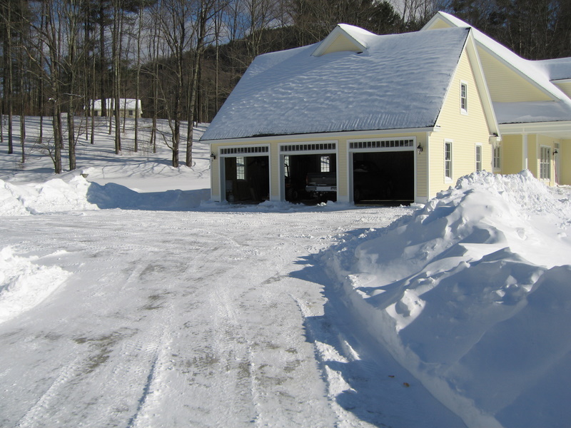

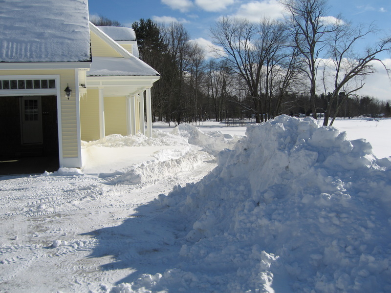

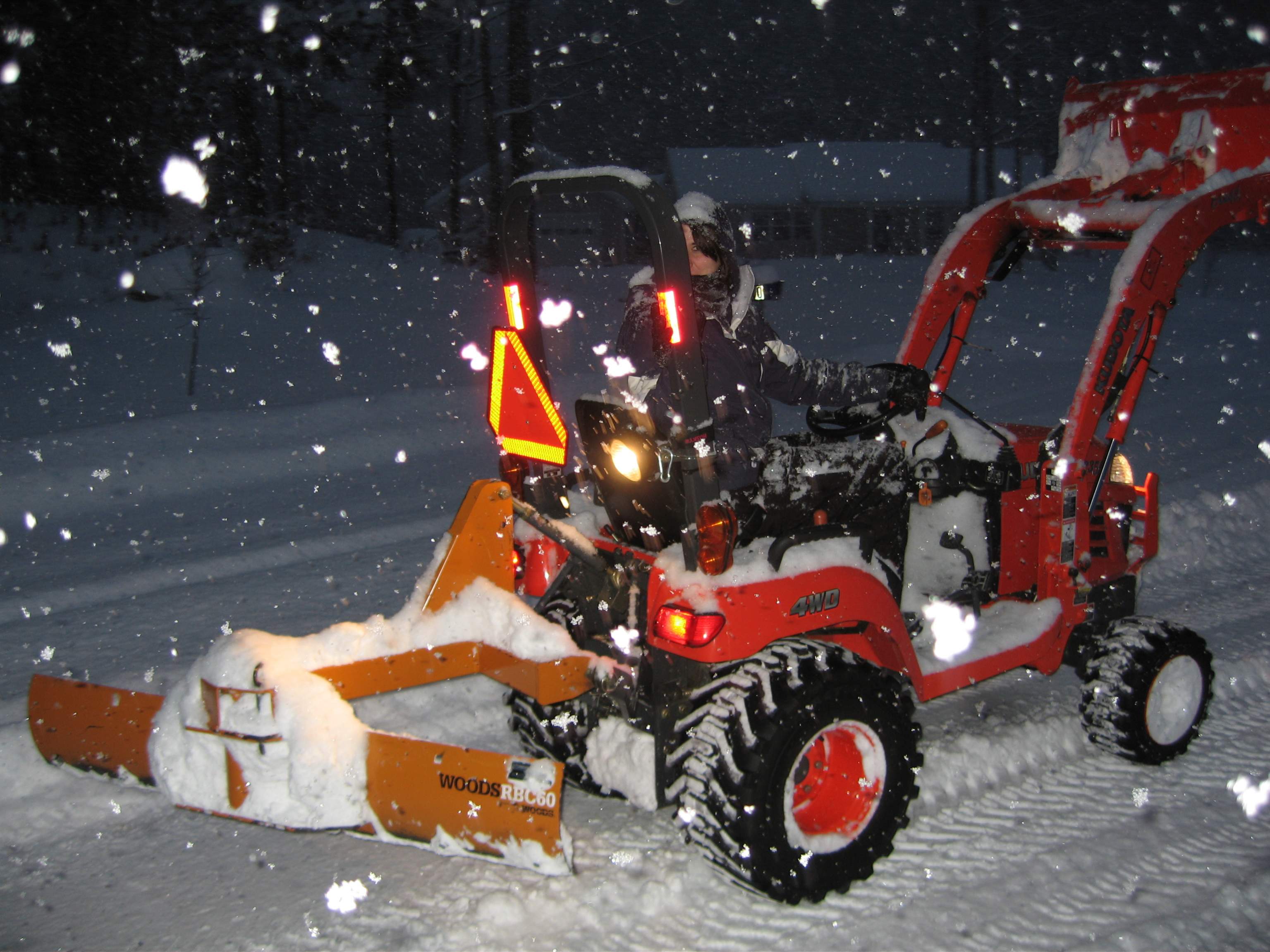

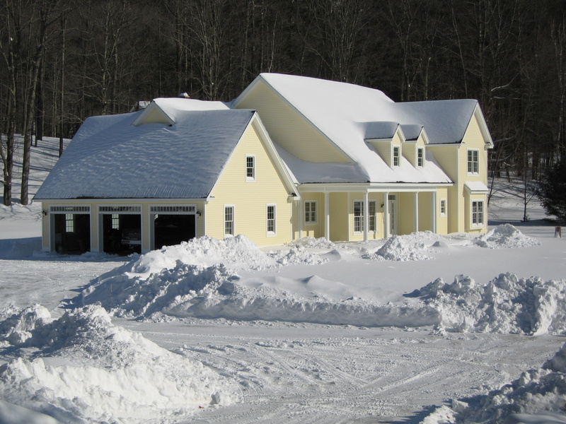

A loader is fine for big snows and moving banks. A back blade is cheap and will do most snows easier because of the angle feature. If you're driveway isn't huge, it may be all you ever need. I did 3 driveways and a half mile road with mine and it was fine up to about 10 inches of snow. The biggest problem is that the banks get too high to throw the snow over. In your driveway you can use your loader to pile them up which means you don't have to plow way back in the beginning of the season to make room. I don't plow more than 2 feet past the driveway edges and use the loader if I need more room. It's a little tractor but is capable of doing some big jobs. We've had some big storms,but I've never "needed" a bigger tractor. Might have been quicker, but the BX will do more than you might expect for the size. It'll be a pleasant suprise to buy something that does better than you expect!
