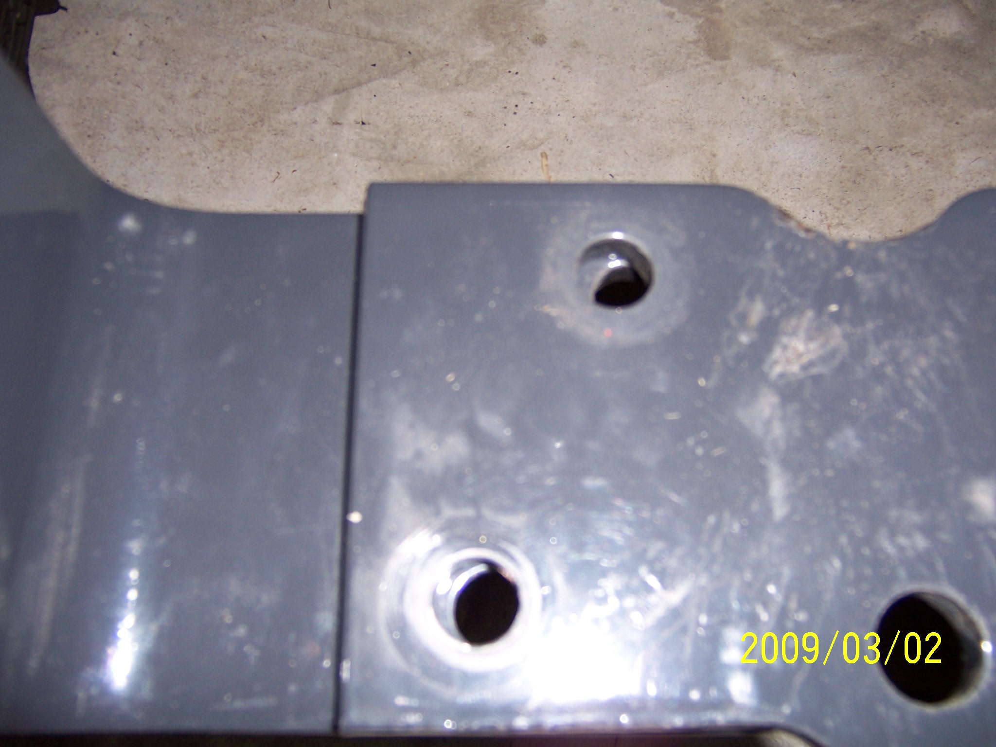

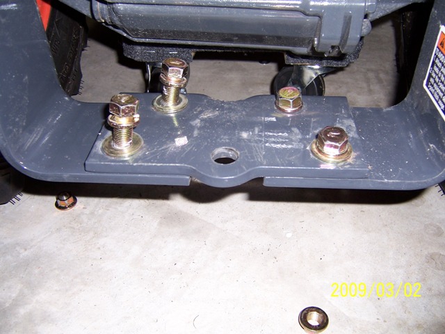

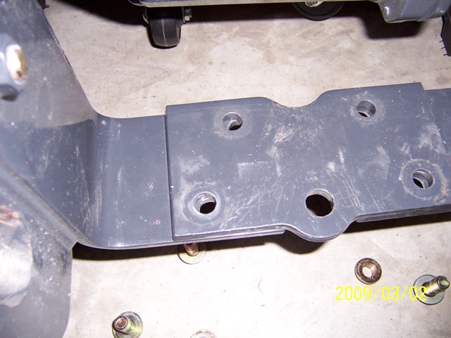

I was trying to install my Bro-Tek skidplate this weekend and ran into a hiccup. I removed the two bolts on the drawbar and when doing so the frame portion has shifted to the point that the holes no longer line up with the drawbar plate and the frame in one spot. I wouldn't think that this was supposed to shift like that. Any ideas?

   / BX Rear Frame Alignment @ Drawbar Shifted During Bro-Tek Skidplate Install
Here are some pix of what I'm up against.

   / BX Rear Frame Alignment @ Drawbar Shifted During Bro-Tek Skidplate Install #6
Can you wedge a 2X4 between the els to spread the sides apart so the bolts line up?
   / BX Rear Frame Alignment @ Drawbar Shifted During Bro-Tek Skidplate Install #7
Will a small bottle jack fit between the side plates? You could use it to spread the sides while you put the bolts in.
   / BX Rear Frame Alignment @ Drawbar Shifted During Bro-Tek Skidplate Install #8
Very simple way of lining them up ,place a large tapered punch in the hole between the two pieces and pry one piece against the other, move it over enough to stick a bolt in one of the other holes. Once you get two bolts in the rest will line up. The longer the punch the better the leverage.
   / BX Rear Frame Alignment @ Drawbar Shifted During Bro-Tek Skidplate Install #9
Use a tappered pry bar. Place it in one hole and move it so that one of the other holes line up. Place a bolt in the lined up hole. Don't tighten it up yet. Move bar to another hole and repeat. You should be able to get everything lined up that way. Leave one hole open and use the bar to line up everything as you get it tightened up.
