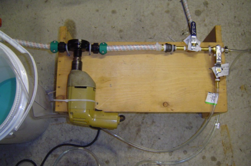

I finally tried it last night. I built a rig similar to what I have seen posted here. I filled the rear tires on my garden tractor 23x10.5x12. They took about 7 gal each, and should add 49 lbs to each tire. In addition to the wheel weights (and chains for the winter) this should work out good. I am also thinking about filling the front tires on the Wheelhorse. Even with the mower deck on and in the grass you can get the front wheels up if you are quick with the clutch. With the mower off I could use a set of wheel-ee bars!
Attached is a pic of my make-shift filling rig. The old drill and the small wooden platform were salvaged from the junk that was left at my house by the previous owner. Filled Roll-Off dumpster before I moved in.
The BX is next.
