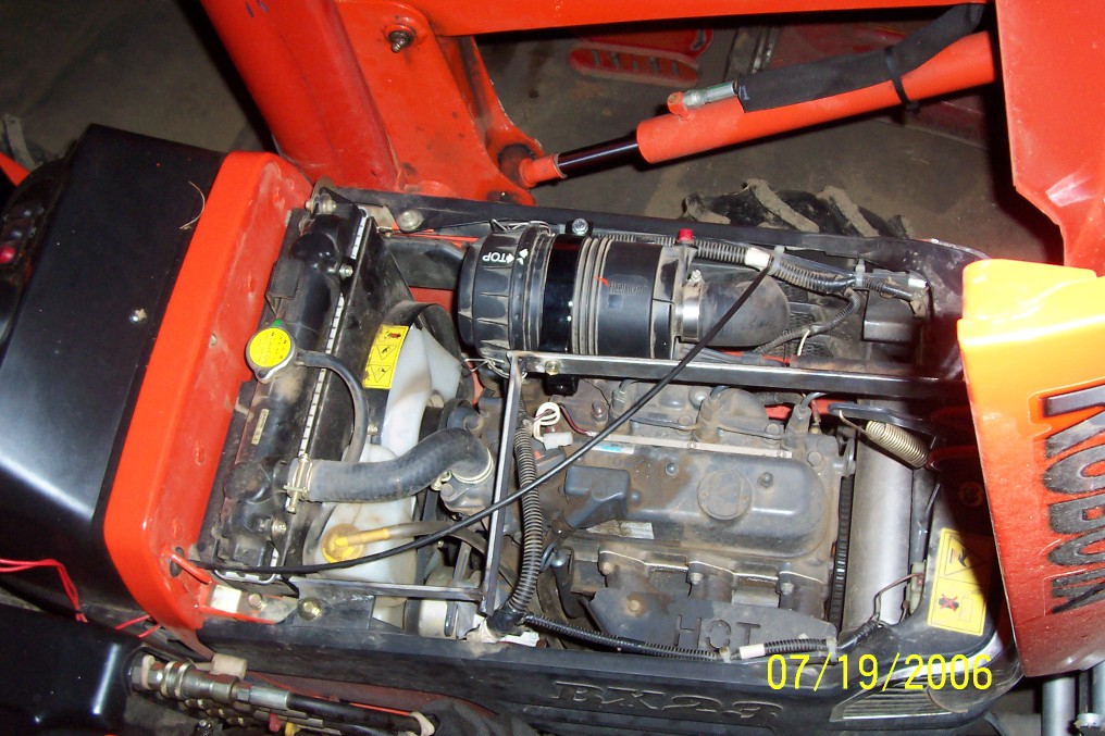

Are you sick and tired od replacing the air filter brackett on your 22,23,etc .I was,and tired of the hassle.I have a close friend who works on tractors and heavy equipment.He said where its only a 3 cylinder,it does idle a little rough[vibrate] which is normal.He said what i need to do is get the brackett off the motor,and mount it to the tractor itself.Well i took the bottom bracketts right off the motor,then turned the strap holder sideways.I bought some 1.5 inch bar stock,and fired up the welder.I took the bolt out left of the hood hinge.this is straight on to the filter assembly.then i welded a peice across and ,then back to a bolt location that holds the right side cover on.I drilled a hole and mountedthe strap to this,drilled holes ,and bolted it in solid.By going across to the other side of the tractor ,i can still easily remove the filter.Even with the tractor idling there is no vibration on the filter holder.Well a pic is worth a thousand words.I thought one of you told me the new 24 is redesigned ,so the filter holder isnt on the motor,well you can convert yours easily to,SINCE KUBOTA WONT STEP UP TO THE PLATE FOR US.

Good Idea.
But I have something to think about. Maybe it's not an issue
The motor still shakes around so the part that will be getting stressed is the tube from the filter to the intake. If this part gets cracked it might allow unfiltered air into the engine. Maybe not but you might keep an eye on the tube/hose for a while. Even rubber can develope stress cracks if stressed enough.

Nice mod. The new BX's mount their airfilters to the frame on the radiator bracket now. Thats one of the 1st mechanical changes I noted when I 1st saw the new BX's....

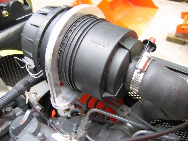

Howdy all new to the board,
Here is the the bracket that I machined out of aluminum for my bx2200 since the factory bracket broke Aftert 12 hrs and I had no luck reparing it.
I've been using this mount for over 200hrs without a prob whatsoever.
That's beautiful! When mine broke I took it to the dealer (for the 50hr service) and he replaced it with a new one. However, the mechanic also made some sort of modification to the mounting point. I've never taken it apart to see what he did but it's worked fine ever since.
