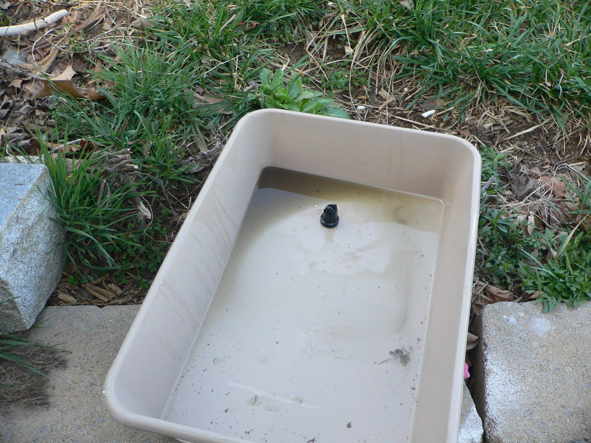

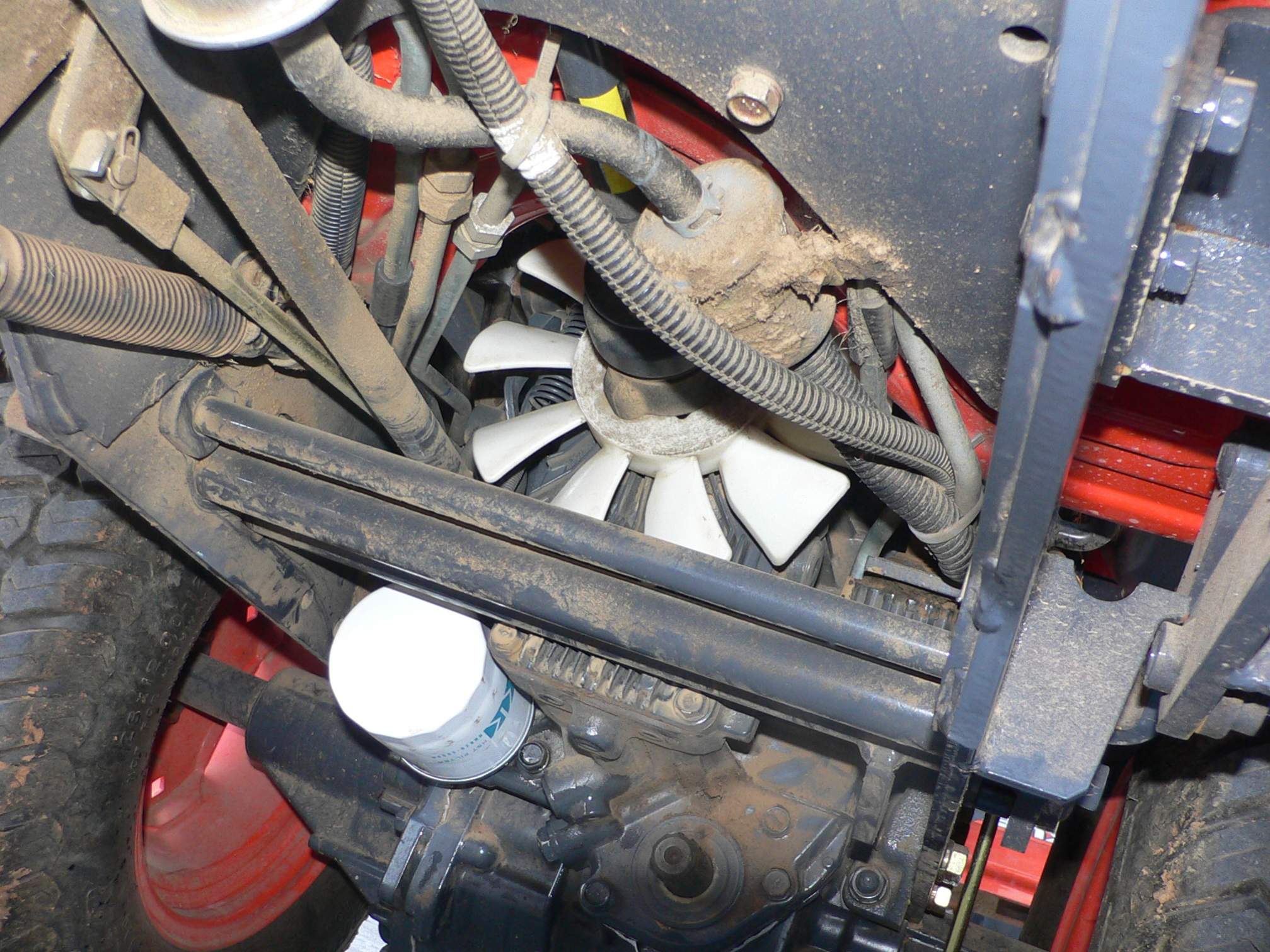

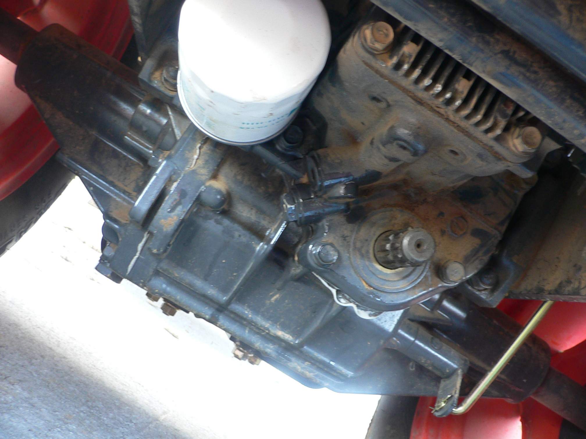

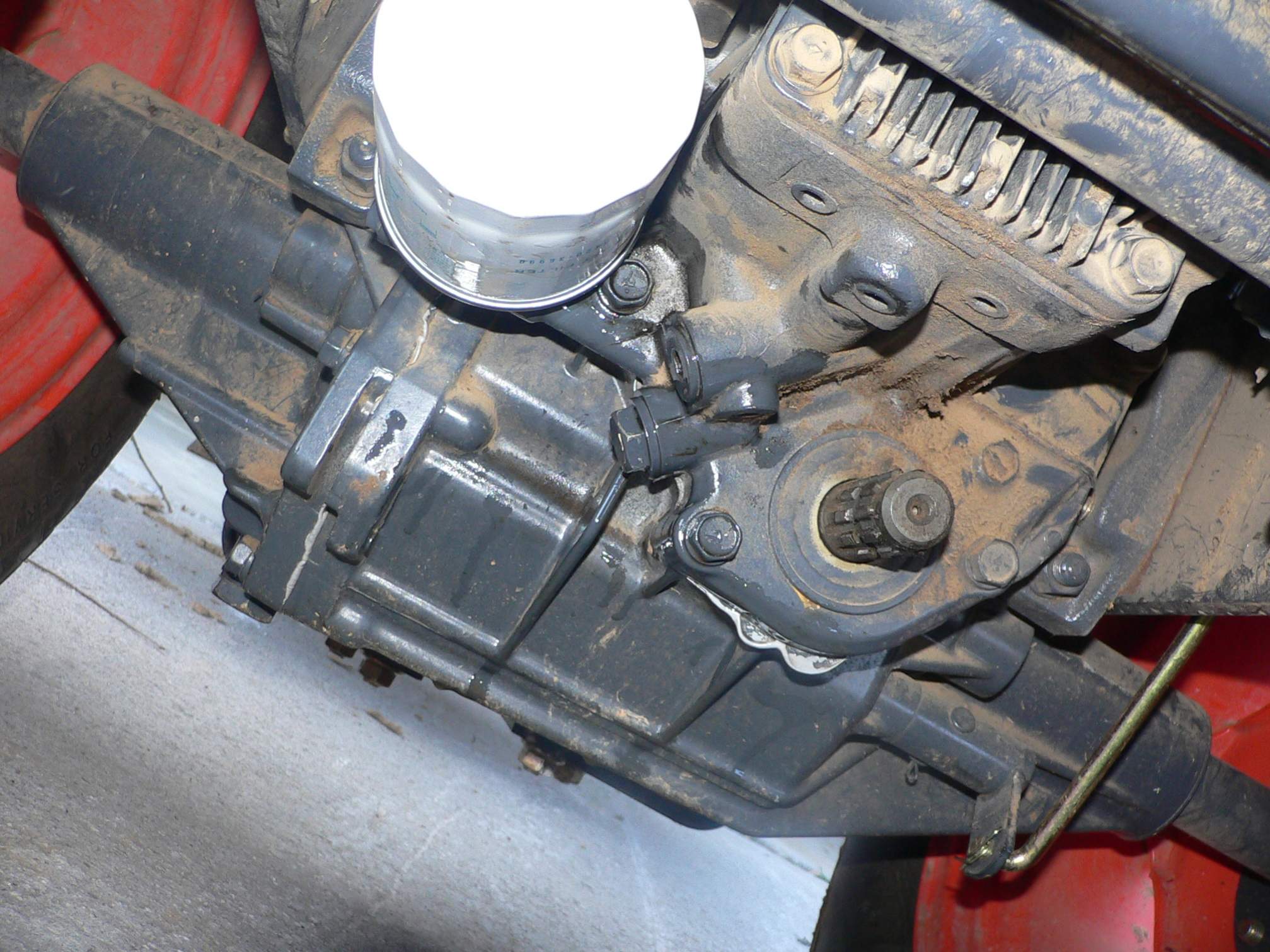

Jobs done. Removed the bolt for screen three times and couldn't get screen out, kept coming back thinking I'm not going to give up on this. Stuck my little finger in hole and also tried to pop it out with a small tipped srewdriver. Had cork ready. Here is how much ran out including the little that came out with filter. If I had gotten the screen out then maybe more would have came out.

Seriously. Hmmmm. They can be that way. I found that as i rotated it with channel locks and worked it loose, and continued to rotate, it eventually was coaxed to come out. You must have pretty good paint seal or that O ring is sure holding tight. No worries. You can check that screen anytime. I would bet a dollar to a donut that it is clean as a whistle anyhow.

I would try to get that out of there as soon as you can. Mine was a mess at 50hrs, perfectly clean at 100.

johnthomas, looks like u at the wrong hole its over behind the left rear wheel...if you remove the rear wheel its a lot easier to pull out the strainer the first time

This is a BX2660. I had my finger in it and it is a strainer dead center in the picture with filter to it's left.

It goes out horizontally, toward the driver's side rear tire. Approach from the rear of the tractor.

John, I think the bolt you took off is where the pilot relief valve spring resides. As others have mentioned, the screen you are looking for is located in the back on the left hand side. I just looked at an old post of mine about the possible fix to the 50 series abrupt reverse "feature" and found my old picture that looks just like yours. This is the same bolt my salesman took out to shorten the pilot relief valve spring. Hope this helps.
