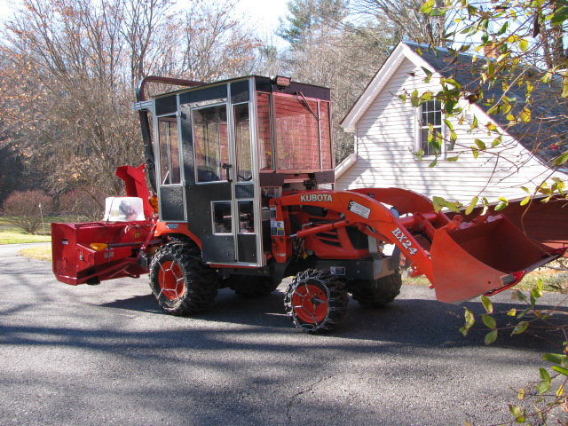

I was having someone plow and using a dodgy snow blower for paths and cleanup. The plowing resulted in damaged bushes and grass sod replanting each spring. Got an old PTO 54" snowblower off Craigs list and copied the projects from here to add a winch and linear actuator for 12V control. Seems like a good practical combo for a BX. A front snowblower would be big improvement but a bit pricey. Also the bucket comes in handy with the town plow's frozen bank and slush. The home made cab with heater gets put on just for the winter and is an indulgence.
