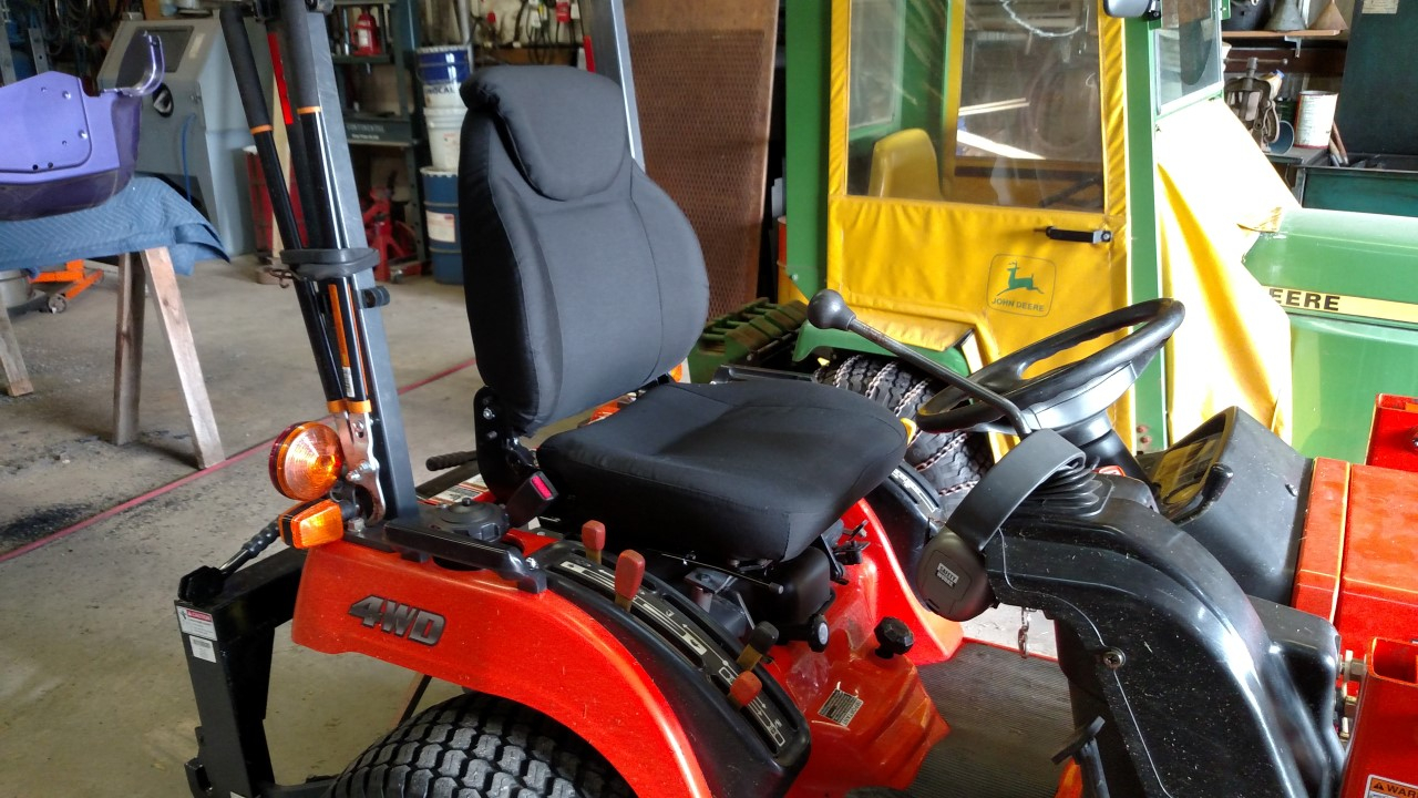

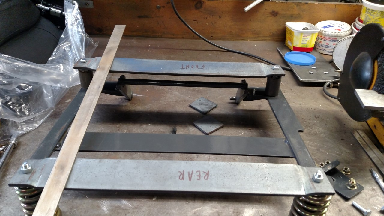

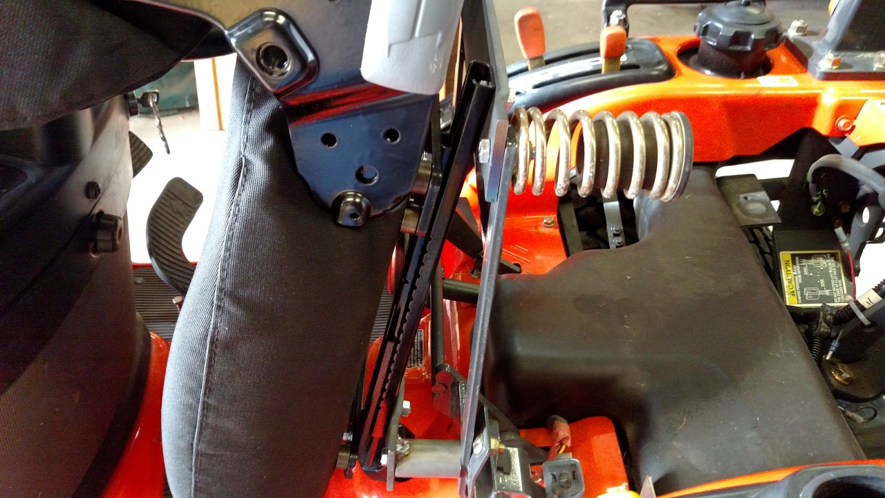

I hated to stock seat on my BX when I bought it. Shortly thereafter I found a good deal on a seat at Rural King, so I bought one. I had to make an adapter to fit the stock seat mount, but a little steel strap, tubing and welding was all it took make it fit.
OMG what a difference it made, cool in the summer and WAY more comfortable.

BX,
Thank you for the seat modification post. Done and done. Appreciate the additional photos and advice. I emulated your build on my BX. I do nothing but mow with it. I have a 7800 for attachment work, etc. and larger areas to mowing.

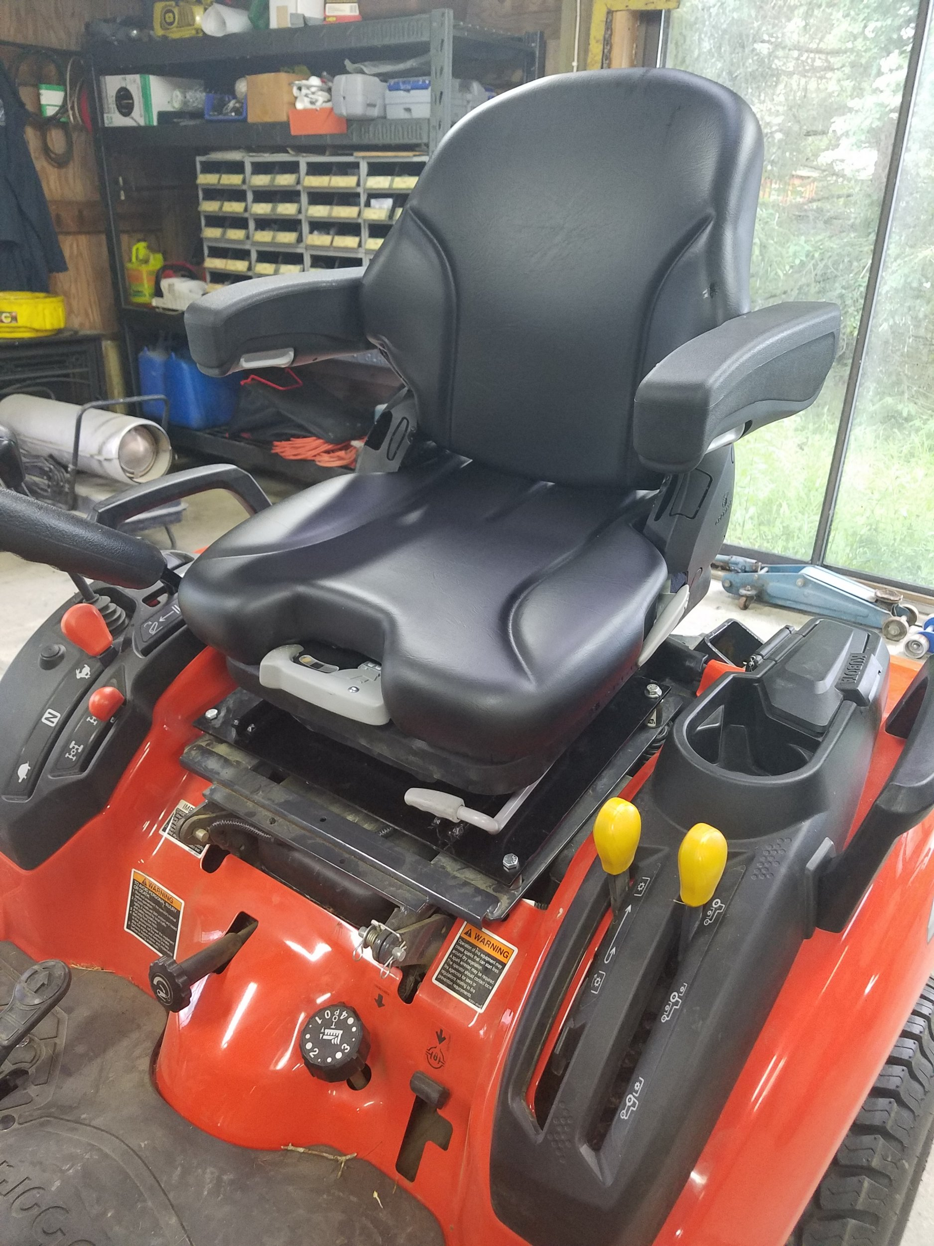

I also modified my BX seat. I have a 2015 BX25D and added isolation mounts that come on an Exmark zero turn and ordered a suspension mount from Amazon, welded up a bracket, using stock seat, works good except the suspension part has bent slightly and isn't quite as cushy as before.
I did lost the ability to twist it around for the backhoe but that system was a PITA anyways, now I just fold it down and sit on the back.
My thread: Added a Suspension Seat to my BX
