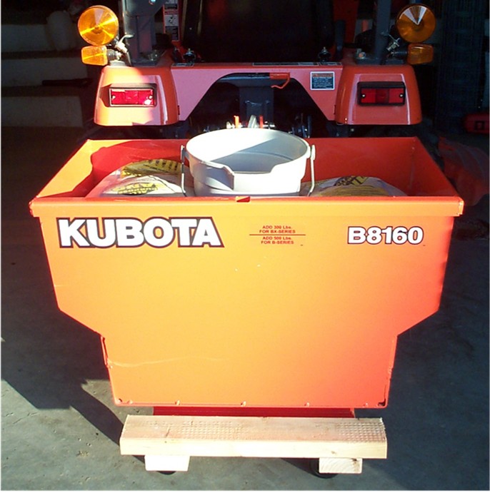

Copperhead
I also live on one of those western PA hillsides. On several occasions I have lost rear wheel traction with the bucket loaded, headed down hill and 2WD. It is scarey to say the least and your brakes have no effect. The only way to stop is to drop the bucket. Ballast helps along with my 230 pound rear in the seat but it can still break free. 4WD is the best bet in this situation. I have never lost traction while in 4WD.
JOhn
